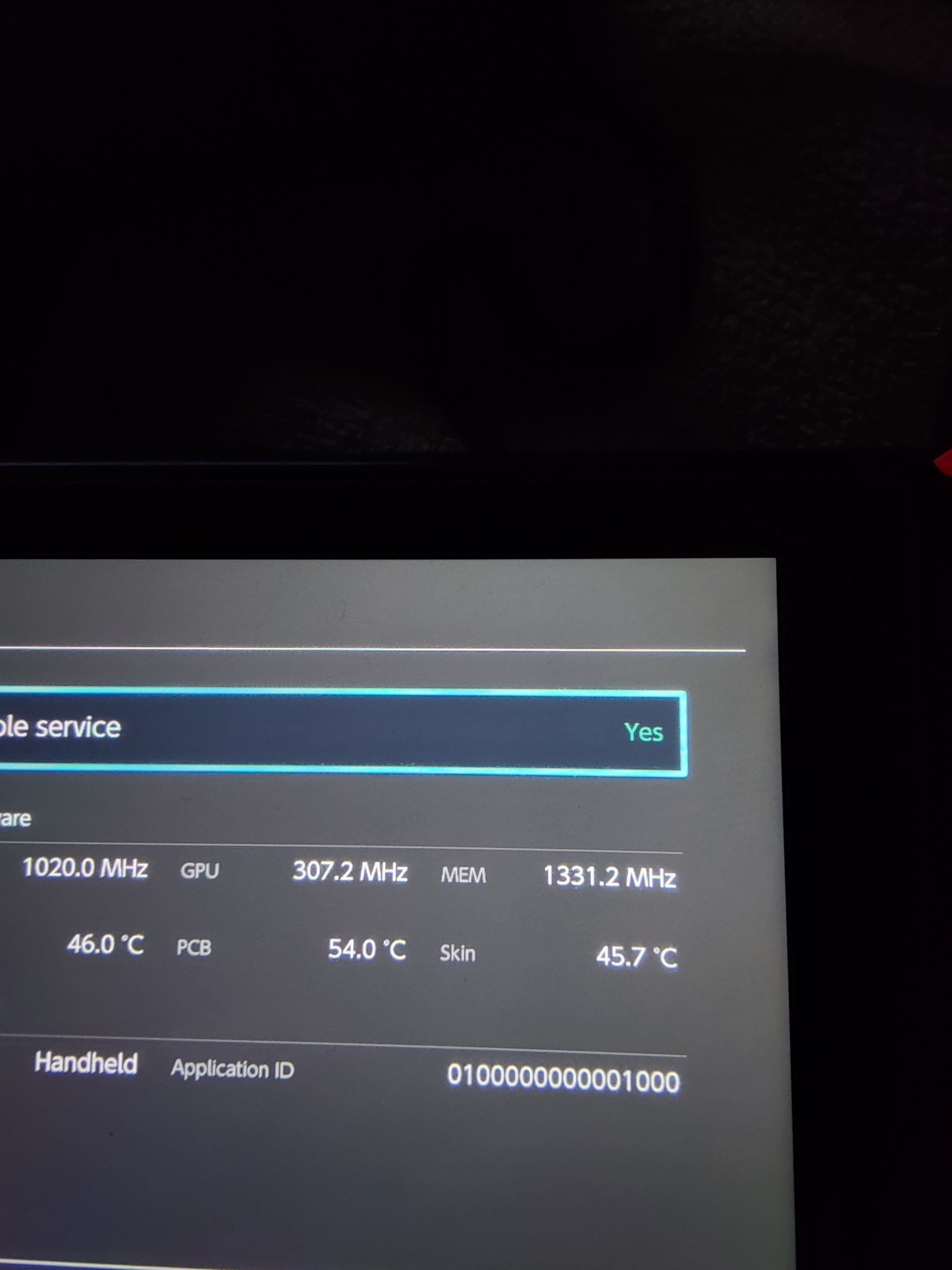

temperature from 45-50°+.(unused). in standby mode, it feels like the switch is a little in action and the temperature is about 34 °. I have a regular version of sys clk. First, in the tesla menu, I turned on sys clk, then I opened the homebrew app application with R pressed and there I already opened the emulator I needed. I recently used sys clk and only overclocked it in one tab, not for a specific game, but for the switch itself. I downloaded sys clk manager so that I could disable it through it. I disabled it in the program, but nothing changed. After restarting the switch, in sys clk manager it shows that sys clk is working. I deleted all possible sys clk files, but nothing has changed. My switch does not stop warming up, and in sys clk manager it shows that overclock is on. maybe during the shutdown he buged or something .

temperature from 45-50°+.(unused). in standby mode, it feels like the switch is a little in action and the temperature is about 34 °. I have a regular version of sys clk. First, in the tesla menu, I turned on sys clk, then I opened the homebrew app application with R pressed and there I already opened the emulator I needed. I recently used sys clk and only overclocked it in one tab, not for a specific game, but for the switch itself. I downloaded sys clk manager so that I could disable it through it. I disabled it in the program, but nothing changed. After restarting the switch, in sys clk manager it shows that sys clk is working. I deleted all possible sys clk files, but nothing has changed. My switch does not stop warming up, and in sys clk manager it shows that overclock is on. maybe during the shutdown he buged or something . View attachment 324940
Your clocks are normal they are default not overclocked even with sys-clk enabled. That homebrew app your using will let you enable sys-clk even if you remove all of its files but it won't actually do anything I believe but not 100% sure
In your case it does not matter whether you have sys-clk enabled or not as the clocks are the default non-overclocked ones - this means your switch might need new thermal paste or the fans cleaned.
I would not be concerned about your temperature. unless your switch is reaching over 65-70 degrees Celecius when playing a game in handheld or docked mode.

I changed the thermal paste over a year ago and it happened in an instant after sys clk. That's very weird. Today I opened the emulator and tried to play the game. There is no overclocking. But now the problem is that my switch is in action all the time even in rest mode. It drains very quickly, as if something is running in the background. It discharged overnight.

Action all the time you mean the fans on? Please give me temperature readings from Status Monitor when the Switch is just in the Home menu and when you are running a game, preferably screenshots.
In hekate run a battery check and upload the screenshot of the results. Your battery may have started to degrade significantly which leads to discharging issues.
