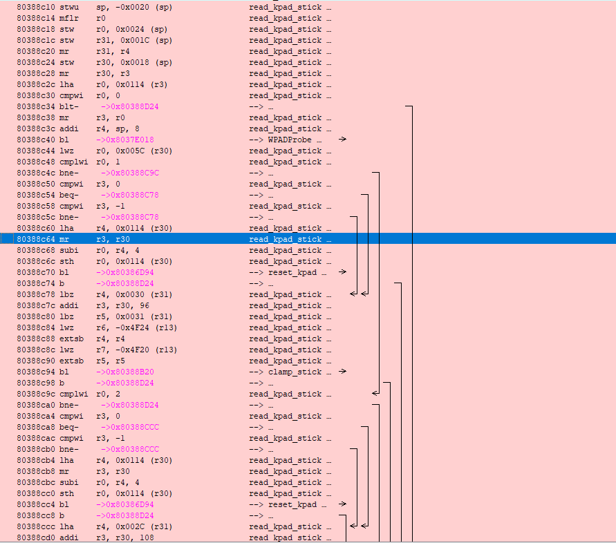

If I've got a symbol map, I'll usually just try searching for any functions that have "Nunchuk" or "Extension" in the name, because that's generally what they'll call any dedicated functions that check whether the right extension is attached currently. There doesn't seem to be a specific name that multiple devs share or anything, it's just whatever that team decided to call the function.
I currently need to learn more knowledge about disabling the Nunchuk check and redirecting the Stick input to the CC stick. This might really be my first complex game!
I'll cover Nunchuk stick support in the next reply since newhinton also asked about it. 👍
@Vague Rant I did it! Kinda!
I have written a small gecko code to sidestep the nunchuck-check. I found multiple candidates that looked like a check, but none had the desired outcome when changed.
However, at some point i had the idea to not look at the "reader", but the "writer" of the extension-bits, and that lead me back to WPADProbe. I patched this to always return an attached nunchuk. That probably has some undesired sideeffects. (I guess with this gecko code enabled, ONLY classic controllers will be supported. But i'll check that before i post it)
Now to the interesting parts: Since the button-injector works, i want to move on to the movement-controls. In the original game that is handled by the nunchuk.
Impressively done! Before we start, I want to mention that Lego Star Wars III: The Clone Wars has a debug symbol map on the disc. This should be a huge help to you. Go to the right click Properties screen > Filesystem and right click mapfile.map. Choose Extract File... and save the file to wherever seems sensible to you. Now go to the top bar Symbols > Load Other Map File... and load in the file you just extracted, then do a Symbols > Save Symbol Map to save the new symbols back to Dolphin's database for this game.

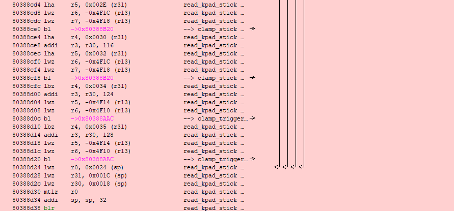

For Classic-to-Nunchuk stick redirection, I actually covered that back in this post, which goes to your point about how this would work much better as a web site than a 20-page forum thread. :D
To summarize the relevant part of that post, you need to locate read_kpad_stick() (or ext in newer games), scroll down to the two bctrl instructions which are where the Left Stick and Right Stick write out, respectively, and then look just before the first bctrl to where you see addi r3, r30, 12.
This is where the address where the Left Stick should write to in memory is set up: r30 represents the start of the extension portion of the KPADStatus struct, which contains all the input (sticks, accelerometers, pointer, buttons), and r30 + 12 is where the Classic Controller Left Stick gets written to.
The Nunchuk Stick instead writes to the very first dword (double word: two words, 8 bytes), i.e. r30 + 0. We want to change that addi instruction to make the Classic Left Stick write to there as well. We do this by replacing that instruction with an mr r3, r30 (move register to r3 from r30, without adding anything). In machine code, that looks like 7FC3F378.
To insert just that one instruction, we take the address where the addi instruction was and replace the first two digits (80) with 04, then our replacement code. Putting that all together, if we want to replace the instruction at 8001A114 with mr r3, r30, that looks like this:
0401A114 7FC3F378
With your current solution where WPADProbe() always writes that a Nunchuk is attached, I don't think this will work on its own, because when read_kpad_stick() checks the current extension, it will see 01 (Nunchuk) and skip reading the actual Classic Controller sticks. You're definitely on the right track though. I actually just looked at a related game and the Technical Notes for this current hack might be useful for Clone Wars.

I cant seem to find any bctrl stuff in read_kpad_stick. Do you know how to handle this part of hacking if its a game like Excite Truck? (Handles KPAD differently)
The symbol maps might not be correctly listed, but this is what read_kpad_stick looks like.
0401A114 7FC3F378
View attachment 482861View attachment 482860
Those clamp_stick() calls are what you're looking for. In very early games like Excite Truck and this, instead of the bctrl which allows branching to either the circle- or square-clamped analog range, games just used a hardcoded clamp_stick() function. The offsets look different compared to "modern" games, so uh ... it's not quite in the screenshot, but just above the first shot (literally one instruction off the top, I'm guessing), you should see addi r3, r30, 108. That's the offset where the Left Stick is writing to. You want to change that instruction to addi r3, r30, 96, which is 387E0060 in machine code.
So the final code you want to redirect the Left Stick into the Nunchuk Stick should be:
04388CD0 387E0060

The unbelievably helpful devs at Rainbow and Incinerator left behind unstripped ELFs on both the GameCube and Wii discs. This was instrumental in implementing both the pitstop skip and restoring the camera control button from the GameCube version. Give a round of applause to both teams.
Code breakdown:
  • 06 in CarsSettings::Reset(): set Preset 2 as the default control scheme (for both players)
  • C2 in CarsUIControllerSettings::HandleOK(): bypass Nunchuk error
  • 04 in CarsVehiclePhysics::SetControlInputs(): disable leftover double-tap boost we don't need
  • C2 and C2 in WIIJoystickDevice::Update(): add an extra button (Wiimote 0x40) to the in-game mapper to handle camera control, read Classic as a Nunchuk-type extension controller
  • 04 and 04 in setKpad(): disable native Classic Controller support in the Home Button Menu, which clashes with emulated Wiimote/Nunchuk support
  • C2 in read_kpad_acc(): fake accelerometer for Shake (Jump)
  • C2 in calc_dpd_variable(): simulate IR pointer
  • 04 in read_kpad_stick(): redirect Classic Left into Nunchuk Stick
  • C2 in read_kpad_button(): button injector
