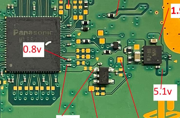

Hi everyone, its been a while but i've just go a EDM 010 in with a One beep issue, all voltages are present but under a thermal camera one particular spot near the HDMI encoder chip lights up i've narrowed it down to the circled chip below, ive also attached a video of the thermal camera footage.
Thanks everyone
Are you getting blue light then off? You can measure resistance to ground on pin 5 and 6 of that IC, that is the output.
Components surrounding looks like

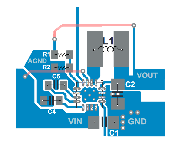

Could be (wierd number, but it is listed for BOM on PS5): https://www.ti.com/general/docs/sup...6&gotoUrl=https://www.ti.com/lit/gpn/tlv62090
TLV62090RGTT (SBV IC) a voltage regulator step down converter check if input and output mach befor buying for i found it for another PS type under another code name (F7002)
to be sure of the part, mail [email protected] for this company is.
this for i don't see an exact match, it could also be: Replacement Synchronous Buck Controller TI 3219A 5v Regulator For PlayStation 5.
