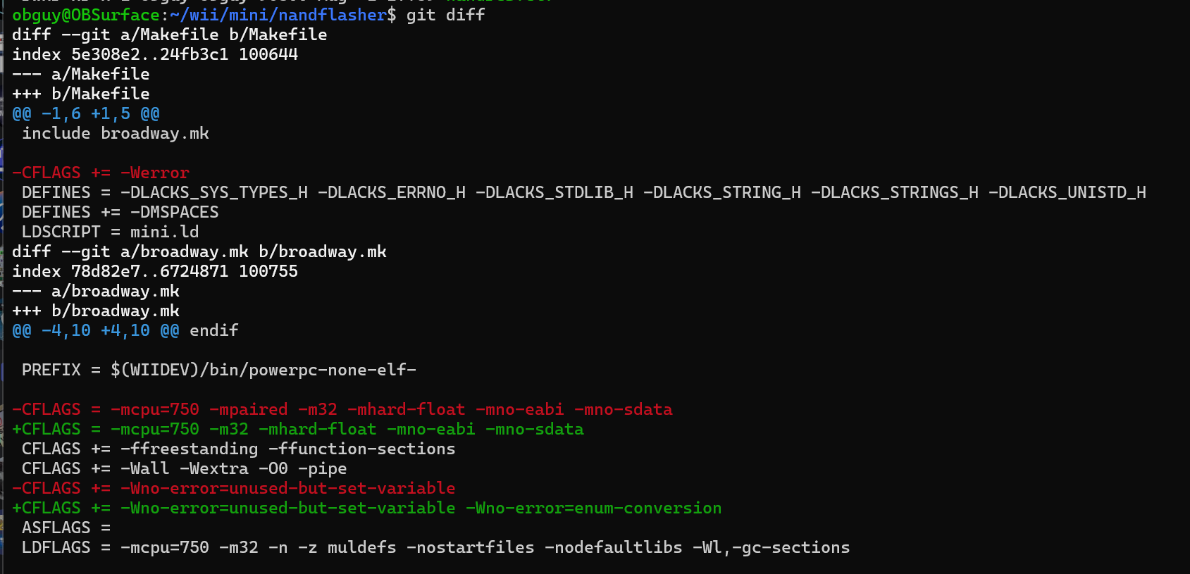

Yes I did get code running under mini after scavenging repositories. The repo I found was https://github.com/r00t1024/nandflasher
After making a bit of changes to it:
correct, powerpc-none-elf compilers must be used which you do not get with devkitPPC, but you can make them yourself. I hope.
