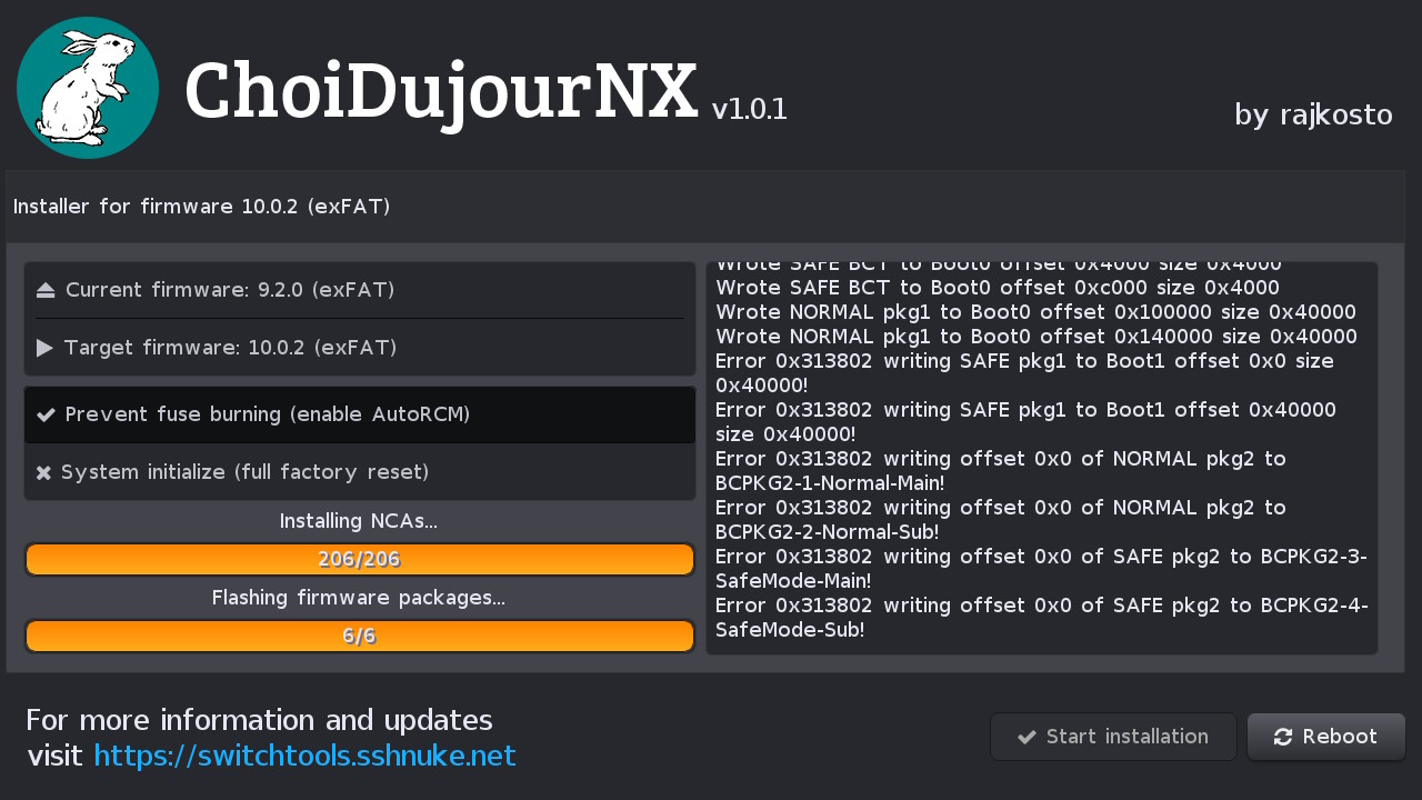

Hello, Ive a problem, few days ago I tried to update my switch 9.2.0 to 10 using choidujournx but at the end I got errors with pkg installation (it was written) and choidujournx said 100% so I reboot and I got black each time I boot with all method
So I restored my nand backup, and all is fine now
But I want to update my switch, what should I do ?

I retried using your settings and nothing change, but before I took a screenshot in the app

Not sure if it'll help your current situation, but I noticed from your screencap that you're running ChoiNX v1.0.1 and not the latest v1.0.2.

Okay so, I updated but when the app is testing bis keys
At 1/6 the app crash
so it seems related to BIS ?
try to remove the setting from atmosphere config file ? maybe it would show a proper error in choixNX instead of crashing?

I tried both setting and flag
If I remove atmos setting, i have to configure them another time, what should I activate/turn on?

It chashes at the BIS testing 1/6, directly
