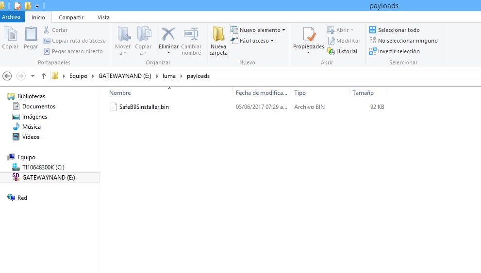

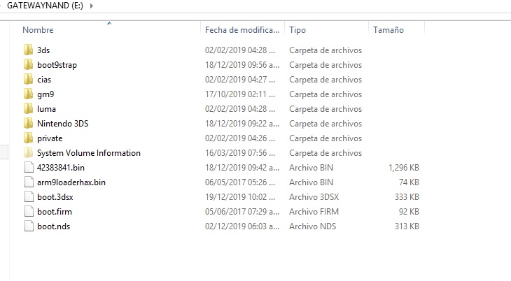

Hello, I'm trying to Upgrade from A9LH to B9S fallowing this Guide:
3DS Hack Guide / A9LH to B9S (I'm New, I can't post HyperLinks)
The Problem is that in Section II - Installing boot9strap they ask me to Boot your device while holding (Start) to launch SafeB9SInstaller
and it just dosen't work.
If I Boot+Select it shows the Luma3DS v7.1 Configuration Screen, But if I Boot+Start Nothing Happens it just boots the normal 3DS Home Screen.
Let me Show you my SD card (Uploaded Files)
Can someone Help me, please?

Put the latest boot.firm to the root of your sd card. And you can delete the boot.nds
Sorry, i was at work, i'll try that
You don't have A9LH, you have an outdated B9S, follow
That won't work, OPs B9S version is too old to run the latest Luma.
ok, i'll try that, let's see...
