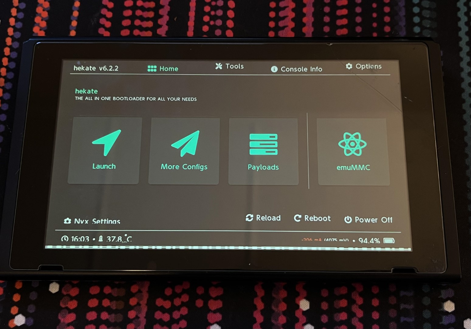

Has anyone else seen this issue? Booting OFW is fine but hekate freezes and has this visual glitch.
I have tried a different RP2040 and have checked the solder connections, also tried reformating SD card, and new SD card adapter.
It is a Erista console (HAC-CPU-10), both chips I tried have been flashed with v2.80
Thanks :)
I have tried a few more things and noticed the temperature still updates when it has the visual bug and touch doesnt work so not frozen. Not sure what about this specific console causes hekate to have this issue but it doesnt seem to be an issue with the modchip or the install.

Not completely your issue, but I have found a way to make hekate unhappy with freezing and visual glitches while toying with EMMC replacement. I either have a bad solder job or bad daughterboard. When I hot swap it into my Switch it causes Hekate to stop responding, the charge indicator goes to 0mv and 0% battery. It usually recovers if I pull the suspect EMMC board.

In my case it was most certainly the EMMC replacement job. As soon as I plugged in a working on things were fine. I believe I my solder balls were too big, haven't given re-balling it another try yet.

Is yours patched or unpatched? If unpatched you can boot Hekate with the EMMC unplugged. If Hekate behaves normally without the EMMC connected that would be a good indication that the problem is related. Make a backup if you can of course.
