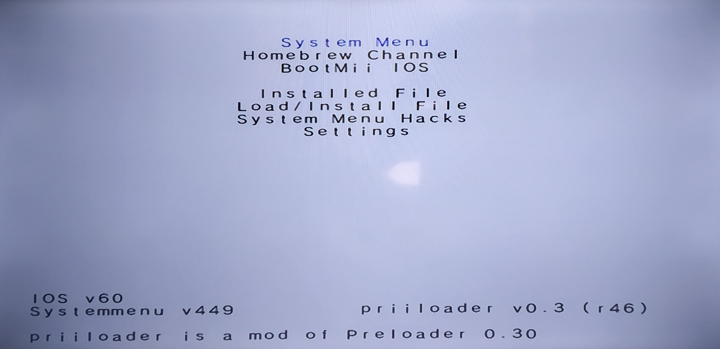

dear FEF1, i'm sorry when ask you about my case in this post, but i don't know how to message for you, so please review my file (error screen) below, i cannot do anything when turn on Wii, just this screen display and cannot press any button to access menu, please help, thanks

Do you have a Gamecube controller or a Wii Remote that is synced up to that wii and charged. If so, just click on the System Menu option. If not, then either try to sync up a Wii remote (Not sure if you can in Priiloader), or turn of the Wii and mess with the reset button (on the Wii) a little bit before turning it back on. It may be stuck pushed in.
i haven't gamecube, Wii remote just blink 4 light and no-sync
what you mean "mess with the reset button"? press many times or open wii and clean the button?
can we use a usb or sd card to boot and setup new firmware for console? i don't need backup anything in this console
thanks,

By "mess with the reset button" I mean to just push it a couple of times, maybe wiggle it some. I'm saying to do that because this is Priiloader, a screen that comes up when you hold down the reset button when you turn on your Wii, so maybe the button is stuck.
i tried push [reset] many times, so nothing happen
my kid said they tried to format memory, but they don't know what's the memory (SD card or Wii)?
after that, turn on Wii and this screen display
can we have anything to try?
thanks,
FEF1
Has ran into every thinkable error on the Wii
Aug 22, 2018
375
20
1,374
Well... it's not throwing an error, so that's good. What happens when you click the reset button while in Priiloader?
