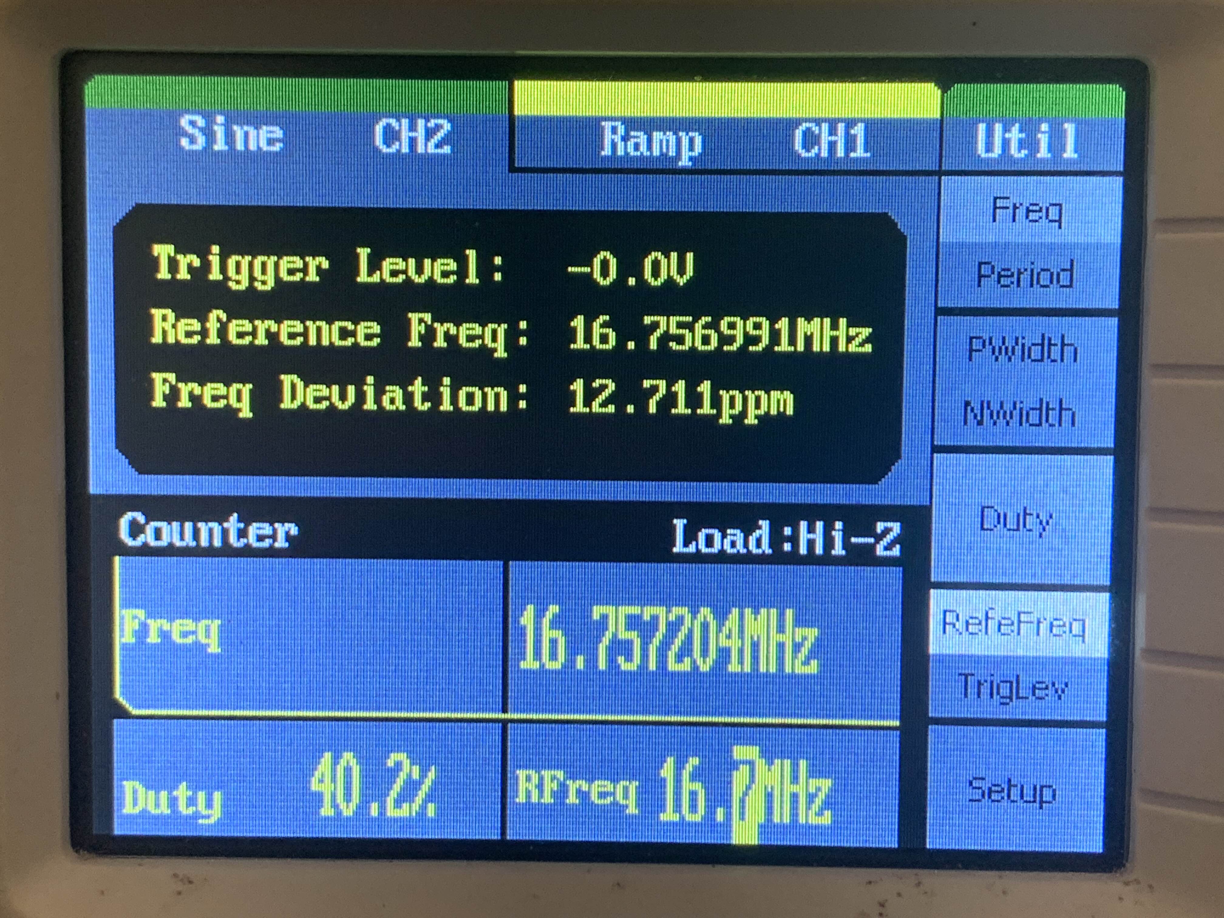

I also confirmed it on a frequency counter. For future record, these are captures of the Nintendo DS clock output (on slot 2). It's the same clock no matter if it's in NDS or GBA mode. The output is very close to 16.756991MHz. It's just dividing the bus clock by 2. So indeed, the bus clock is 33.513982MHz.
