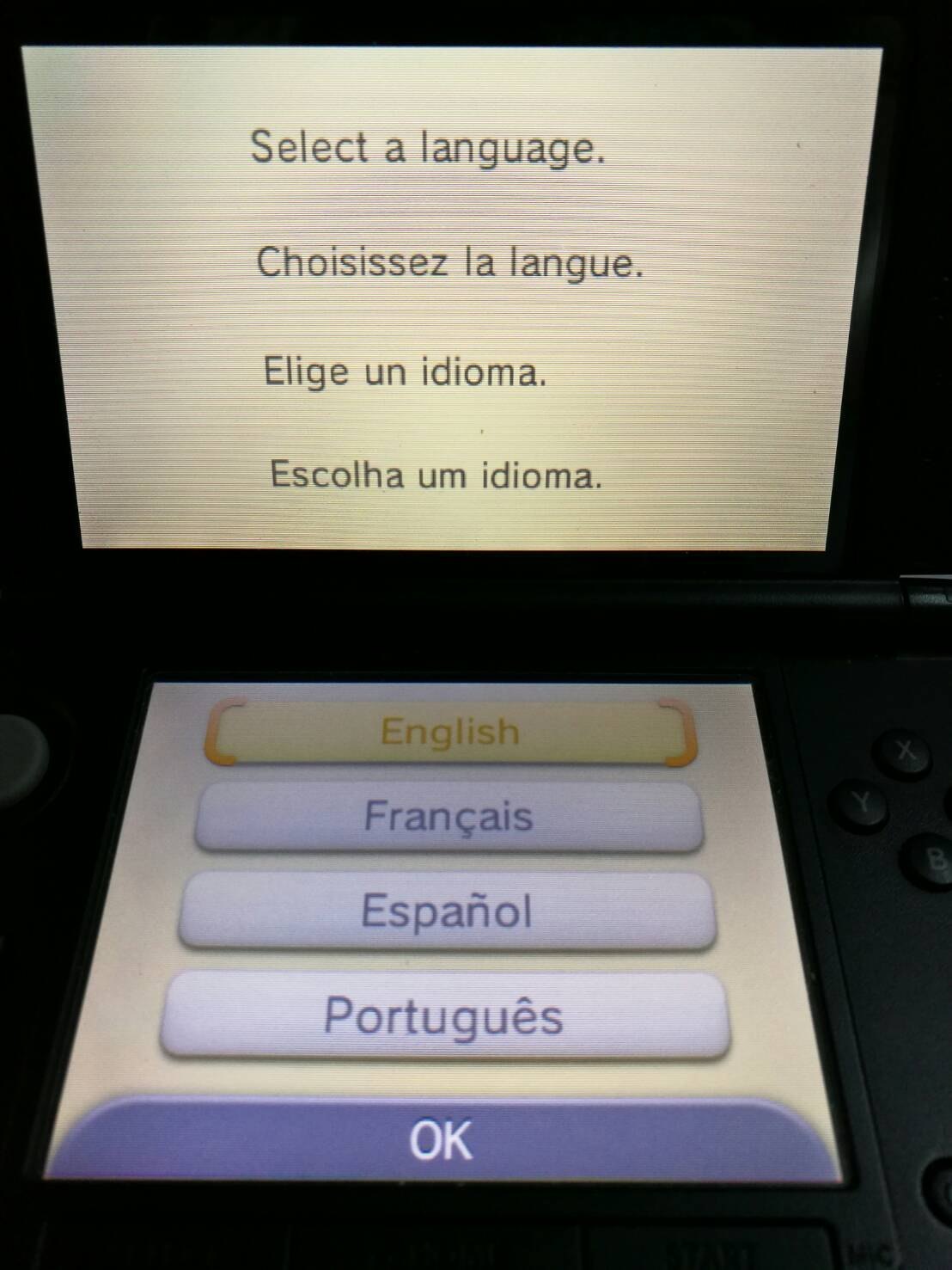

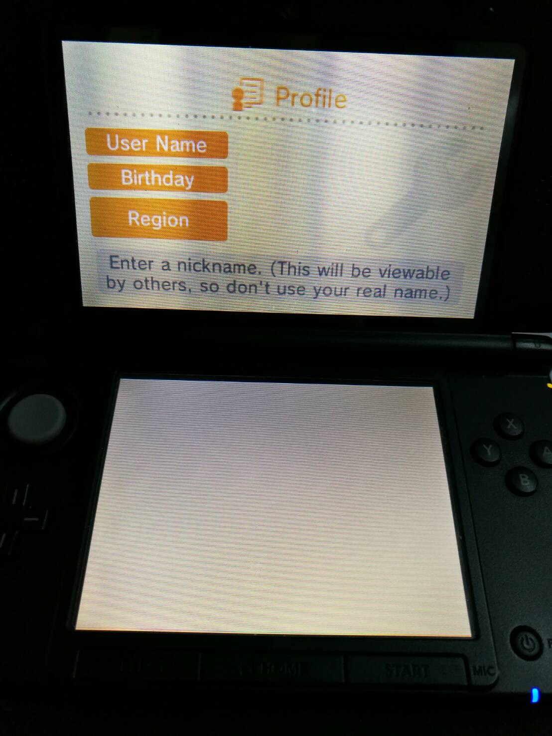

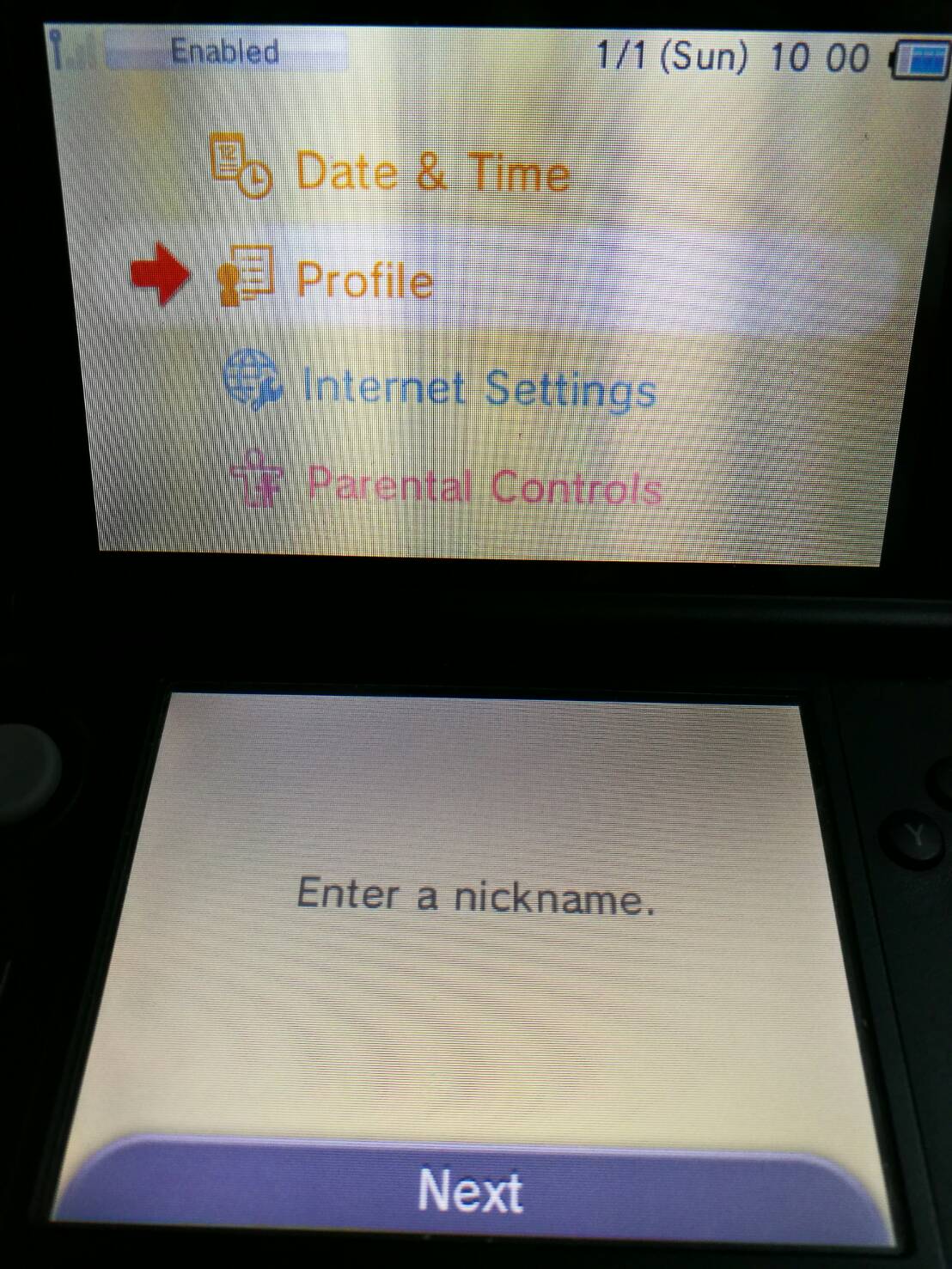

Hacking FW 2.1 factory reset problems
9tum
Sep 6, 2004
351
Thailand
Old 3ds XL
Gateway >> timemachine >> downgrading to 2.1 > factory reset
can't set up profile
no keyboard
Urbanshadow
Oct 16, 2015
1,578
33
1,723
Plailect doesn't recommend factory resets on 2.1 because of these thingies.
If you are able to to reach those screens, recovery mode should work (since your system is o3ds) but that is your last resort, since you'll land in 11.0.
You can't cart update because the browser is very low in version. You can't really reach home menu. I bet the keyboard doesn't show up because it's not downgraded/bad downgraded -> broken in the process of downgrading.
You shouldn't made a factory reset. Does the GW guide recommend a factory reset?
Just for giggles, try to go through the setup without sd.
Oh and people in here will say it's your fault for using GW's timemachine in the first place instead of a9lh, even if the issue is not connected to it.
