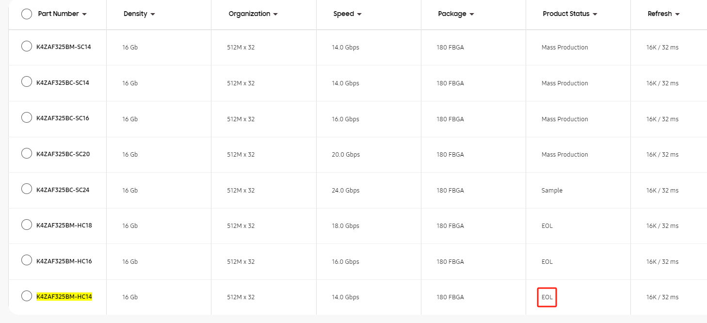

I was also wondering if you had tried SAMSUNG K4ZAF325BM-HC14 instead of SAMSUNG K4ZAF325BM-SC14 ?
Thanks
I don't see any reason SC14 would not compatible with HC14. From Samsung site, SC14 should be the EOL(end of life) HC14 replacement.
