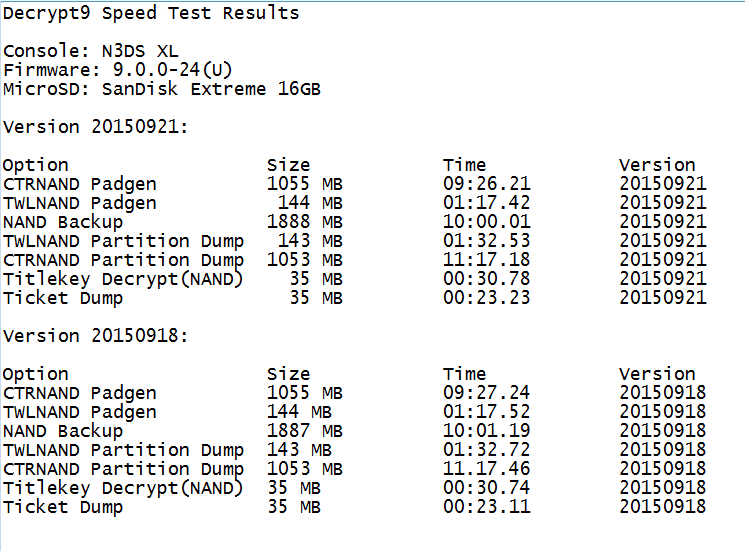

Here is a screen of my speedtests. I did not have much of a speed difference between the 2 versions. Also I had a different size NAND dump from the two versions (about 1MB) do you know why that would be different?
I can do more tests if you would like! Let me know what you would like me to try, thank you for your work on this!
