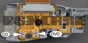

"Error while reading disc" is the new version of the "Disc read error." message. Your laser probably died, so you need to replace it or use Open PS2 Loader.
The PS2 laser has two potentiometers that control the voltage output. One is to read CDs and the other reads DVDs. If cleaning doesn't work you can try adjusting the DVD one to increase the voltage.
Where can those potentiometers be located?
Is it under one of those iron shields?
So a few hours have passed, and I finally got the PS2 game working.
Just like what zfreeman said, I had to turn up the voltage. Only by turning both screws into 2 degrees, the PlayStation can now play all games and it's fully repaired.
