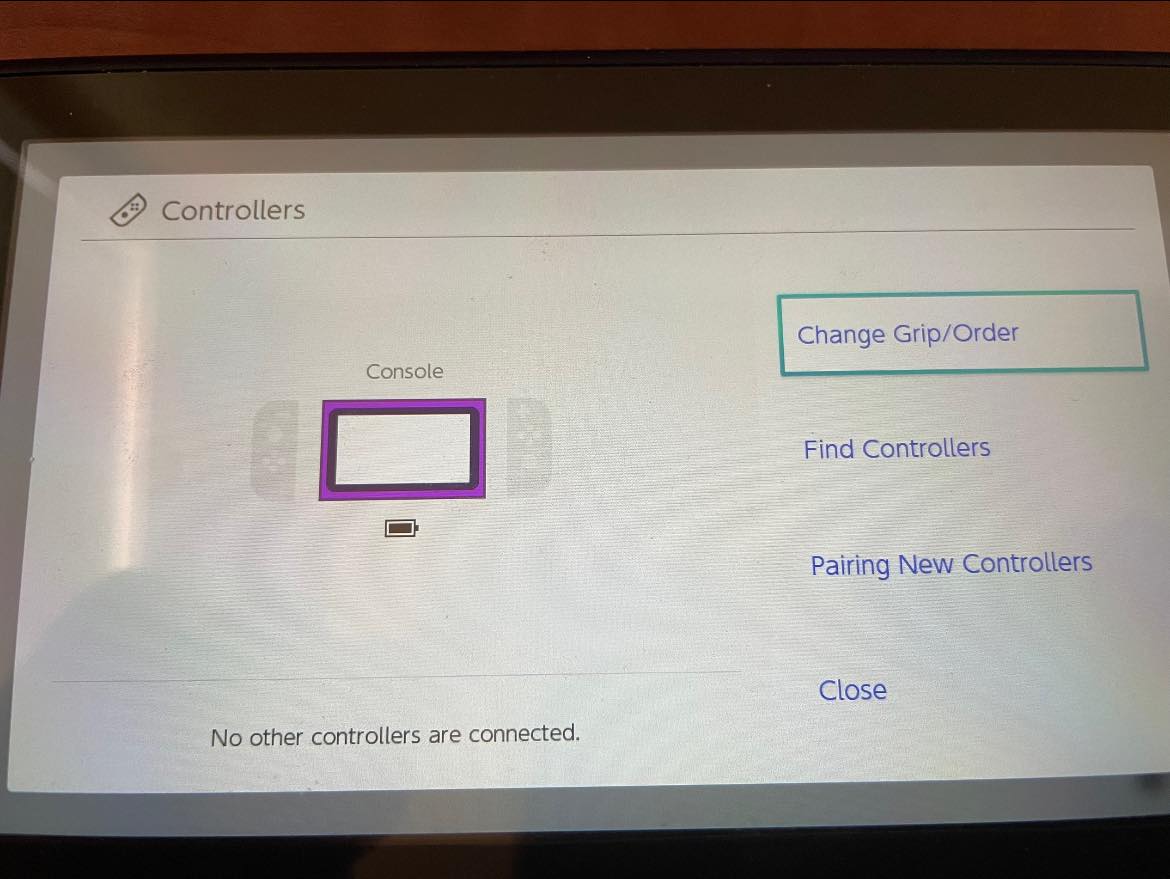

So I have done a lot of research on this and cannot get the last step with the CRC-16 values. I checked the code at
https://switchbrew.org/wiki/Calibration
and don't quite know how to get input the hex values where. I tried to compile and run the code and gives me syntax errors.
I have checked github carameldunes and I think he doesnt mess with switches no more
Anyone know how to get the final values for YY= crc?
