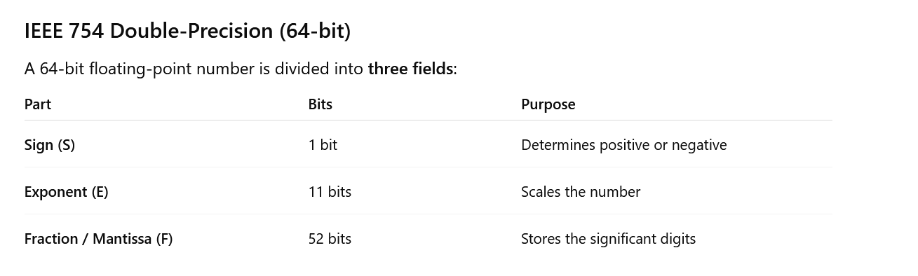

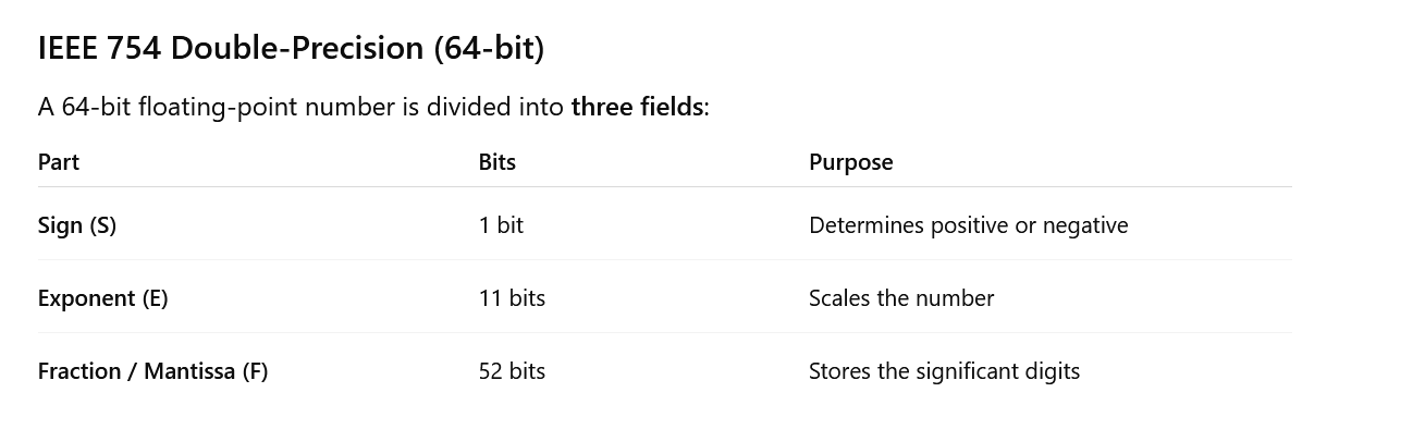

I’m not sure why there’s an argument about f64 vs u16; this is what you can do with a u16.
If you write to the most significant 16 bits, you can modify the f64 value’s sign bit, exponent, and the most significant 4 bits of the 52-bit mantissa. This guarantees that you can change the first digit of the f64 value, and you can also move the decimal point to essentially anywhere you want.
For many use cases, this may be sufficient as a hack.
