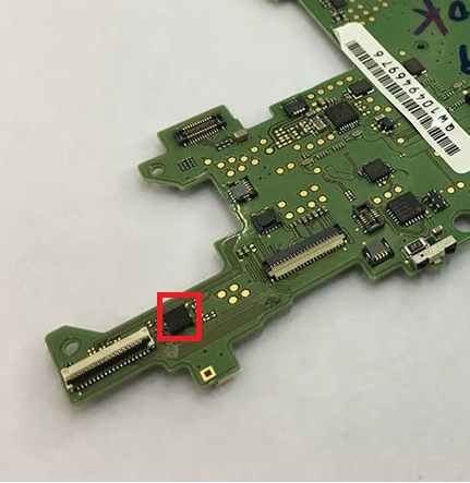

the only hardware failure i can think of is that because you've installed extended battery, which comes with its own battery cover/screws - you might've "longscrewed"/crushed the SMBus IC (the chip outlined in Red in the picture), it's right next to the camera connector and sits under the screw hole for the battery cover, so i would remove the back cover and check if it's ok
Thanks...I'll check this when I have some time.
So here's what happened...I didn't think anything of it at the time, but now I realize when I was putting the screws back into the panel that holds the battery, I (like an idiot) wasn't paying attention and tried to put some of the screws into the holes where the back panel screws are supposed to go. I looked at my board just now, and it has a deep indentation right next to those four gold circles next to the chip you highlighted. Such a stupid mistake that means I'm gonna have to either get a new 3DS, get a new motherboard, or get someone to fix it. You know anybody in these forums who fixes stuff like this?
Thanks for pointing this out. You nailed it.

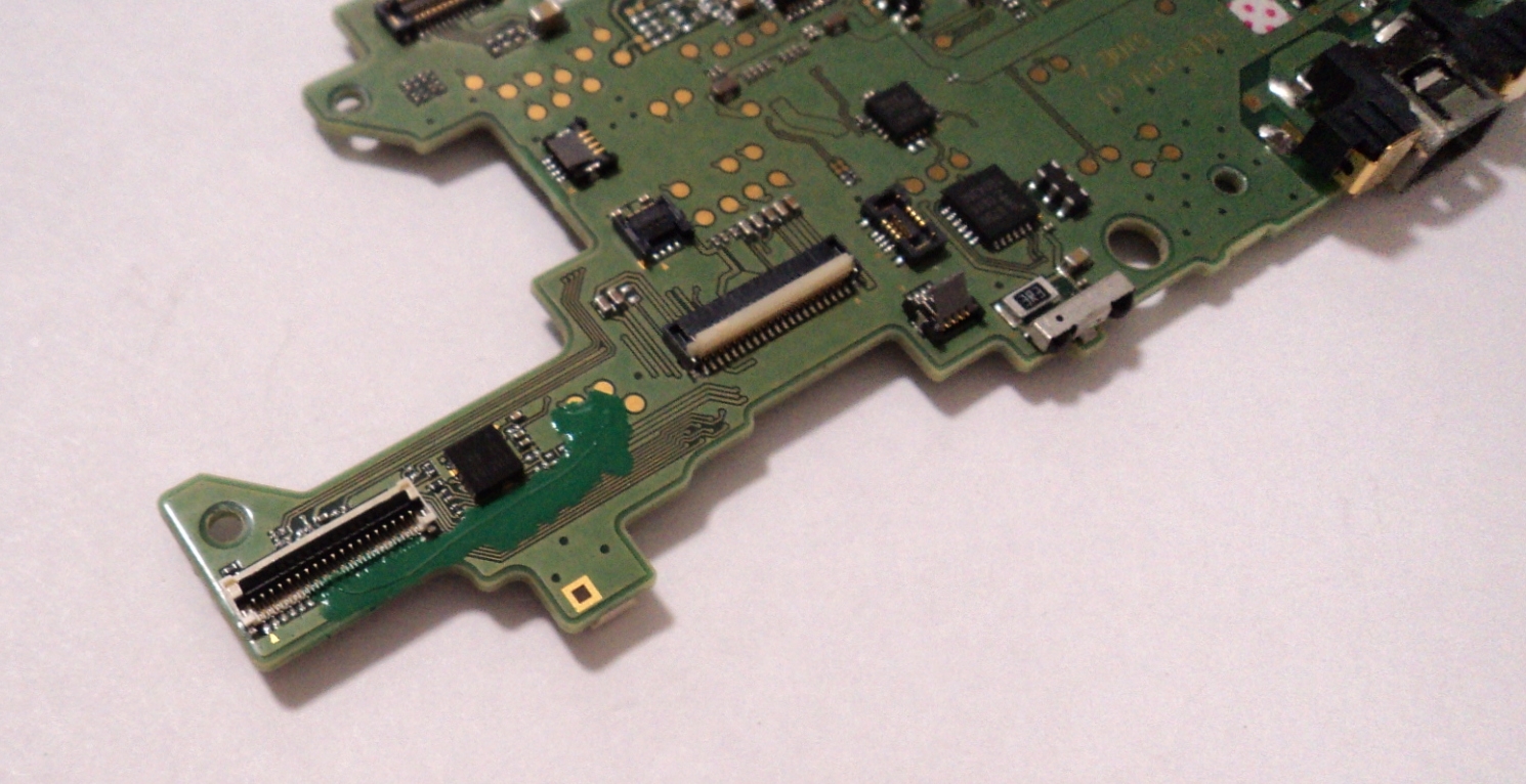

here is the picture of it repaired
Wow, amazing and clever workaround. Congratulations, one can't find such good technicians here in my country, I wish there were.

Yeah, he has a repair service on eBay with very good reviews so I figured it was a way better option than trying my luck with having Nintendo fix it. I really appreciate him for taking care of it, but I'm still kicking myself for doing something so stupid in the first place like long screwing my board...
