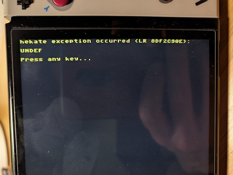

cannot currently boot to OFW 18.1.0 completely clean (not even initialised) from Hetake 6.2.0 : I don't even get the nintendo or switch splashscreen, only black screen stall.
cannot either boot to semi-stock 18.1.0: get the nintendo screen, then black screen.
Power off
power on to hetake

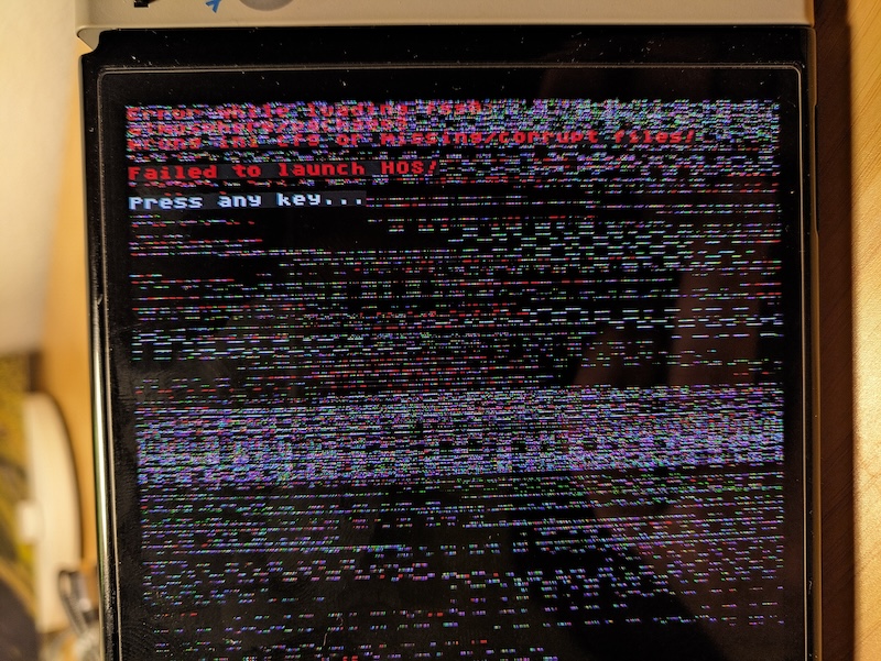

booting semi-stock -> no it's red errors over buggy multicolor artefacts

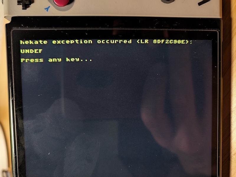

booting to CFW@SysMMC -> I now get this new funky error screen

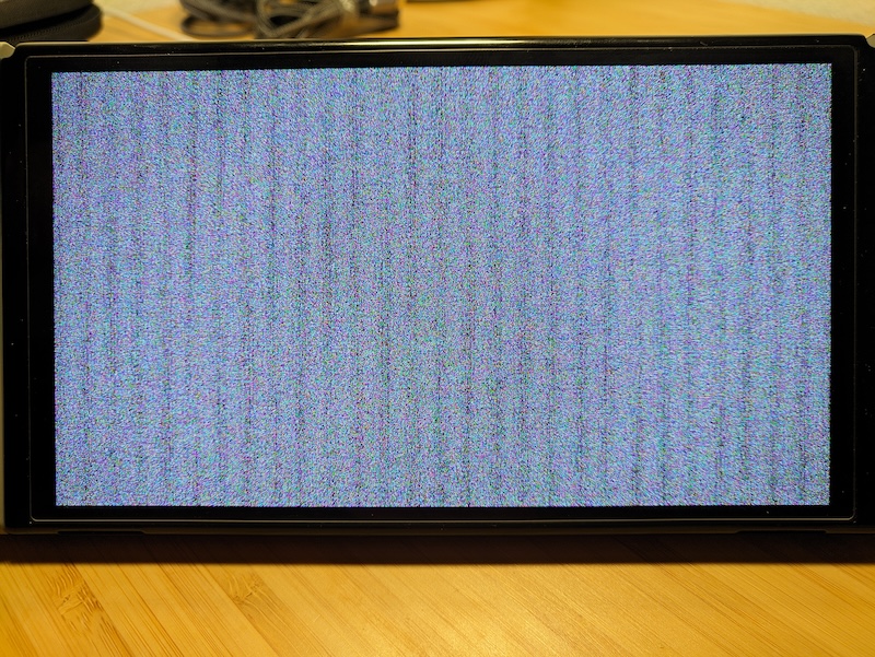

when I press power on this screen, I get an animated greyish multicolor screen
Seems my OLED device (at least SysMMC stuff) is currently in a bricked state.
I should probably be able to still restore access to an EmuMMC thanks to an old back up I must have somewhere and using the previous hetake version.
I wonder what might be off.
Probably not that, but may Nintendo have found a way to detect modchips from OFW?
Nintendo hasn't done anything against modchips else it would be mentioned all over the place here.
The UNDEF error comes from the Nyx module so there is a chance that the files on your SD card are corrupted.
I would suggest to try again with a fresh install of the latest version of Hekate from Github.
Hello, I was having exactly the same issue after updating OFW to 18.1.0 and updating Atmos + Hekate using the HATS package. After manually installing everything, downloading hekate and Atmosphere separately, it's working as expected. Not sure if it's the HATS download or if something is not ok with it since I tried downloading twice.
