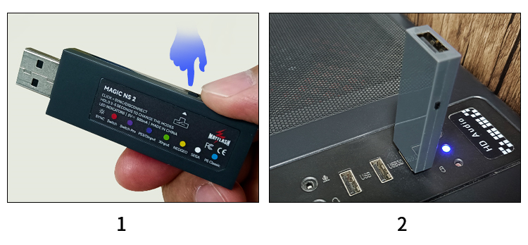

  • Press and hold the button on the side of the adapter, and connect the USB of your adapter in any free port on your PC, and wait for 3-5 seconds. After completing the above steps, the program automatically identifies the adapter (LED indicator turns off).
  • As soon as the driver window indicates under «Device» that the adapter has been recognized, you may release the button.

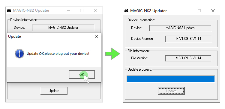

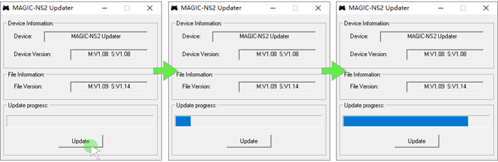

  • Click «update» and wait for a few seconds. The update is completed when the progress bar reaches 100%.
  • Note: Do not disconnect the device until you are informed that the updated was completed successfully.
Press «OK» to complete the update.
