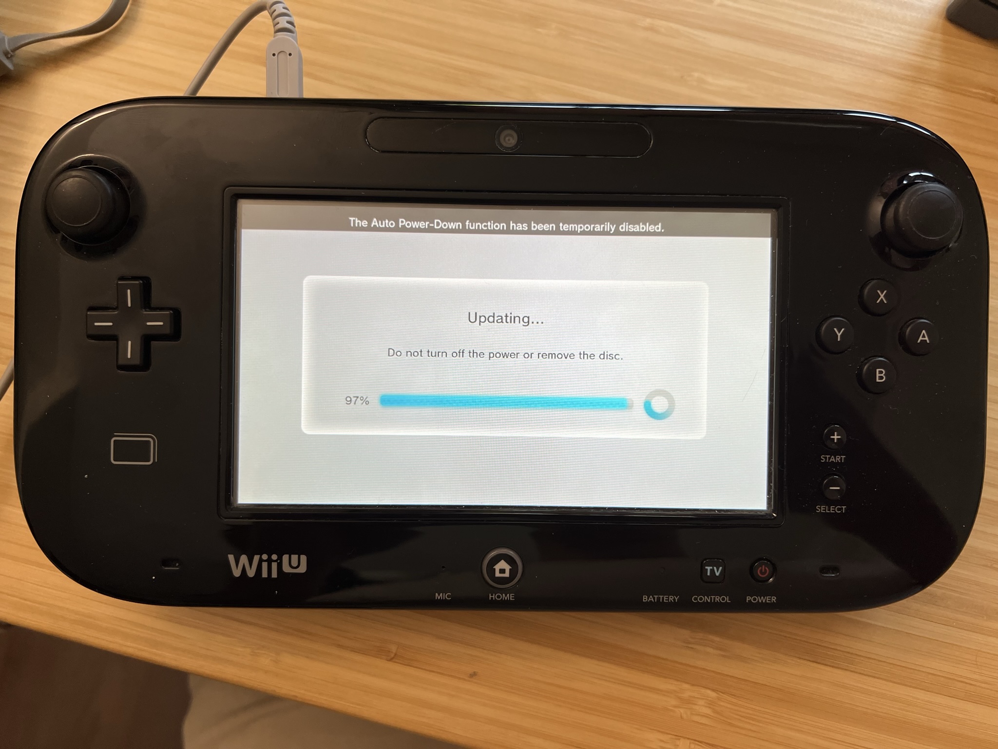

Awesome that worked! I disabled the standby functions, moved the problematic files around with wupclient, and was able to install those last 3 titles! :toot:
When I booted it back up, it wanted to do an update, but looks like worked okay. Running the nand dumper again now.

Good job, well done!
I think you can now try to delete the moves directories of the titles you just reinstalled.
Just remember to not attempt a factory reset or the System transfer (as this would also trigger a factory reset)
EDIT: you could also try to move the corrupted directories to a new folder in the root of the mlc, so they don't get in the way, so they don't get in the way if you ever decide to delete the affected titles. (if quotas don't get in the way ofc, but just try it either it works or it doesn't)

You're both awesome, I'll gladly wait for a fix. :)
Try creating a directory in /vol/storage_mlc01/corrupted and then try to move ol/storage_mlc01/usr/save/00050000/10102000 there.
I tried this too, but wasn't successful.
