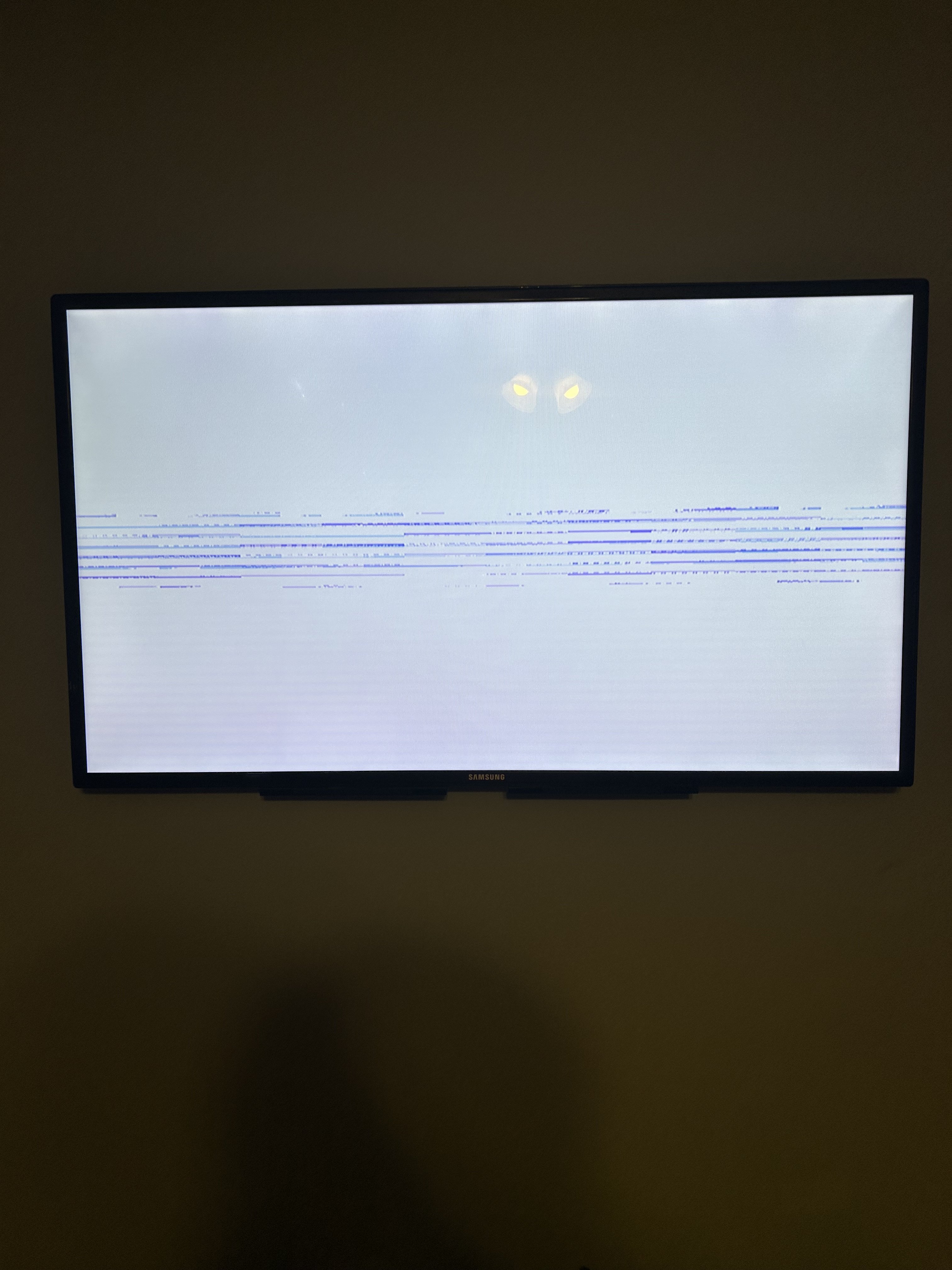

Hello everyone,
First time poster here. I decided to make this post since I am having issues with my Wii U. Currently, my Wii U will not boot up to the main menu. It stays stuck on the Wii U logo indefinitely.
There are a few things to note about my console. The console is the black 32 gb model. I believe it was bought during the 2012 holiday season (release) as we were expecting to play Pikmin 3 before it got delayed. The system has never been modded in any fashion. It was not the most heavily played console, and I can't even give a good estimate of when it was last used (at least more than 3 years).
I have already tried doing the UDPIH, however it does not seem to be working. When using the second recovery menu, I get a white screen with some blue lines (see attached image). I believe this is similar to what @fadafwet described in his post. I was able to get the logs from the system, which I have attached to this post. Any idea what the issue may be and how to fix it? Any help would be much appreciated.

It doesn't seem to produce logs anymore. The last one is from 2015 and you were playing Super Smash Bros. for Wii U.
Can you try to dump OTP blindly?
After you have dumped otp put the attached recovery (rename to recovery_menu) on a 64GB sdcard. Start it through UDPIH, the led should be purple, even if the screen doesn't change. Press power and wait a minute, the LED should flicker yellow. When it is done it will go back to purple. You should then find a mlc.log file on the SD please upload that and keep the generated backup somewhere safe, in case you need it.

39.log:00:00:10:526: FSA: ### MEDIA ERROR ###, dev:mlc01, err:-2228230, cmd:11, path:(null)
40.log:00:00:02:600: FSA: ### DATA CORRUPTION ERROR ###, dev:mlc01, err:-1245211, cmd:25, path:/sys/title/00050010/10049100/code/app.xml
40.log:00:00:03:465: FSA: ### DATA CORRUPTION ERROR ###, dev:mlc01, err:-1245211, cmd:25, path:/sys/title/00050010/1004c100/code/app.xml
40.log:00:00:03:791: FSA: ### DATA CORRUPTION ERROR ###, dev:mlc01, err:-1245211, cmd:11, path:(null)
40.log:00:00:05:019: FSA: ### DATA CORRUPTION ERROR ###, dev:mlc01, err:-1245211, cmd:11, path:(null)
40.log:00:00:07:166: FSA: ### MEDIA ERROR ###, dev:mlc01, err:-2228230, cmd:11, path:(null)
so yeah the data corruption is caused by MEDIA ERRORS, meaning the eMMC is reporting, that it can't read the data anymore -> bad emmc.
Also there are more files damaged (from 40.log):
00:00:05:364: mmc_core card err: idx=3, lba=55263232, blks=1024, xfer=0x1, ret=0x00200b40
00:00:05:524: mmc_core card err: idx=3, lba=55263232, blks=1024, xfer=0x1, ret=0x00200b40
00:00:05:524: mdblk: err=-131099, mid=0x90, prv=0x5c, pnm=[HYNIX ]
00:00:05:781: mmc_core card err: idx=3, lba=55264256, blks=1024, xfer=0x1, ret=0x00200b40
00:00:06:050: mmc_core card err: idx=3, lba=55264256, blks=1024, xfer=0x1, ret=0x00200b40
00:00:06:050: mdblk: err=-131099, mid=0x90, prv=0x5c, pnm=[HYNIX ]
00:00:06:301: mmc_core card err: idx=3, lba=55265280, blks=1024, xfer=0x1, ret=0x00200b40
00:00:06:559: mmc_core card err: idx=3, lba=55265280, blks=1024, xfer=0x1, ret=0x00200b40
00:00:06:560: mdblk: err=-131099, mid=0x90, prv=0x5c, pnm=[HYNIX ]
00:00:06:722: mmc_core card err: idx=3, lba=55266304, blks=1024, xfer=0x1, ret=0x00200b40
00:00:06:893: mmc_core card err: idx=3, lba=55266304, blks=1024, xfer=0x1, ret=0x00200b40
00:00:06:893: mdblk: err=-131099, mid=0x90, prv=0x5c, pnm=[HYNIX ]
00:00:07:022: mmc_core card err: idx=3, lba=55267328, blks=640, xfer=0x1, ret=0x00200b40
00:00:07:165: mmc_core card err: idx=3, lba=55267328, blks=640, xfer=0x1, ret=0x00200b40
00:00:07:165: mdblk: err=-131099, mid=0x90, prv=0x5c, pnm=[HYNIX ]
00:00:07:166: failed to read file /vol/storage_mlc01/sys/title/0005001b/10042400/content/CafeStd.ttf, err -196673
00;00;07;046: ***LoadShared - WaitLoadComplete(0,2442464) failed with error -196673 on file "CafeStd.ttf".
The eMMC is also a Hynix, they are known to fail.
My recommendation is to run the dumper, then turn the Wii U off and only turn it on again after replacing the eMMC.
OTP holds the keys for your console. It allows us to decrypt the dump on the PC. The mlc.log will tell us the state of the eMMC. How many errors the dumper encountered. It also contains the Manufacturer and the Manufacturing date of the eMMC.
don't have a backup of the nand, with this dump will it be possible to recover the system by changing the nand?

The backup isn't strictly necessary as you could just read out the eMMC and clone it to the new media, and that would also be the recommended way. But the backup gives us a chance in case thing deteriorate further. Also we could analyze it on the PC to see which other files are broken.
Here you can find more info about that problem: https://gbatemp.net/threads/how-i-fixed-160-0103-system-memory-error.626448/
@Voultar is working on a board, which makes the replacement much easier: https://gbatemp.net/threads/how-i-fixed-160-0103-system-memory-error.626448/post-10115383 you might want to wait for this.
I did as you instructed. I turned off my Wii U when the light was going back and forth between blue and yellow. I have mlc.log, but it looks like there is nothing there.
ChefVortivask
Apr 3, 2023
339
26
542
My mistake. It had gone on for so long that I assumed that the light switching back and forth meant it was done. I have it going right now and it has been dumping for more than an hour. On average, how long does this usually take?
