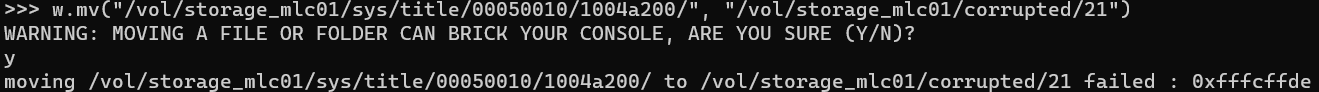

Rimzi
May 30, 2023
17
21
45
Germany
Will crash it again and dump the log again. Be right back!

Rimzi
May 30, 2023
17
21
45
Germany
Remove the slash at the end of the folder:
w.mv("/vol/storage_mlc01/sys/title/00050010/1004a200", "/vol/storage_mlc01/1004a200_backup")
Still not working. Deencrypted program also comes with no title file.tmd
