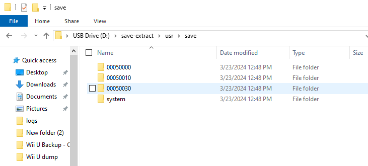

Got it. Just the first 3 folders then in the picture correct? Also the system needs to be modded with CFW to use SaveMii or FTP right? What's the best CFW to go with? Sounds like Aroma is the best from what I'm reading but best to ask first to be sure. Also definitely still going to work on the faulty Wii U, I think console preservation is important so if it's salvageable it's worth it IMO and having an extra working console never hurts.

The 00050000 contains the game saves. Miis are stored in 00050010/1004AX00/user/common/db/FFL_ODB.dat
Here you see the title list, so you know which save belongs to which game: http://wiiubrew.org/wiki/Title_database#00050000:_eShop_and_disc_titles
Inside the sasve folder for each game, you will find one folder for each user. The user ID starts with 80000000 and then counts up for each user created. You may have to either rename the userid in your save or create users on the new console to match your old IDs.
And yes, you need a CFW. Aroma is state of the art, and it even has a FTP plugin (but you would need to enable system file browsing in the plugin settings)
