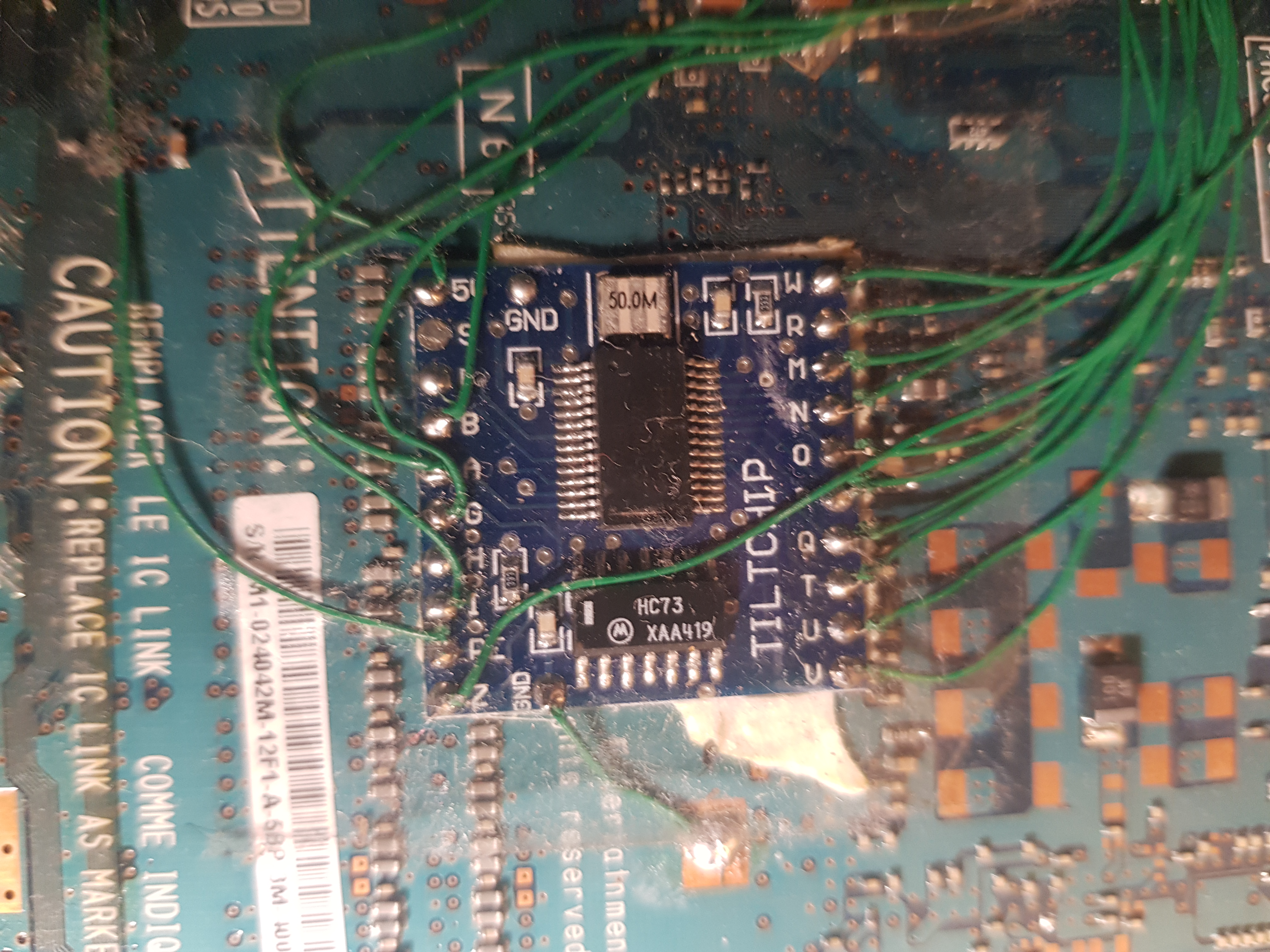

I bought a cheap PS2 (SCPH-39004). It came with 2 untested controllers (turns out they both are good except sticky thumb caps), EyeToy cam and a bunch of burned games. For 10 euros.
The seller told me it doesn't read discs, so I supposed the laser needed replacement. But it turns out it only needed cleaning and some of the flat cables was not seated correctly. The unit has a modchip.
It can play both burned CD and DVD PS2 games (so the laser is good). Burned games only boot when the disc is inserted and then the console rebooted. It cannot start a burned game from the browser.
But I cannot get PS1 games to boot at all, both originals and backups. If I boot the console with a original PS1 disc in, it boots to the browser saying "no data". If I boot it by holding the power button for 2 seconds, it boots the PS1 original as audio-CD if it has audio tracks (Bust-a-Move 2, Moorhen 3) and gives a red screen saying "no PS1/PS2 disc" if it's a original with only data (Crash Bandicoot 2). The audio tracks plays fine, so it has no trouble reading the disc.
I disassembled the console and can see the modchip, but I don't know what chip it is. Does someone know what it is and if it can play PS1 games?

You have a Ripper modchip installed.

Thanks, that was a good direction to look in how to start PS1 games.
It needs two presses of the reset button after the blue light comes on to get it into PS1 mode. It can boot both originals and backups then :-)
But it's weird that PS1 originals need this too. In the list of special modes The Ripper should boot them in normal mode too.
Also, my chip looks most as a Ripper 2, but it doesn't have the small IC in the corner. The Ripper IV is completely different.
The Ripper IV is not based off the Ripper hardware, but instead its a clone of the Prodigy and Magic family of chips.

The Ripper chip looks most like "Ripper 2 Gold" missing the small chip in the corner, but Ripper 2 Gold (https://www.metagames-eu.com/forums/playstation-2/ps2-v9-ripper-2-gold-9209.html) should be able to play DVD-video using RGB without green screen, but the one in mine doesn't seem to have that function. Is it a clone of The Ripper 2? :lol:
@Fien I agree with this, the PCB looks very identical to the Ripper 2 Gold, most likely a different revision. I'm not 100% certain tho if clones existed of this type, most cloners tend to use the name of the chip for completely different designs, like I mentioned earlier with the Ripper IV that uses the Magic Ice as a base.
