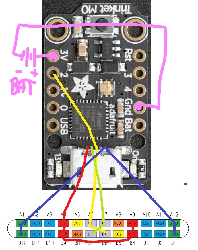

im trying to build an external usb injector with the trinket m0 and a 2032 coin cell. Im having some issues with this as i cant figure out how to setup the files onto the trinket. any help would be very appreciated.

im trying to build an external usb injector with the trinket m0 and a 2032 coin cell. Im having some issues with this as i cant figure out how to setup the files onto the trinket. any help would be very appreciated.View attachment 180867
OK... Forget part 1... All you need is part 2. Use method 3 file(it isnt listed in OP, but it is on my github)
Connect + to 3v, - to GND. Jobs a good un.
If you want it to wake on USB, you need to put a strap from USB D+ to pin 2. Then when USB signal is sensed, it will reset and push payload

What do you mean by "strap" Is that in the programming? Sorry im really new to using a trinket m0

Just a heads up..your wiring on your last post is wrong. D+, D-, and 5V.
Oh yeah. Ill edit it.
Half asleep.
Yo Dawg! EDIT: Edited the edited picture in the edited post above.

so since im connecting 3V to my coin cell i guess im not using the bat terminal?
Also ive connected the V+ wires to the usb as well since the computer does power the V+ when its mounted for injection so i thought you might have forgot that. Is that right?
Nope. Didn`t forget. No USB power in RCM mode from Switch.
D+, D- & GND is all you need.
Batt going to 3v and GND. Thats all.
