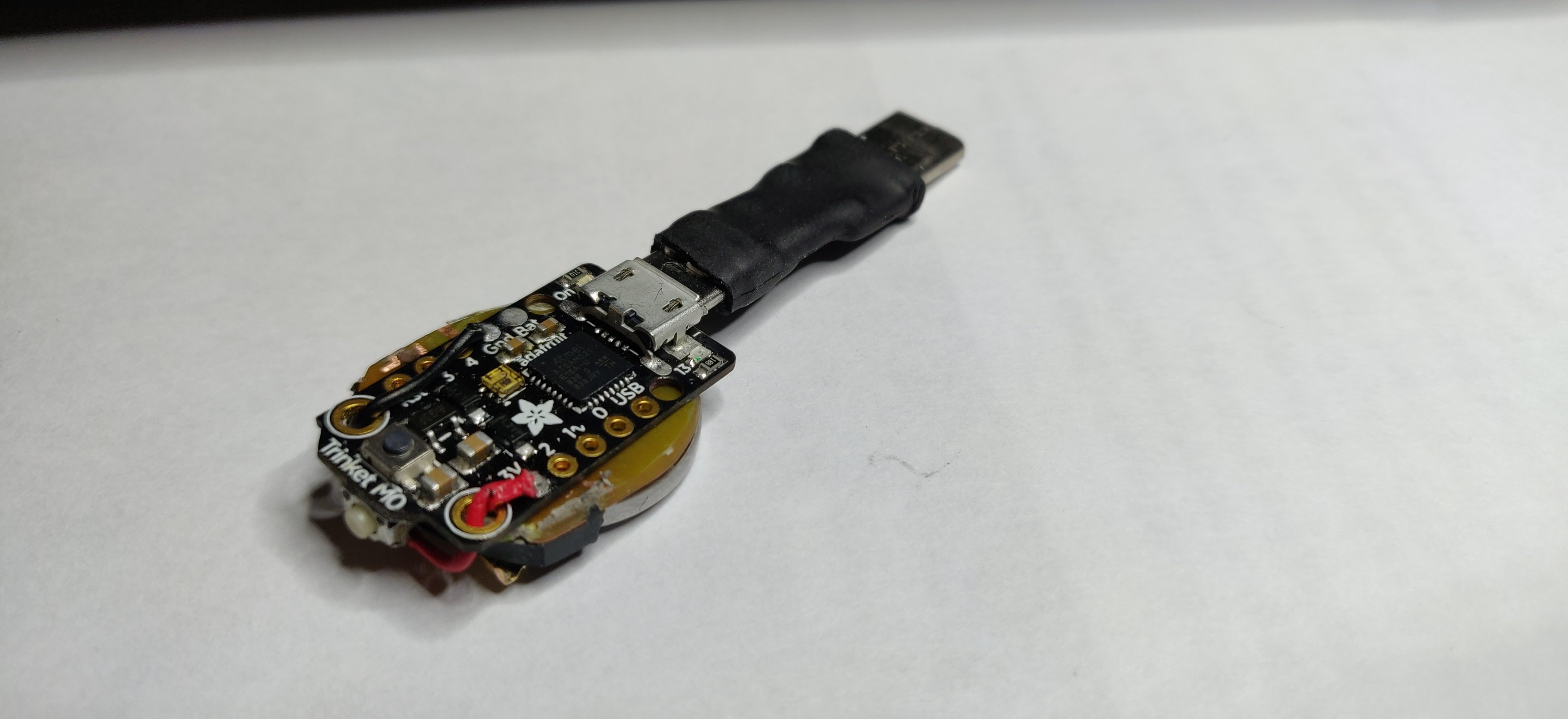

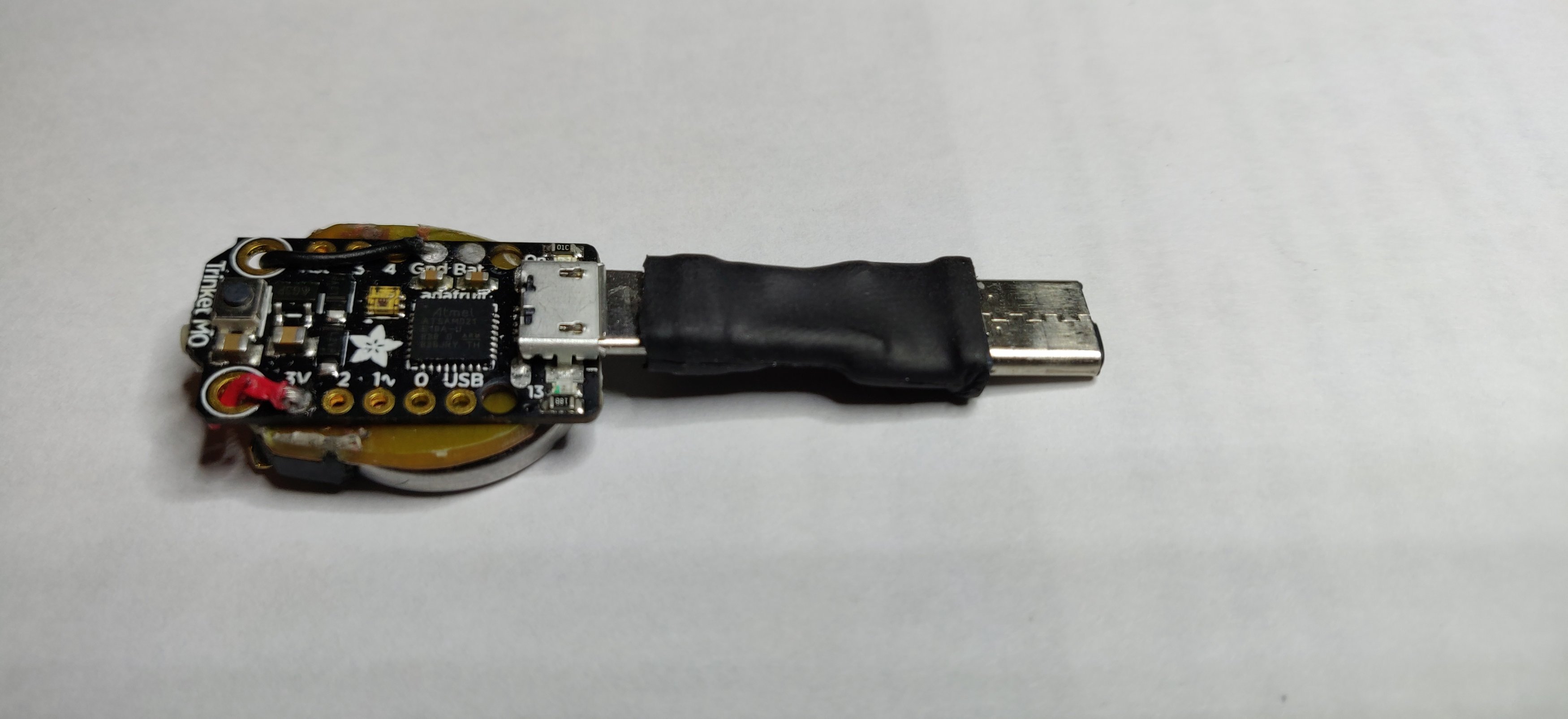

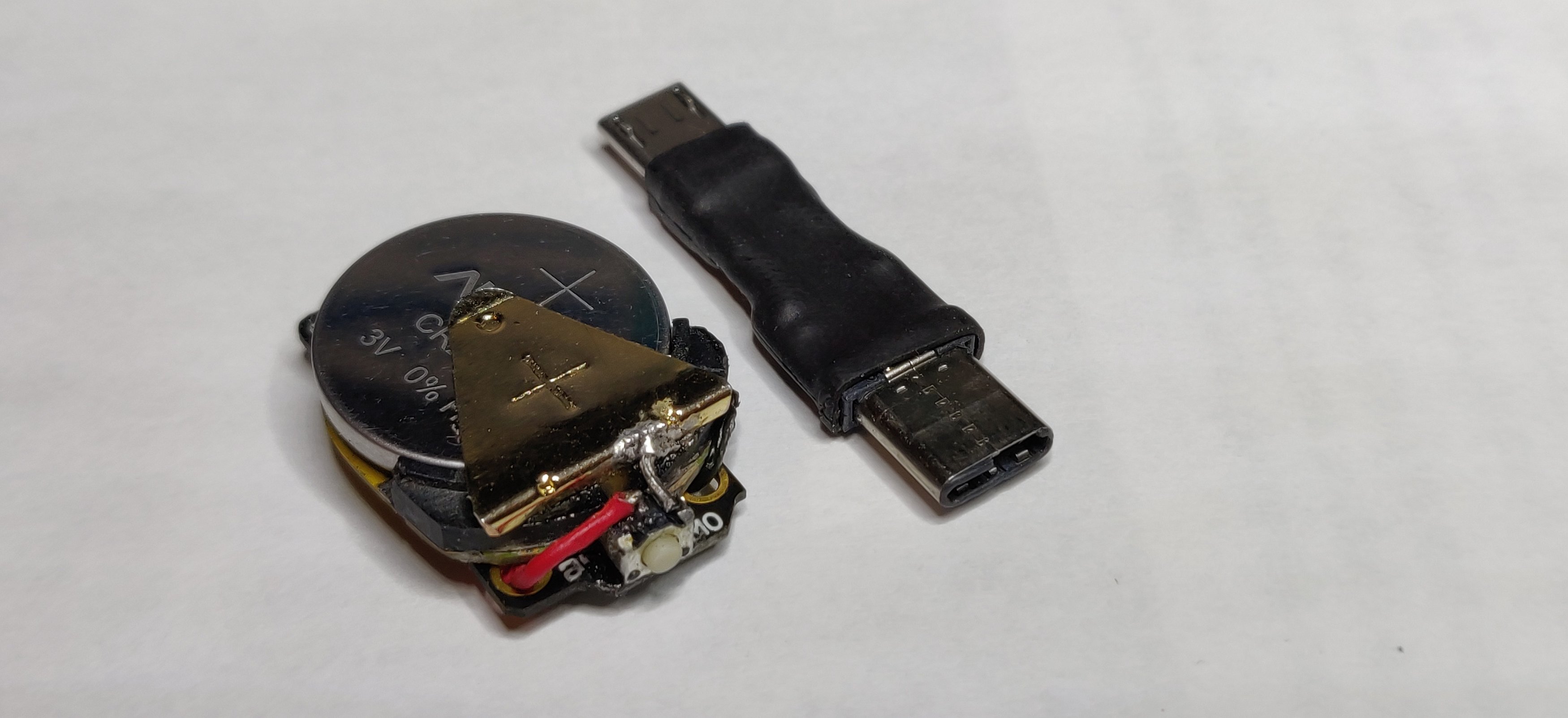

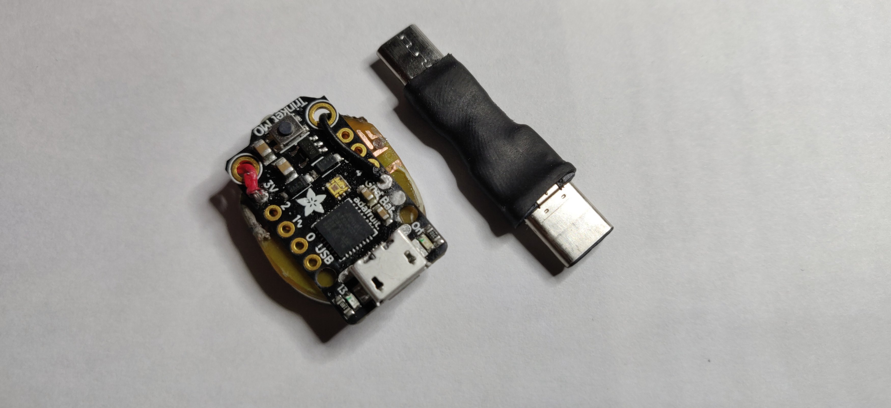

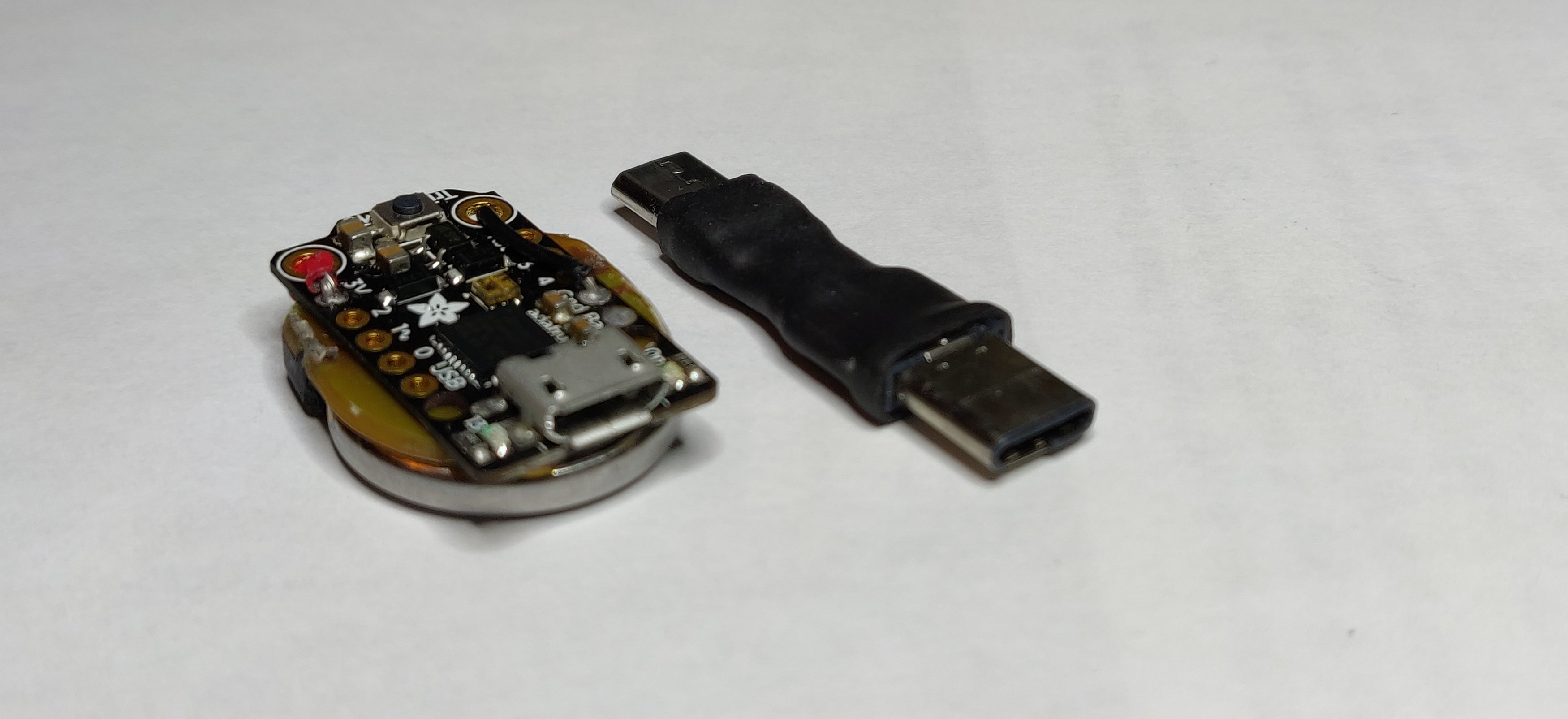

Nope. Didn`t forget. No USB power in RCM mode from Switch.
D+, D- & GND is all you need.
Batt going to 3v and GND. Thats all.
My git is organised like this...
https://github.com/mattytrog/Switchboot_PART_2/tree/master/Switchboot-V1.5.0/Switchboot Part 2 UF2
Ok its working now. thanks! Your awesome help!
