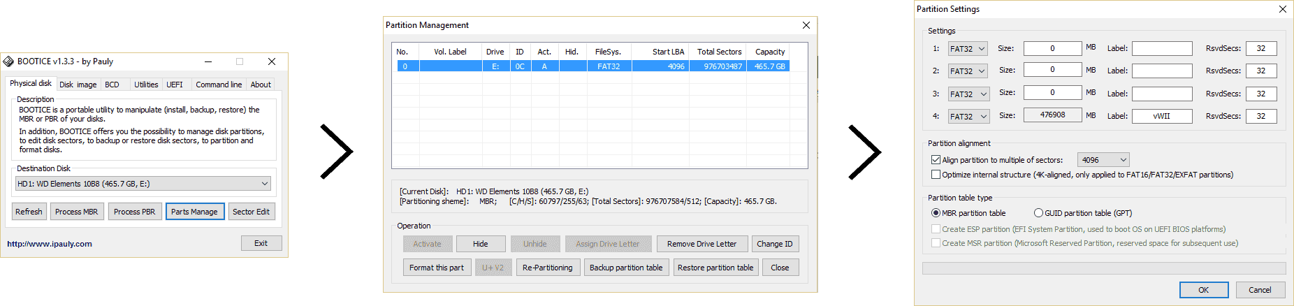

Req 2. You will need to set up your USB Hard Drive using a computer. Hook the Hard Drive to your computer and note what drive it is (ex: E: and F: are very common).
Now download and fire up the program Bootice. You will be greeted by a main screen where you can select the drive you would like to work on. By default it selects your C: drive. Select you HDD, often labeled HD1: and at the end, containing the drive letter. Make sure this letter matches the one you noted above. Now click "Parts Manage."​
You will see a second screen come up, pictured above. Here, select your partition (you should only have one) and click the "Re-Partitioning" button. Now, you will see the third and final screen of Bootice, again pictured above. Make sure all drop down boxes for partitions 1-4 are set to FAT32, all sizes for partitions 1-3 are set to 0 (this will force partition 4 to become the only partition and take up the entire hard drive), and "Align partition to multiple of sectors" is set to 4096. If not already set, make the Partition Table Type MBR, and optionally name your partition 4. See the full image above by clicking on it, and make your settings match those in the third window if you are unsure.
Once done, click OK and your drive will be formatted, set up in FAT32, and using an MBR partitioning table, all of which will make it very highly compatible with vWii homebrew and USB Loaders, like USB Loader GX.

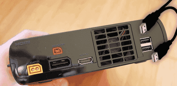

Req 3. You will need to hook up your USB Hard Drive to the Wii U properly. If you went with the externally powered hard drive, you will need to simply plug the hard drive into the Wii U using the top most USB slot on the back of the system.
If you went with an internally powered drive and a Y Cable, you will need to experiment, but typically you will want the first USB plug in the chain to go to the top slot and the terminating USB plug to go into the bottom slot, as pictured here.​

Question: I put USB Loader GX on my SD card, but it wont read my HDD, which by the way, works fine on my real Wii. Any ideas?
Answer: In what way does it not read the HDD? Sometimes things can look one way to an end user but look different to someone who knows what's under the hood.
Go through the troubleshooting below. Let me know what fixes the issue.
  • When you launch USB Loader, does it time out when searching for a USB device?
    • If so, does your HDD require an external power hookup?
      • If yes, move on to the next open bullet.
      • If no, are you using a USB Y Split Cable?
        • If no, see the bottom of Req 1 in the Section Requirements & Set Up.
    • Is your HDD plugged in with terminating USB plug in the slot closer to the outside of the Wii U?
      • If so, try plugging it into the slot farther from the outside of the Wii U (as specified in the guide).
      • If not, you may try plugging it into the opposite USB slot, but most likely, you should move on to the next closed bullet.
  • Does the HDD sound as though it is booting up and then cutting off in a fairly regular pattern?
    • If yes, the USB HDD is not receiving proper power or is not supported.
      • Get a Y Cable if the drive is internally powered.
      • Otherwise see Nintendo's supported HDD list; typically any hard drive works, but play it safe when buying a new one, as yours is not supported. Leave your brand and model number here if you can so that we can fore-warn other users.
    • If no, move on to the next closed bullet.
  • Do certain things show up in USB Loader, such as channels or Virtual Console titles, but other things don't show?
  • After completing all the above troubleshooting, you may want to make sure the drive is set for MBR Partitioning and both the drive, and USB Loader GX are set up correctly. See the sections Requirements & Set Up, Installing USB Loader GX, and Installing Games to USB Loader GX in their entirety.
There should be no situation the above does not cover.
