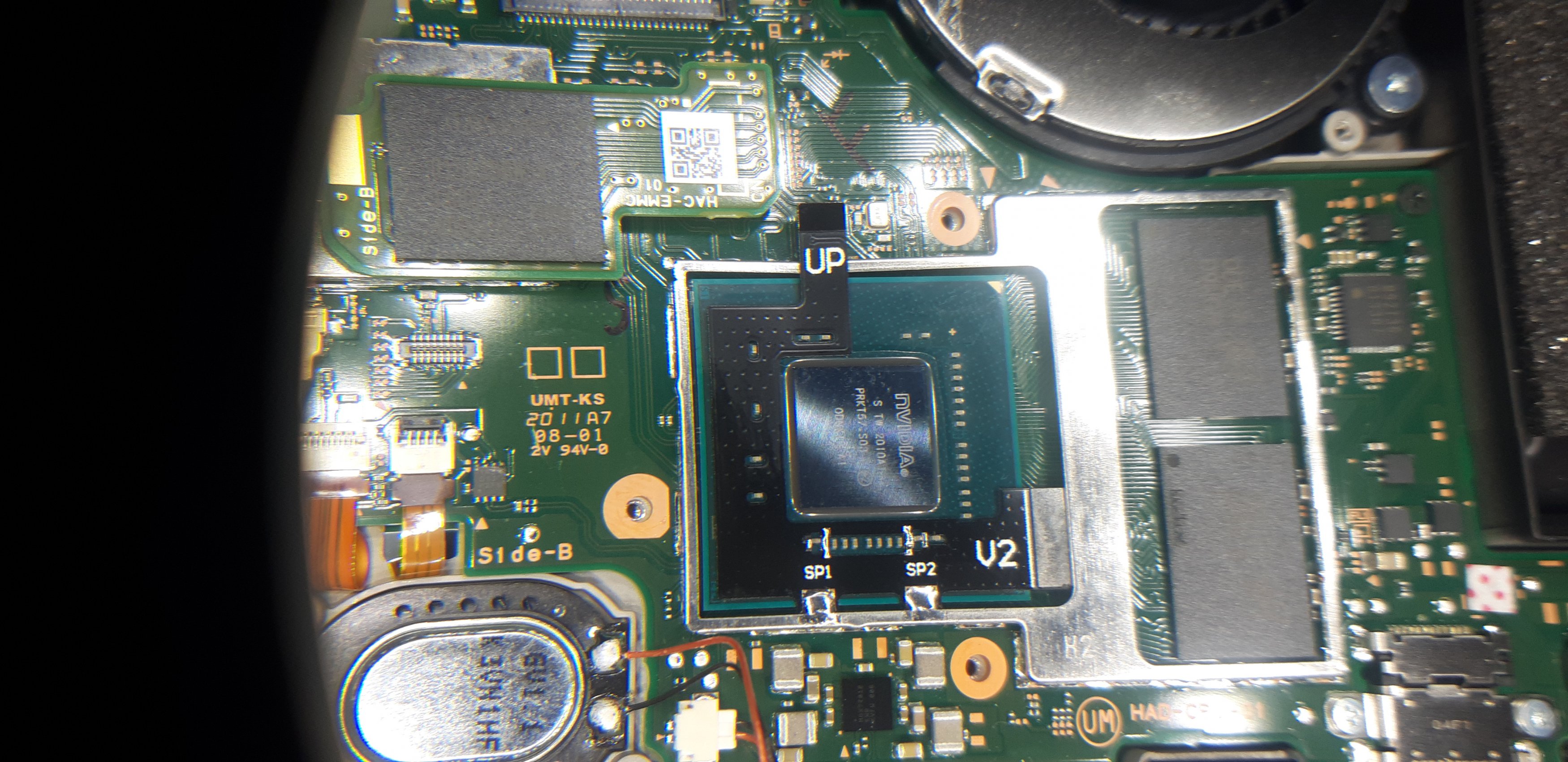

Ok but my solder points were good, and when i changed the chip it glitched green once, then the whole chip had no power
I dont think thats nand related.
Also the shorting of the 2 caps
I can remove the qsb if you think thats the issue in the morning.
But i highly guess thats the point.
Also looking at your soldering, it really looks like the red circle isn't making a good connection. Looks like it's not really connecting at all. I'm not sure if you did it again since the last time you posted pics, but that's what it looks like.
Green circle looks like it's only connecting to one pad and not both. Hard to see from that angle.
As I said before, make sure you're using flux, I don't really see any traces of flux anywhere. Also if you're not using a temp controlled iron, you really need to.

I use flux and a temp cont and a microscope :D
I cleaned the flux after, let me check these points.
but my main issue is the final cap you solder the chip to is shorted as well as the one below.
can anything from the qsb cause this
I removed the qsb completly, and both caps are shorting

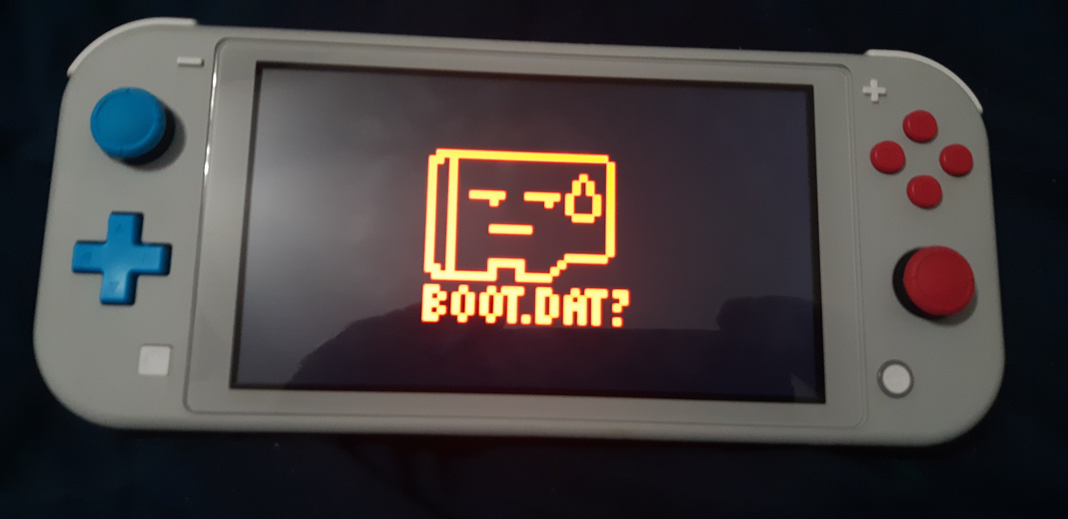

So guys i faced an issue, install was good, showed it over to several guys, attached the chip, kept getting pink pink pink, although soldering was good.
decided to unsolder thr chip, console boots to ofw normally, attached a new chip, bam got a green light and boot.dat, was getting my phone to take a photo, console restarted and glitched to pink.
Turned it off and tried one more time, the chip has no power this time and boots to stock.
Decided to test the cap for continuity and it was ok
Tested the smaller cap below found a short.
removed the chip, and tested the console, powered on and got a weird hiss sound, automatically powered off, tested for shorts on caps, and both are shorted
here is the before and after, if anyone can assist with this weird thing, as i tend to have a habbit of weird stuff happening at the end each time, and havent succeded in a lite yet
you got some solder all over the connector that your nand qsb plugs into. if you haven't already, remove that solder blob from the connector in your second pic. also check everywhere for solder that could have dripped or splashed without you knowing.

I removed the chip, and the nand qsb, and still a short at the cap that powers the chip
Ill investigate tommorow under the microscope for any solder that went to the sd slot.
I honestly forgot to tape around it before soldering, maybe something flew.
The second picture is the old chip that i replaced with a new one, that was the one goving continous pink, even after i removed that solder, i was expermenting with wired installs prior, and when i replaced with the new one, it glitched to green then console restarted and chip wasnt powering.
will update in 10 hours and see under the microscope for any solder

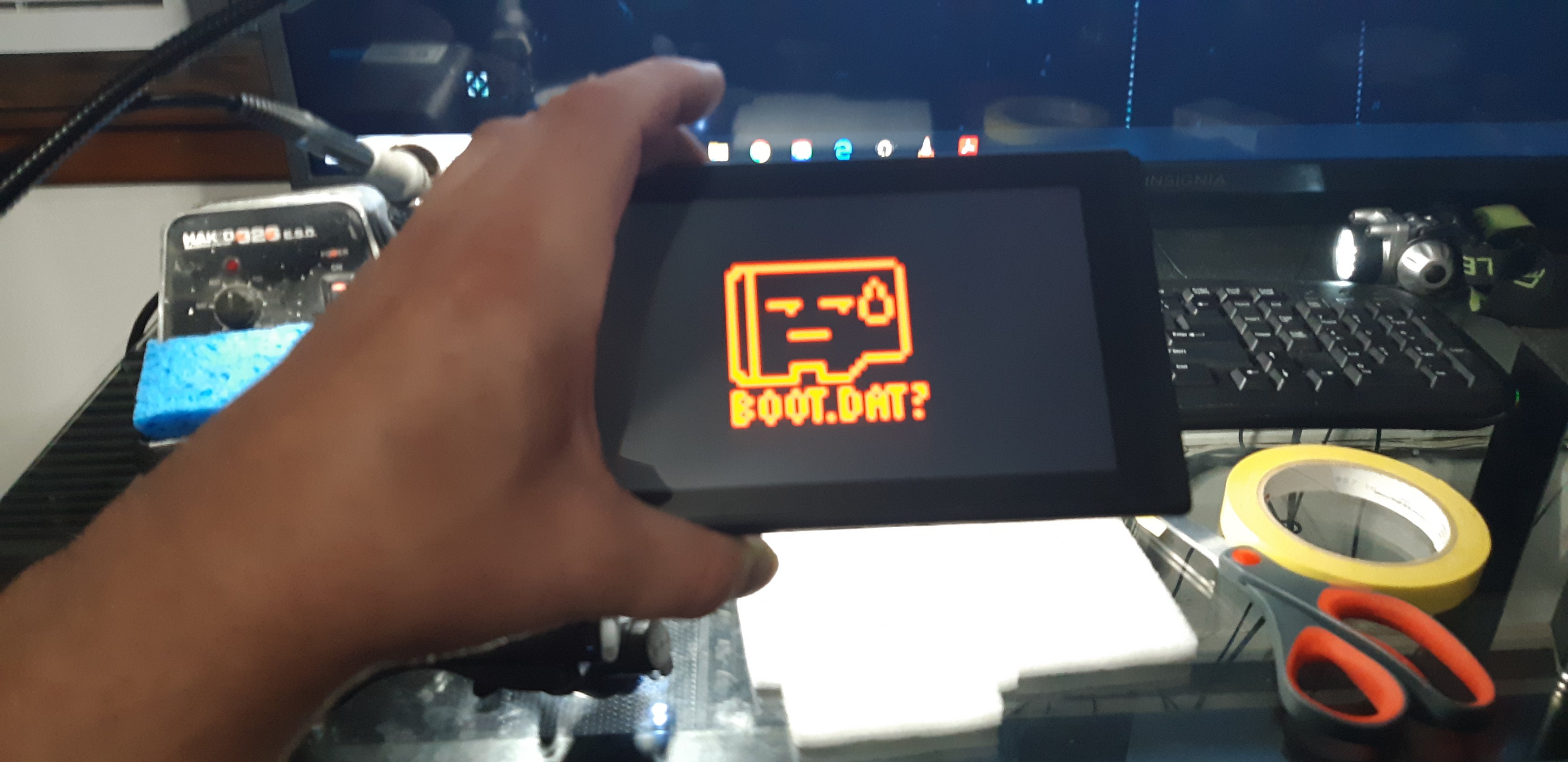

I am not sure if this has been posted already but there is a workaround for missing sd card drivers after installing SX Core/Lite (I forgot to install drivers first on one of my installs).
SX OS should boot as expected but CFW will not work until the drivers are installed. To fix it just lunch OFW and the console will try to boot but will turn off. Simply turn the console back on and it will boot to OFW. Accept the prompt to update and wait for the system to reboot. That's it, you can create emunand and launch CFW after.

Dont put the shield yet, make nand backup , copy to pc, then rename the backup on sd card to emunand, activate licence test, maybe protect the shield with kapton tape around the area where sx lite sit or the sx lite partialy on the edges.
If you already put the shield and no problems ignore.

Yea i put masking tape under and above, not risking

Holy shit that's a lot of paste.
No man , recommended by all installers to put 3 lines on the heat sink on top.
After opening the switch i honestly dont know how this processor is being cooled, with the thermal paste on the caps not cpu, and blobs of paste everywhere
