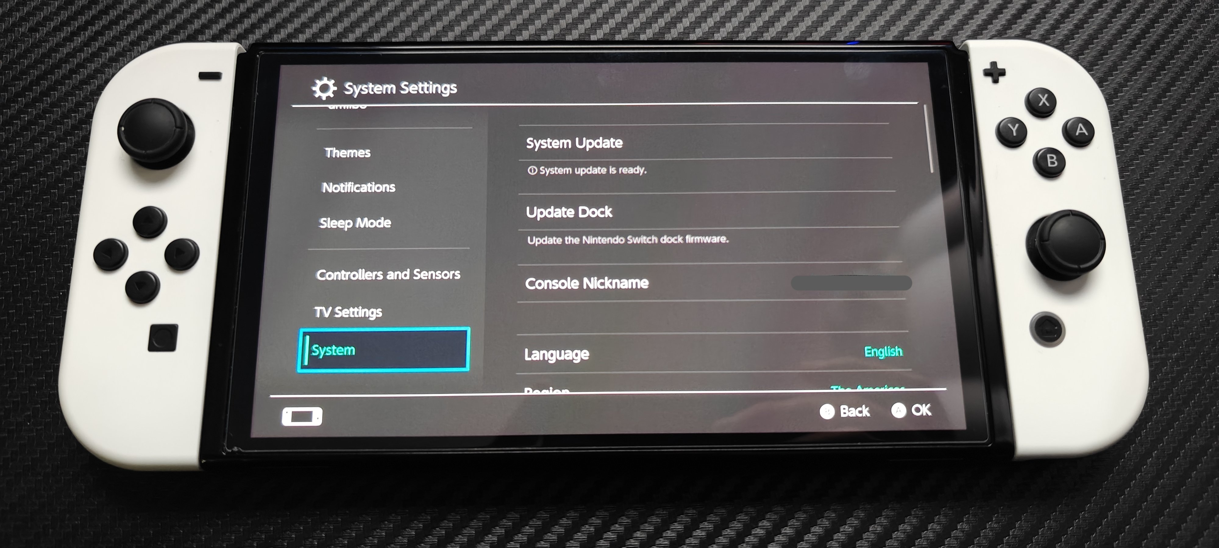

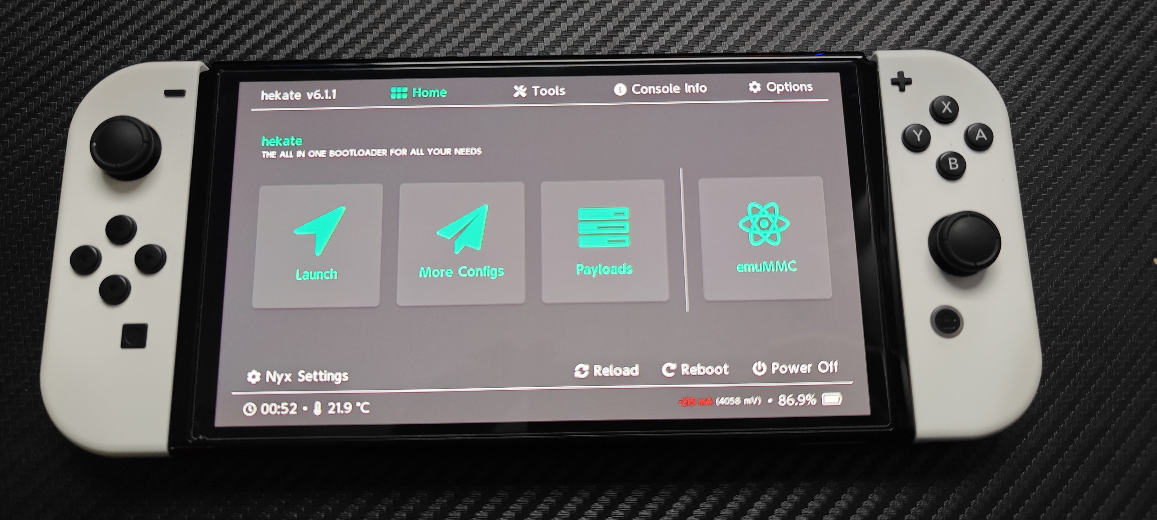

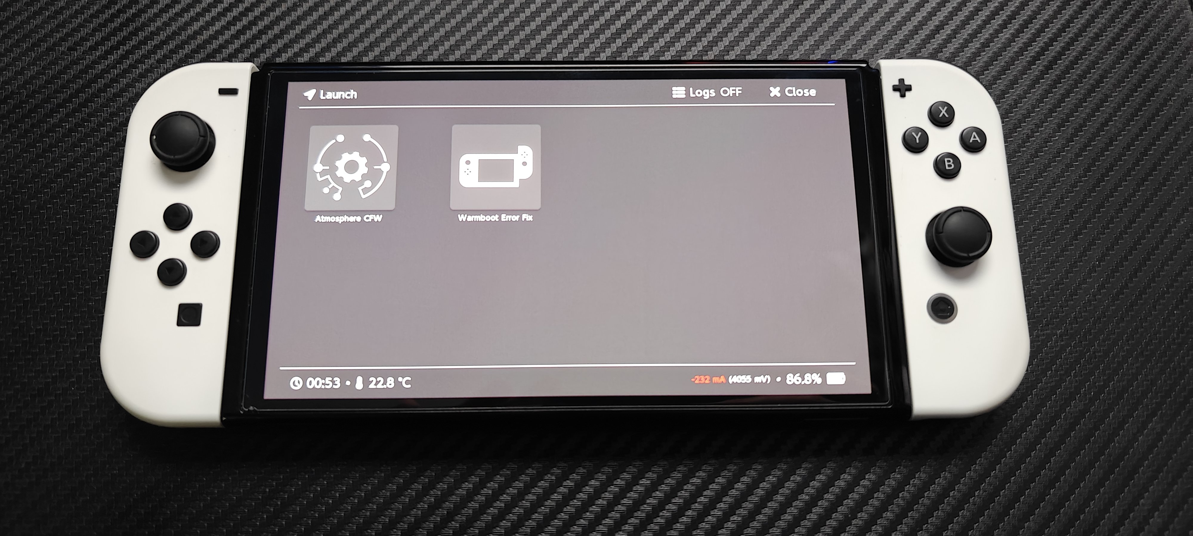

Hey there, forgive me for being only my second post. I almost have similar issues to post #43,683. My switch has been modded with picofly and it has been awhile since I have used it (approx 1 year ish).
I tried to update/install but ran into a boot error the first time (AIO Update).
Then searched into HATS (but it has moved?).
Then ended up getting to where I am VIA rentry without RCM (I do have a backup of the SD before rentry) but this time is does boot but feels incomplete... dirty...
I was going from version approx (FW 16 AMS 1.5.5) to FW18.0.0 AMS1.7.0
Could someone help me out with some information and/or up to date sources? I don't care about saving saves and game data, I rather have clean, working install.
All is appreciated, thank you in advance...
Old Hekate was 6.0.7 ?
I booted into AMS, instead of showing version... it says "System update is ready"
I've made a detailed guide about updating Switch CFW setup here.
View attachment 434300View attachment 434301View attachment 434302
To remove any pending update you might have, you can delete them by going into maintenance mode. Here you can find steps.
If you want to start from scratch, I recommend following either NH Switch guide or Rentry guide. Both of them are easy to follow.
You don't have to update your OFW to the latest if you don't plan on using it for online games that you've purchased. Both guides require users to update their OFW in order to dump their firmware files so that they can update their emuNAND firmware. You can find firmware files on a certain site that we aren't allowed to link to and update your CFW via Daybreak. Don't skip on making a full NAND backup as it's important to have it in case you brick your console.
