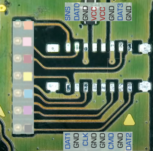

Hello, I've a NS Patched V1 with a hwfly V5 modchip installed but I'm not able to switch to hekate.
I'm stuck to Hekate - IPL screen which say "Failed to init SD Card!".
I have a 64 GB fat32 micro sd card (already tested and healthy) with latest Mariko homebrew.
I have to precise that the problem was here before I install modchip..
When I go to sysnand mod, and I try to boot up with sd card plugged in, It just freeze at "Nintendo".
When I go to setting system and I put the card in the slot, It's freezing..
I've already replaced the sd card slot but nothing..
(Fpc connector seems good aswell)
If anyone can help me, this will be really cool

If you tried more than one SD card and you replaced the SD card flex on the board, then the problem is pins on the board, you have a short circuit where one or more pins doesn't work.
I hoped this wouldn't be a short
Thanks
So you think this would be a short on the FPC connector ?
I don't really know where to start, I wonder I have to check pins with continuity mode from a multimeter

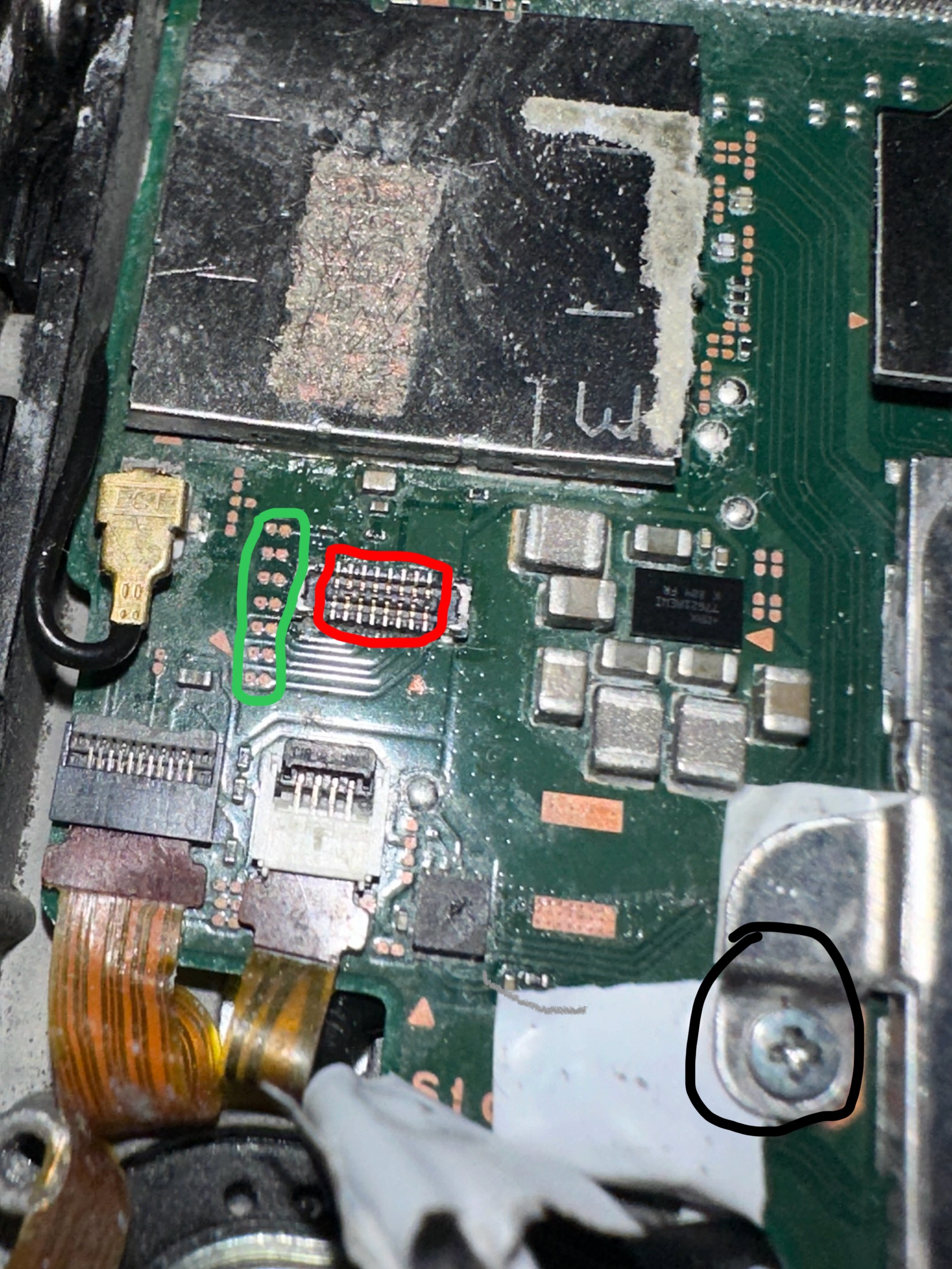

Use a multi meter
First, I disconnected the battery
I tested the green area with the ground (no beep), but seems some of pins from the red area are beeping
Sounds like this is the problem but I tested caps and resistors next to the area and they are beeping too
If FPC wasn’t the problem, I guess It wouldn’t beeping right ?
