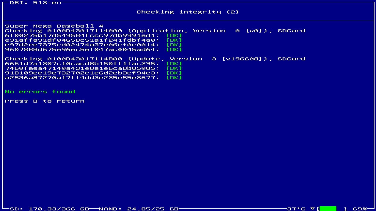

can someone help me, just updated to 16.0.3 with atmosphere 1.5.3, ive been trying to install this nsp file through different means such as nut, awoo installer, ns-usbloader, and dbi and the screen is black when starting up. i updated my sigpatches and checked the integrity. is it on me or the file is bad ?

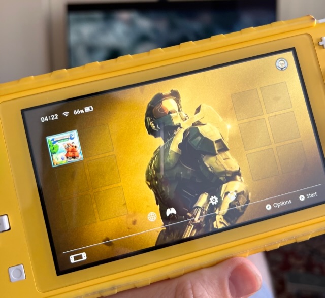

Guess it's a paperweight now. Uninstalled the chip, the console doesn't show anything on the screen when I press Power button or insert the charger.
I was actually able to fix it!
Reinstalled the chip with better wiring, replaced resistors on CMD and DAT0 lines with 100 Ohm ones, which fixed the slow eMMC warnings, and performed NAND rebuild which fixed the pkg1 error.
I can see you haven't tried TinWoo Installer. Its what I personally use and I have no issues. Try using that to see if the issue persists.
