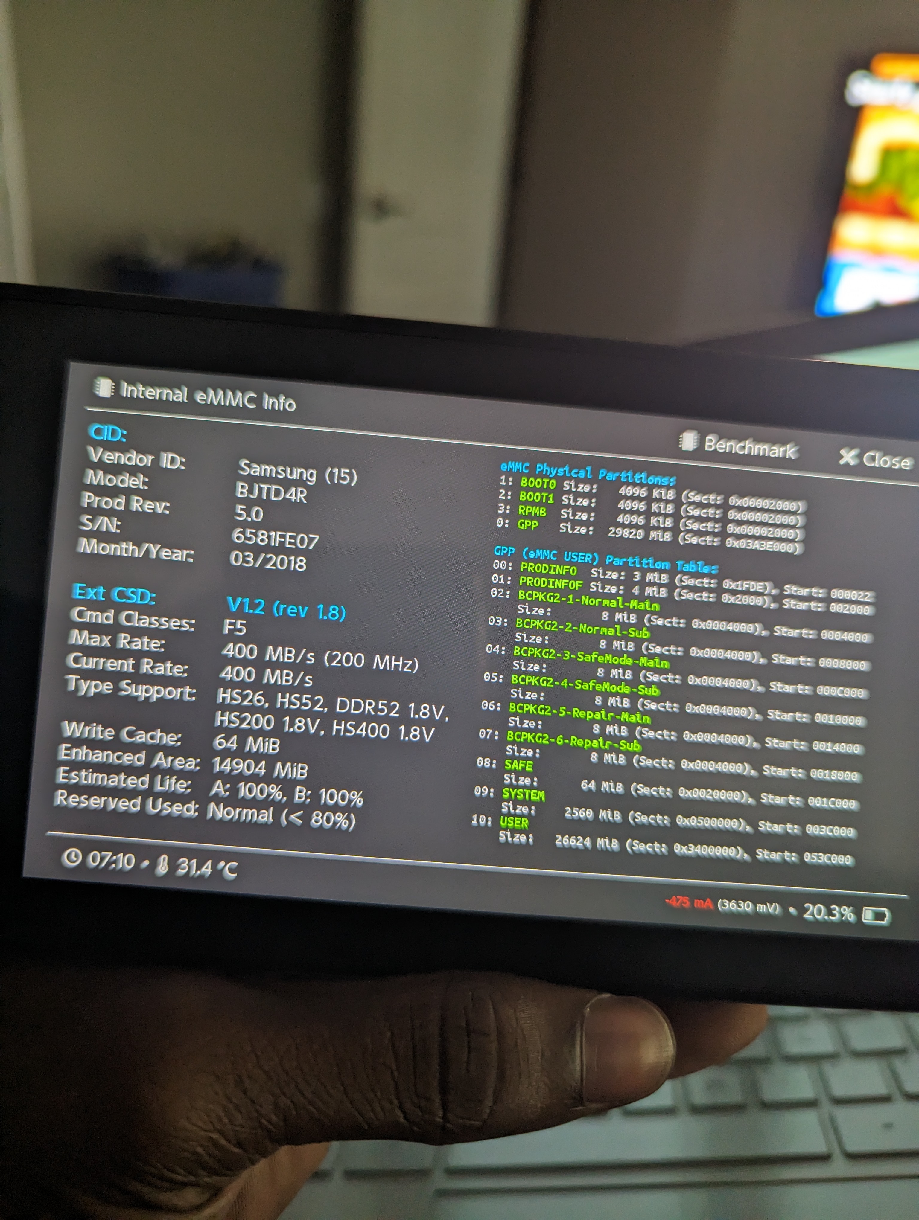

Check under hekate and see what brand emmc you got.

Check your soldering, SK Hynix have the slower mode issue.
Does the slower mode issue makes the Switch unusable? I don't think I can even boot into the normaI firmware either. I shipped this across the country to get modded, so if its a soldering issue I fear I will likely have to ship it back. Should I tell him to change the emmc to a different brand?
It can mean the emmc is dying, usually SK Hynix have this problem not commonly for Samsung emmc. You have to open it up and check if any components is damaged or anything is bridged.
Another question. Is it possible I have a Nand issue that is causing these problems? I am unable to boot up the Switch in Sysnand and the OFW as well which is strange to. I simply get the Nintendo logo, then a black screen. At this point it practically feels bricked.
Is it possible that my boot 0 is corrupted, and fixing this could solve my problems? Should I be trying any specific unbricking guides, or do my specific issues not point to any of these fixes?
The problem point to the emmc module, it is a physical hardware problem if the emmc is dying.
