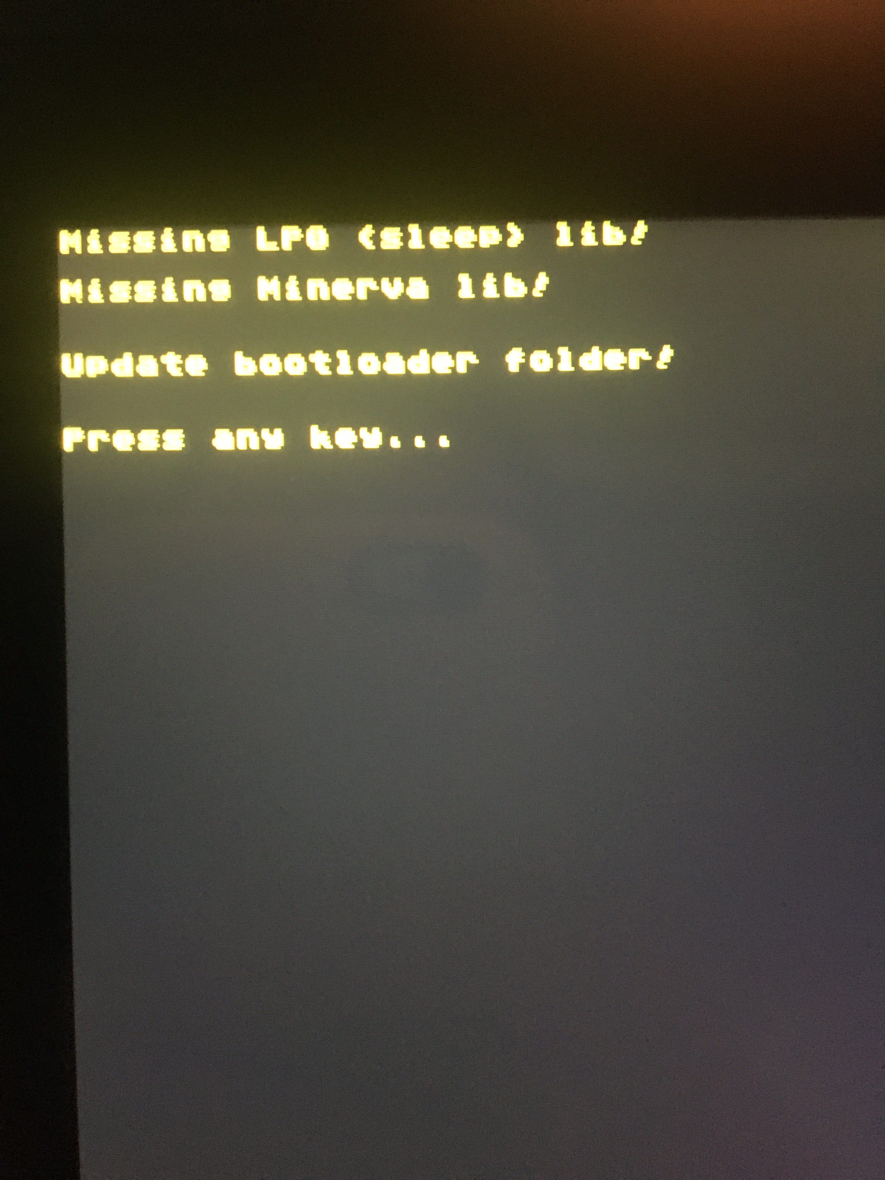

Got Switch Lite with freshly installed picofly, getting an error trying to boot emunand: Package1 seems corrupt!
When trying to boot Warmboot fix:
When trying to dump package1/2:
Picofly is flashed with latest firmware 2.73. It flashes red shortly when I turn on the console and boots into hekate.
UPDATE:
I also get this on eMMC info page:
Is there a way to fix it?
Guess it's a paperweight now. Uninstalled the chip, the console doesn't show anything on the screen when I press Power button or insert the charger.
