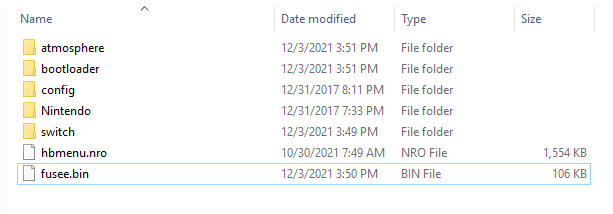

yukumo06
Dec 12, 2021
10
33
97
Philippines
hi. I just recently bought used NSW with already installed atmosphere. I'm trying to make backup of my sysnand but I cant access hekate. every time I restart the switch its autobooting directly. I already tried pressing volume - while booting but no luck. and I try booting without SD card but it says.
A fatal error occurred when running Fusee "failed to initialized the SD card: 0x00004a18.
attached file is the content of my SD card.
I'm new in this kind of stuff and I just want to make a backup. thank you guys.
is this a chipped switch?

Chaosta
Sep 18, 2020
595
744
no. everytime i restart im using a white dongle thingy with atmosphere. sorry for lacking my knowledge about this.
your white dongle has the fusee payload probably. inject hekate from pc using tegrarcm, from phone using rekado. or put this deepsea toolbox in switch folder, open hb menu > deepsea toolbox and should be able to boot to hekate from there(assuming hekate payload is on sd)
