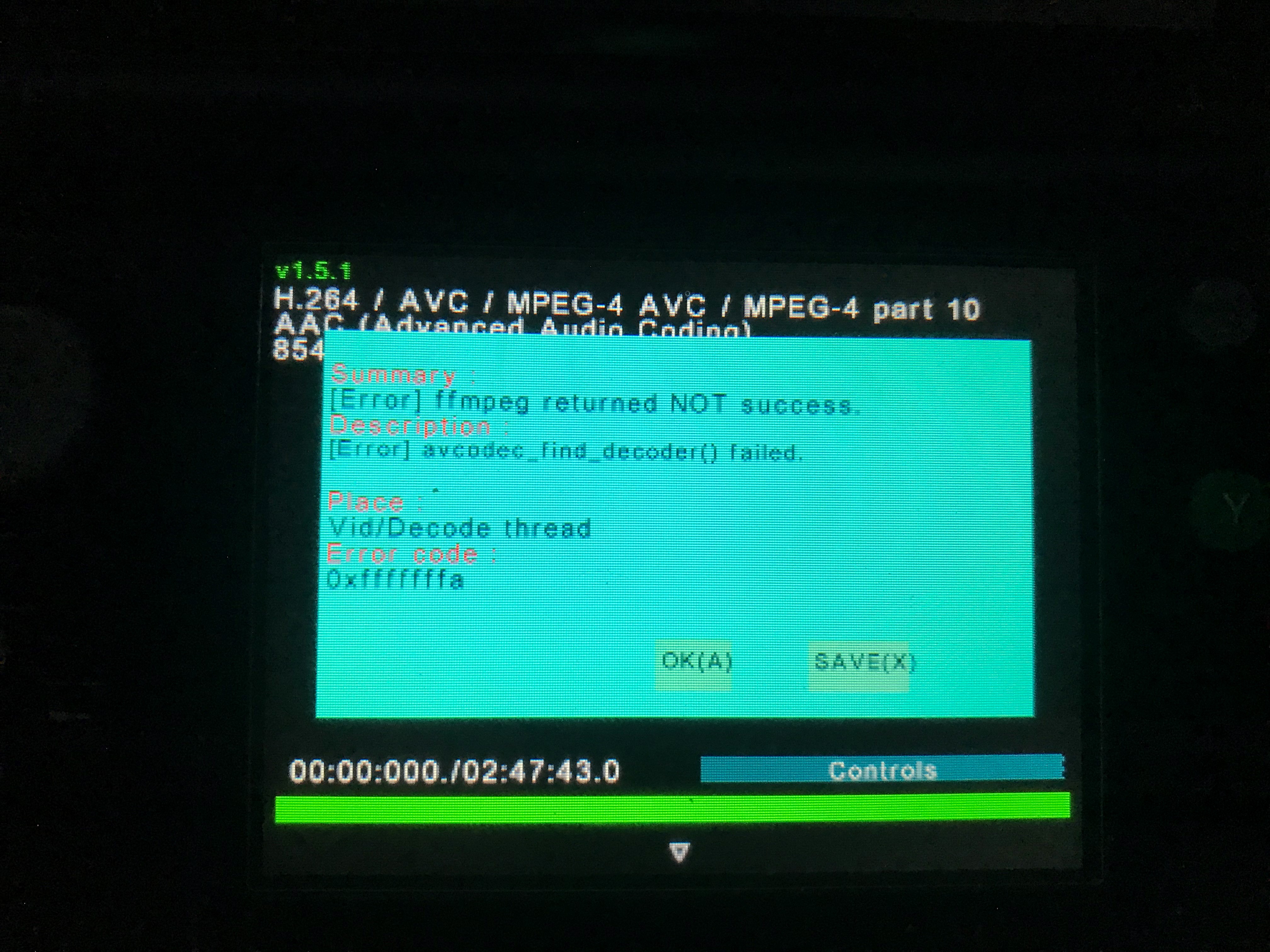

CrashMidnick
Jul 22, 2015
737
41
2,883
France
Thanks for this update :)
However pretty much all my movies are not working anymore, see error below (N3DS, latest luma + patch) :

CrashMidnick
Jul 22, 2015
737
41
2,883
France
I reinstalled V1.4.2 and all is back to normal.
V1.5.0 + V1.5.1 are not working well for me : slower on O3DS and some videos unplayable, 90% of my videos are not working on N3DS.

CrashMidnick
Jul 22, 2015
737
41
2,883
France
Can you provide a 30-second sample of a video that doesn't work? C2E may not be able to fix it without looking at a file that triggers the problem.
Well, I will contact C2E as this is copyrighted. But there is nothing special, It seems to be a codec problem with H264.
What are you using on your side ?
I converted about 50 movies (30 for the N3DS, 20 for O3DS), with the same software, the same day with the same settings (854*480 for N3DS and 144P for O3DS). They always worked until 1.5.0.
Today I converted a movie with the same software (format factory, windows) = same result
Then I converted it with ffmpeg using the very same settings of this thread :
ffmpeg -i "D:\Films\Alien 1.mkv" -acodec copy -vcodec libx264 -s 854x480 -r 30 -preset fast -profile:v baseline d:\Alien.mkv
Same result...
Finally I used my Mac and used two softwares (videoproc and AnyMP4 converter) : This is time the video launched but it was laggy as hell, even with a low video bitrate.
All those output files work with V1.4.2

CrashMidnick
Jul 22, 2015
737
41
2,883
France
A sample that's < 30 seconds is usually considered fair use, but you can use a free video if you're worried about that. I used Llamigos for my testing:
http://www.caminandes.com/
Download that, encode it the same way you encoded your other videos, and see if the 3DS can't play it. If it doesn't work, you can send it to C2E for analysis.
Note that if you're encoding for 3DS, you shouldn't be using 854x480. The 3DS screen is 800x240, so that's the highest resolution you should ever use. If you want your video to be 16:9 in 800px mode without having to crop or stretch it, encode at 800x224 with SAR 1:2 (400x224 upon playback, which is as close as you can get to 16:9 on the 3DS).
I took the 1st video and it worked. But some videos I converted before work too.
I will send a sample of a non working video to C2E, for sure there is something wrong in the code because it was working flawessly before.

CrashMidnick
Jul 22, 2015
737
41
2,883
France
Can you give me your settings file too?
It's in sdmc:/3ds/Video_plaer/vid_settings.txt
Please see attached file.
I converted all my movies from 854*480 to 800*480 and now they are working fine on N3DS. I did not test 144p movies on O3DS at the moment. Very strange as the other working videos are 854*480 too.
