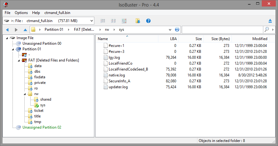

See if you still have your real copy of the SecureInfo_A | B.
1A. GodMode9 → [S:] SYSNAND VIRTUAL/essential.exefsMount as EXEFS image.
2A. [G:] EXEFS GAME IMAGE/secinfo Copy to 0:/gm9/out.​
or
1B. GodMode9 → [S:] SYSNAND VIRTUAL/ctrnand_full.binCopy to 0:/gm9/out.
2B. IsoBuster → FileOpen Image Filectrnand_full.binFAT [Deleted Files and Folders]rw/sys/SecureInfo_A | B
  • Look for the portable version of IsoBuster...
