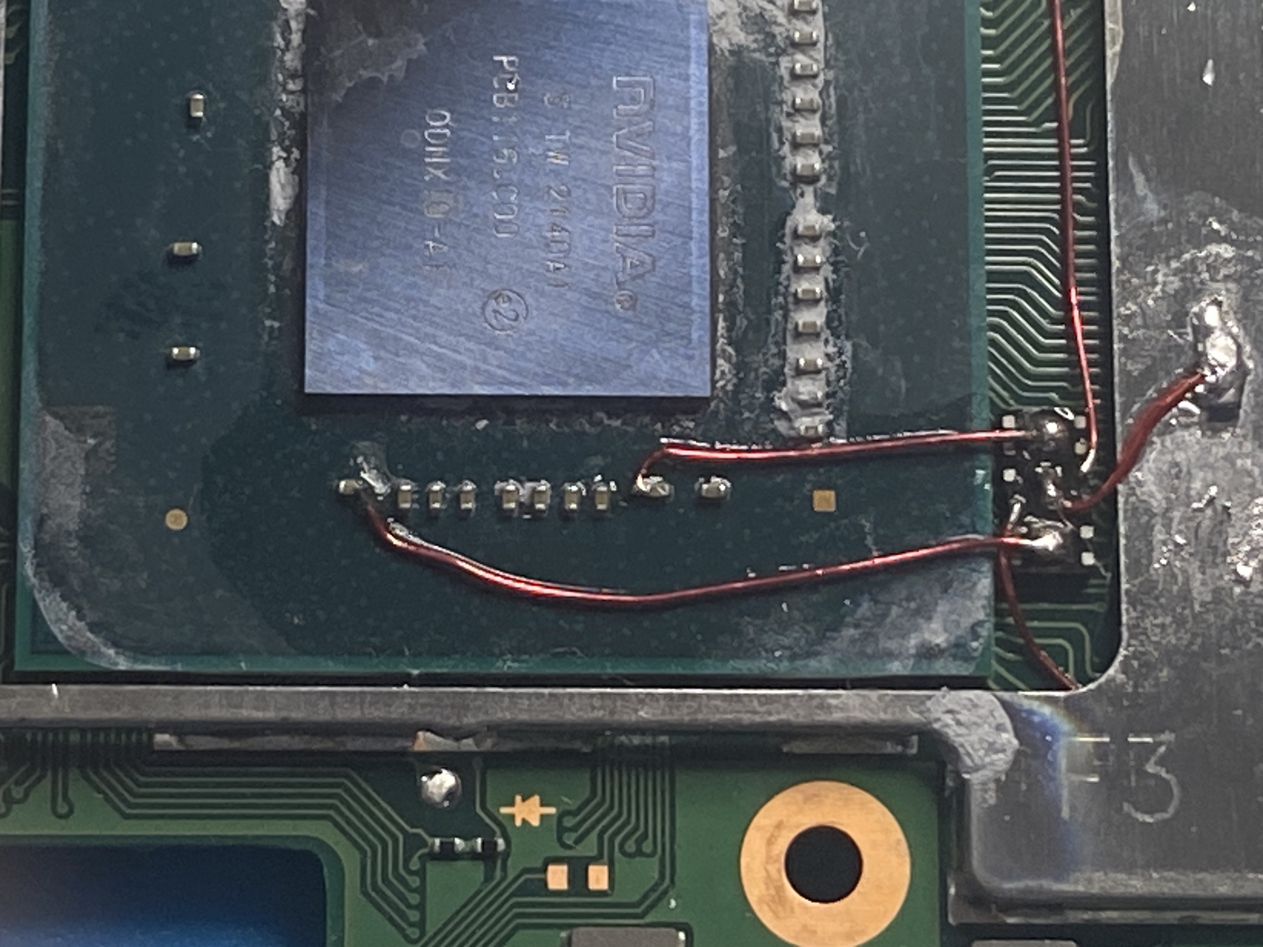

My first post-APU grinding Switch OLED. Works like a charm, and glitches in less than a second. boots into hekate.
I used the shield as GND. Won't be touching anything in the APU other than the two caps. Lesson roughly learned.

Thanks but it's tough getting solder into that point, and psychologically I just don't want to touch it anymore. this is how I do it now and it works great. Thanks

Yes. He went on and on about how good his grinder was and that he "can't work without it" So Logically I thought it was the solution to any tough solder point.
