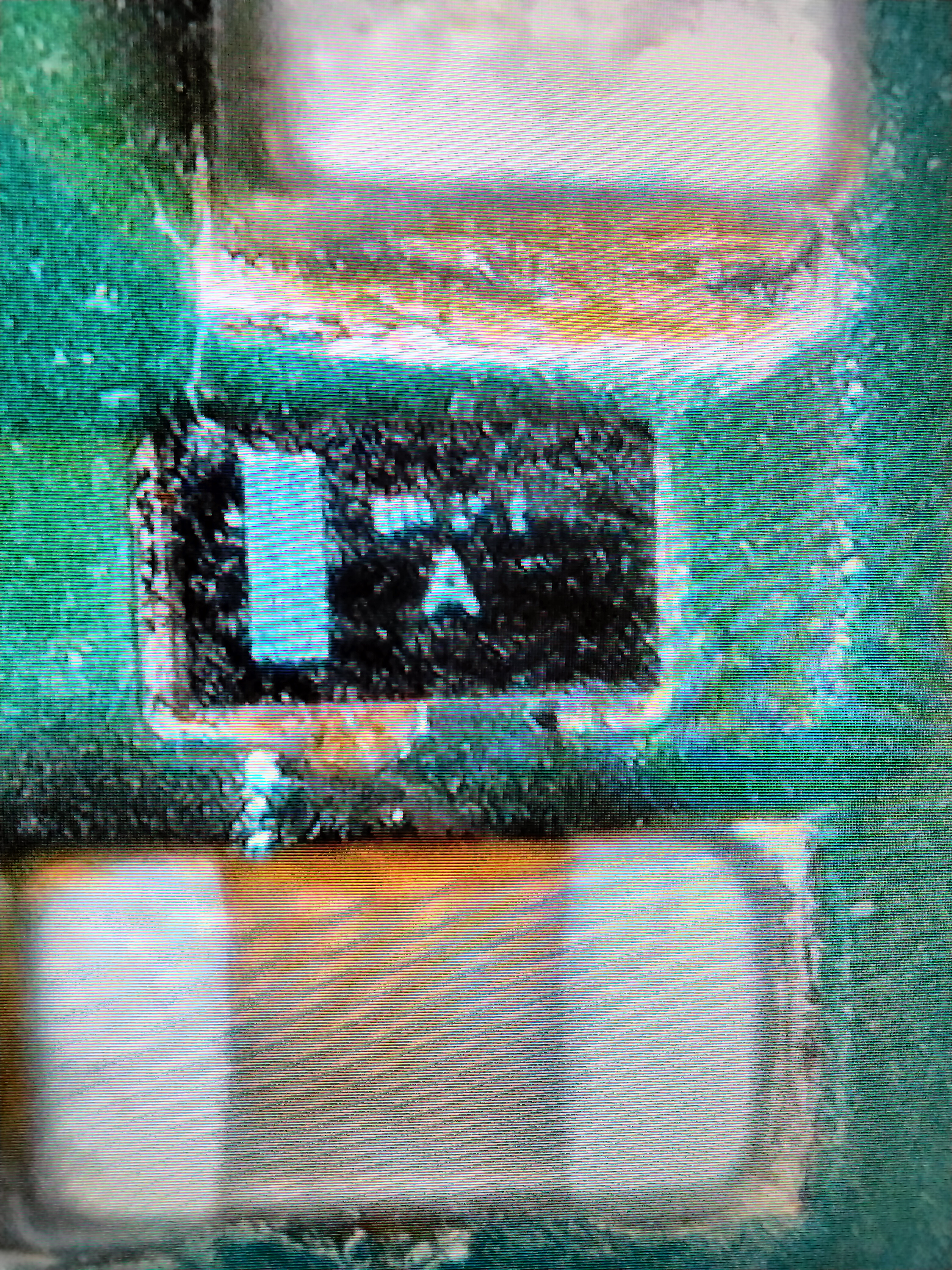

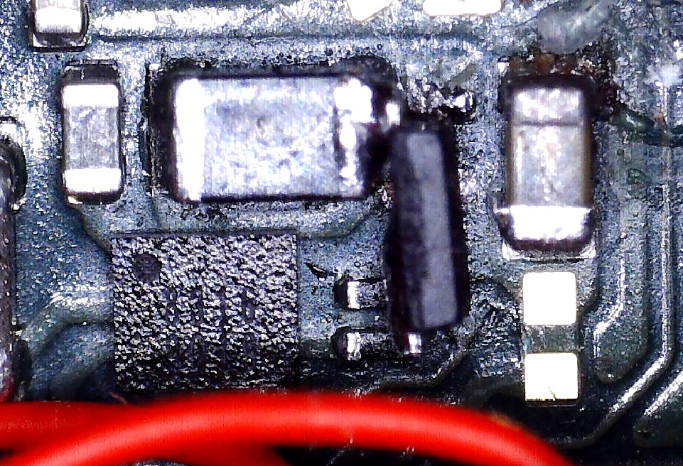

I don't know if you saw the post earlier but i think that the missing diode is 5.6V 200mA Schottky (based on the circuit)
I guess these points and this "technique" were developed to better secure the flex cables with which the mod was originially designed. Fifty thousand pieces used to be soldered like that... Now they are just Ghost Mods... :P
Hope you're right. Will order it now and I compared the size to be a 0402 (Imperial code). Thanks 👍🏻.

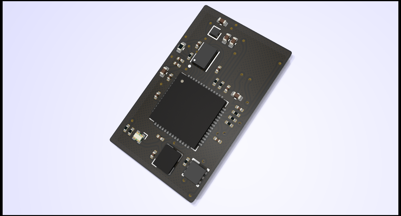

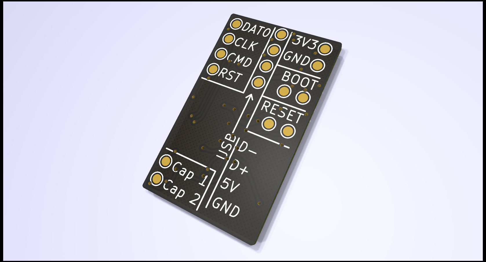

Here is a rp2040 + dual mosfet board, it's untested at the moment, I'll get back to to the thread once my boards have arrived.
It measures about 14mmx 25mm from memory
https://drive.google.com/drive/folders/1lldumDr7aOpNCwfE2Vw_DBWkPrt6qRWx?usp=drive_link

Thank you @QuiTim !!
That makes sense. This seems to be a DCDC boost for the backlight.
( also that probably means it's a little under-rated :P )
@QuiTim I think you asked about that diode?
Well - I can confirm that a 40V 2A Shockley diode works in it's place!
What I had on hand was too big - so I had to improvise - but it works perfectly :D
Thank for the replay bro, I know @Takezo-San was having the same issue so I wanted to point him on the right direction. Maybe he can order some of these as well in case the small one does not work.

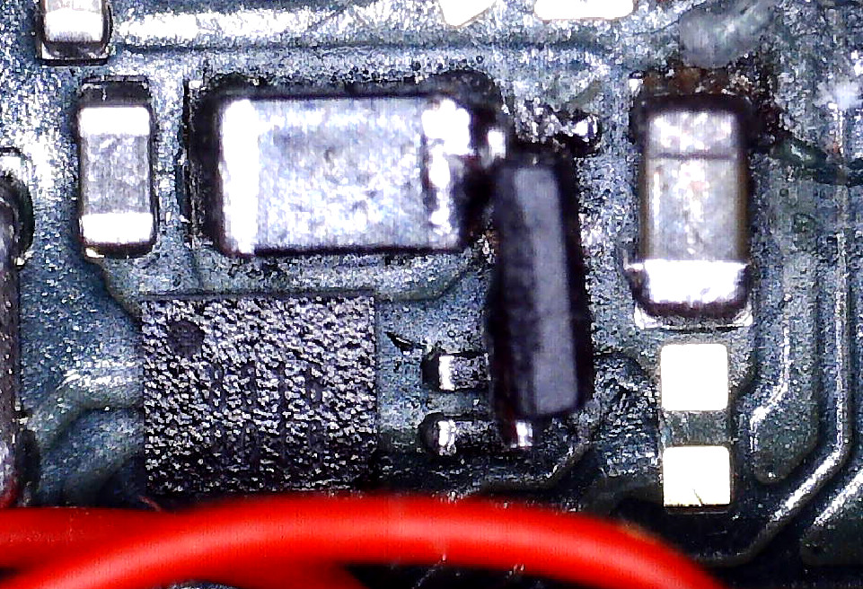

Wait wait wait. So you installed that diode and......Blue Screen gone!? Can it be!? Naniiiiiiiiiiiiii!!!!
I took mine off because I thought I saw a bridge from the nearby cap and it literally slid off my multi-meter probe. So I'm replacing this now but I'm not sure what it is exactly. 8A!? Fuse maybe!? Either way, taking it off and booting up now has a black screen oppose to a blue screen. Who knows might be the culprit because blue screen is, in my experience, to do with shorts (amongst other problems). Going to find this component (that was probably damaged) and then check. If normal boot works again then that LITE ground point (on the cap) is too risky (for me anyways) and will just reinstall RP2040 with a new ground point (like on top of USB-C charging point or something). Any clues as to what this component is anyone!?
Here's what mine looks like:View attachment 374736
Doubt it'll help though :\
I think I finally got the bastard
