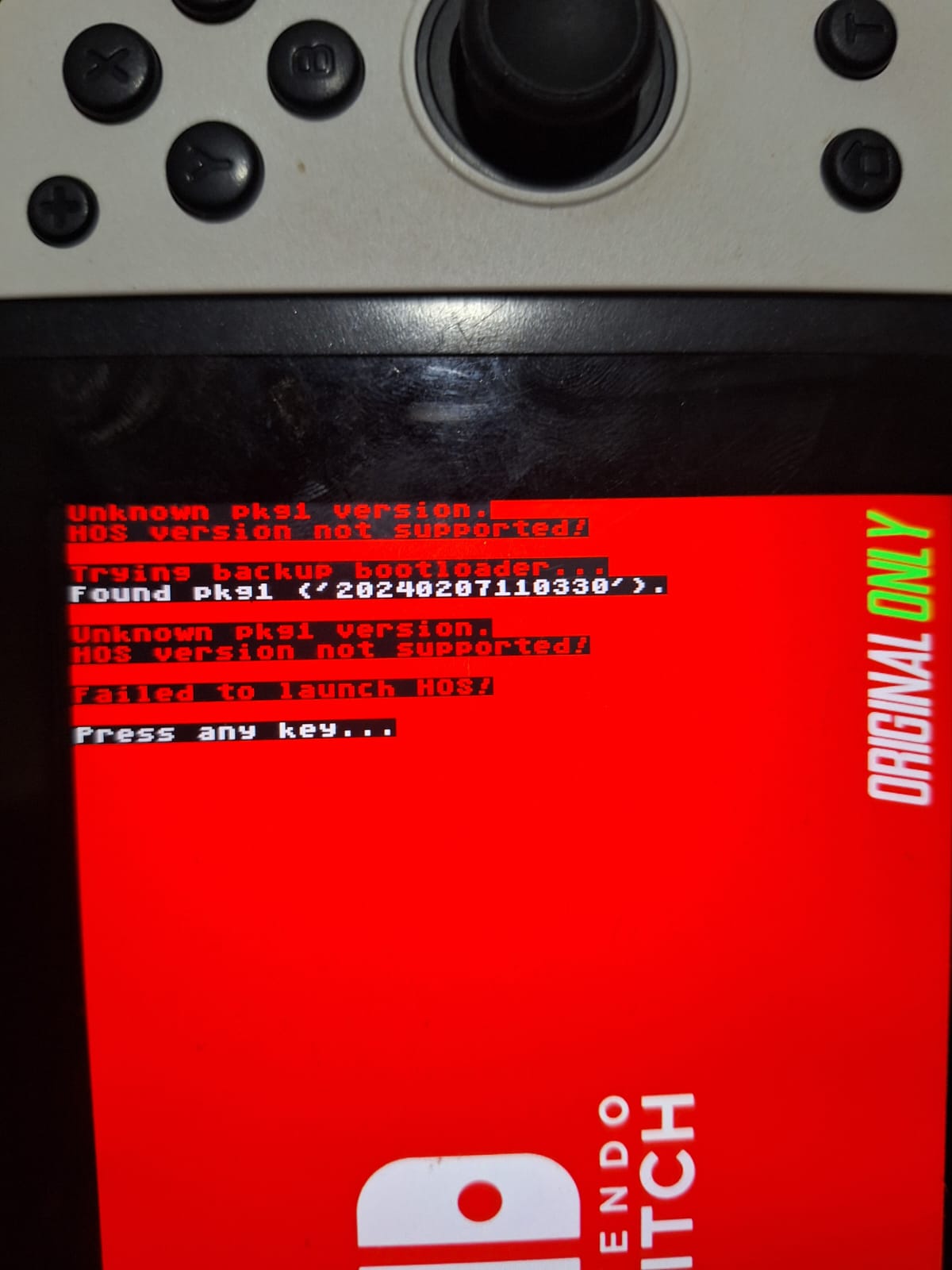

I got attached screen when I started my switch oled after installing modded motherboard from aliexpress and idea what might be the problem. Note that I got green light on modchip

mindkiller89
Apr 14, 2024
5
34
15
Now that for some reason after letting my switch battery die... I got fully black screen with no green spots like the pictures I attached. Also the joycon and touch screen are responsive. Sound is great and I can hear my self moving around. I spoke with seller(aliexpress) that I got the modded motherboard from and he asked me to return it because it might be bad connector. Is it possible, to have such symptoms for faulty mother board or lcd connecter?? Should I return it or Try to fix the screen? I'm confused
