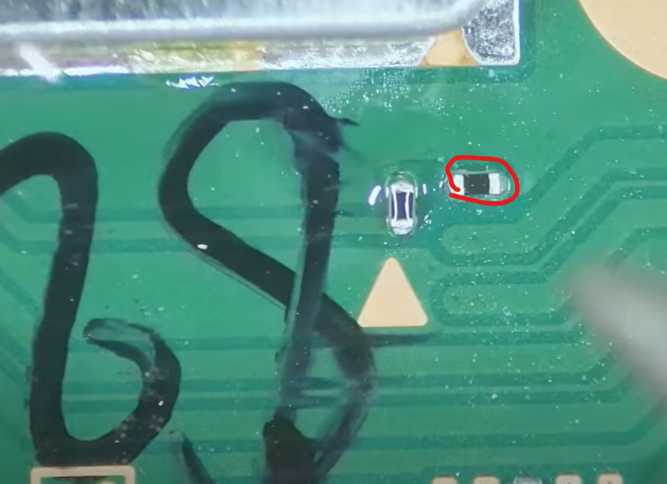

Yea trying to figure out what may be wrong. I'm picking the switch up tomorrow from the shop. as of right now the wiring is still in place I asked the installer to remove the Pico and flex cable for now but leave the wiring and I can work on it from there. I just need to get it working again so it will boot like normal then once I know its booting like normal reinstall the chip and confirm that the flex cable is truly working or not.
I'm assuming I get the CYAN light because the switch wont actually boot right now even normally so something else is wrong after I can get it working normally again That will let me know if the Flex cable is good or bad.
When they installed it I know they said they had accidentally knocked off this resistor but was able to get it back on not sure if this is the reason it wont boot maybe this was damaged.

That should be 47k 0201 resistor and they don't like the heat very much
Once I pick up the switch tomorrow I can describe more of what's happening and then get photos of the board to post.
I took it to a chain shop here that does micro soldering and cell phone repairs they replace BGA and do all kinds of other things but it seems something got messed up but we're not entirely sure what that one resistor is the only thing that we are aware of he looked at it under an infrared scope and didn't see anything heating up red hot indicating a damaged component.
