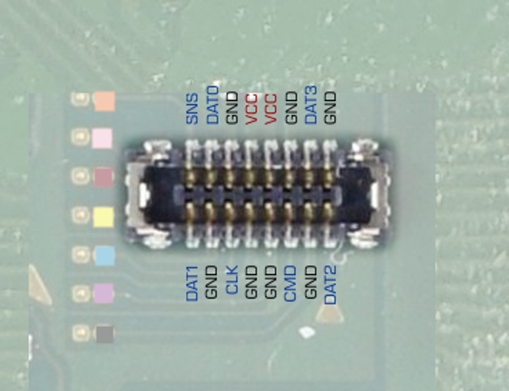

When the sd card runs in 1 bit mode, it only uses DAT0.
Either DAT1,DAT2 or DAT3 can be disconnector.
Someone posted this image in case you want to check with a multimeter which pin(s) might be causing the problem"
Thank you both, I have:
resoldered the DAT points, look pretty solid to me.
Rechecked all points. Pretty solid too.
Cleaned it with IPA twice.
I'm thinking maybe the board reads it as one bit since the connector is removed, but maybe functionality is ok? All SD card info is shown in both hekate and main screen.
Say that only DAT0 is connected, what limitation does that give me? I was able to download Tinfoil and loaded a game into SD card, and take a full-nand backup. Speed is 400mg , all works fine. Was that not possible without other DAT points?
I have no personal experience with this issue but if it works then i guess it's job well done.
The error might be because of some difference in resistance/conductivity of the wire

So I have an oled and picofly with a oled flex cable at the time 2.67 was the firmware available and was flashed I took it to a shop to have it installed they where able to get the picofly installed and have the cpu connected to the 3-4 pins on the flex cable but it seems to boot blue then cyan.
if we remove the 3.3v and gnd from the picofly the switch powers on but doesn't boot with the power on the pico it will flash blue then cyan .
so this indicates that something was messed up but we are not sure what to look for anyone have any ideas
cyan is cpu kabel or mosfet
I was thinking I might possibly have a bad flex cable but we where testing to make sure the board wasn't messed up shouldn't removing power and gnd form the pico (Basically powering it off) allow the switch to boot unmodified.
Would anyone happen to know the correct diode values of each of the points?
the only one I can find is for the Dat 0 stating it should be between 0.500-0.800v which it is

yeah its def the cable to flex or mosfet , saw some people have issues with the flex cables themself.
thats why i always install with mosfet only.
it should boot normal after disconneting the pico yes
All the values from Phantomas77:
https://gbatemp.net/threads/help-with-hwfly-and-oled.623477/post-10033708
ok looks like it doesn't boot with the 3.3v and GND Connected from the Pico so looks like something may have been damaged maybe a cap was popped during the install not entirely sure what to look for.
The only thing I know they did while performing the install but corrected was the CMD point they had knocked the resistor off next to it but was able to get it back on and in place and confirmed it was back in place
so if 3,3v and gnd is connected it doesnt boot at all or doesnt boot picofl and gives cyan ?
if it gives u cyan they need to check the cpu cable or/and flex cable
does it boot without pico to Ofw?
Well after my 8th picofly instalation, a had a issue with oled version. When sd card is attached, I have this error. Without sd card OFW boots normally. If I insert any sd in slot, the switch freezes. Any tips about it?
I'm. Using last firmware. The leds of picofly works flawlessly, no code error.
i would say there is a issue with the sdcard
does it have hekate properly installed? what format is the sd card? i always use fat32
We disconnected the 3.3v and GND to cut the chip off to see if it would boot normal but it didnt.
We also completely remove the Pico and flex cable but the switch doesn't seem to indicate any activity at all so something is messed up. if we put the chip is put back in its will just go go blue then cyan so power seems to still be working
*Edited
Check for short on IC ENxx here (for Lite).
For oled is Max77
Where is the EN IC Located it looks like it would be next to the 3.3v Source When I compare it to the OLED Board layout but the IC there doesn't have EN on it.
Is this the 7780 IC next to the 3.3v on the OLED?
I was able to check it and don't have a short here but the switch doesn't boot up.
You are right, its max77 on oled
I was just refering to a similar issue someone else had on 2-3 switches (sd card init failed) turned out to have a short on that chip but I guess this is not the issue in your case
Did you try to use docking without pico? There were several cases where the display connector was damaged (it seems they are too fragile)
