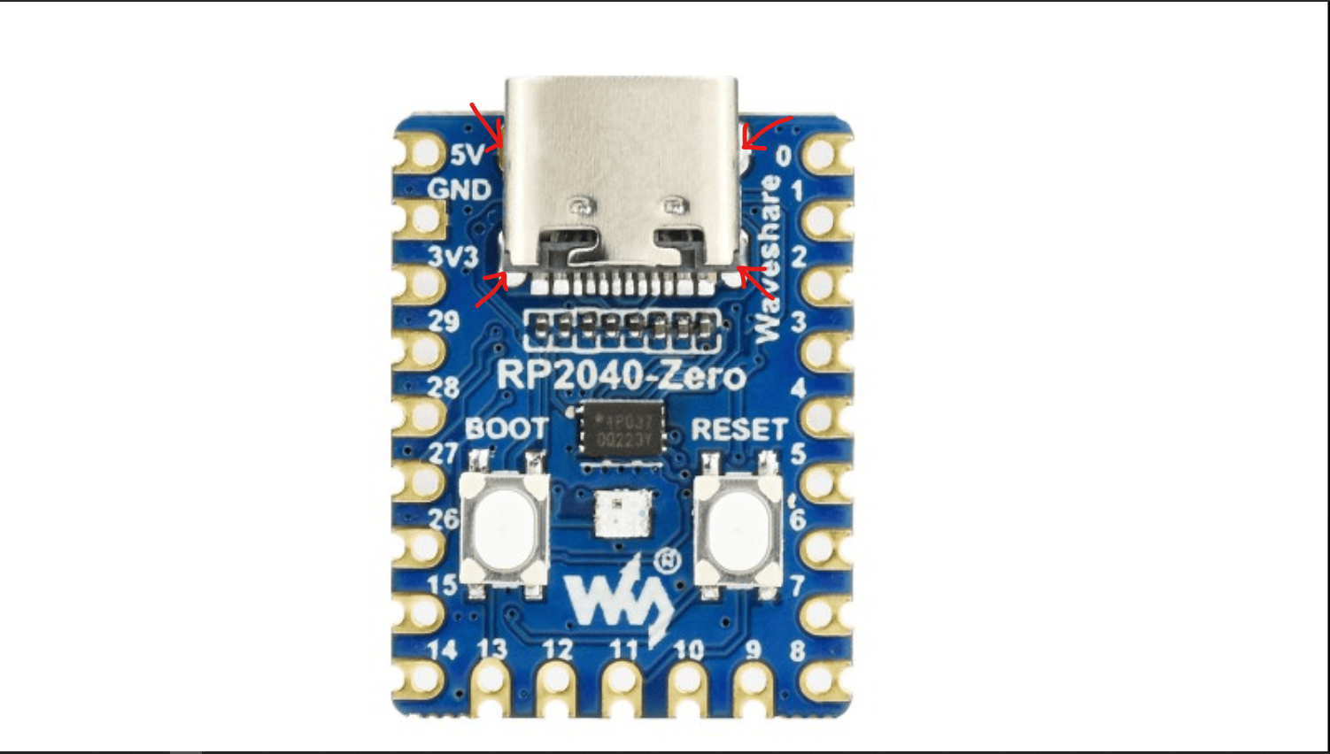

do you think solder wick can absorb the lead solder on the RP2040 zero 4 leg ?? :unsure:
im having trouble remove the leg:cry:
im planning buy solder wick...
but kinda hesitate if it doesnt work, if the wick cant absorb it

hello:creep:
sure add flux and a lot of low melt solder.......... still gonna be tough , but doable
