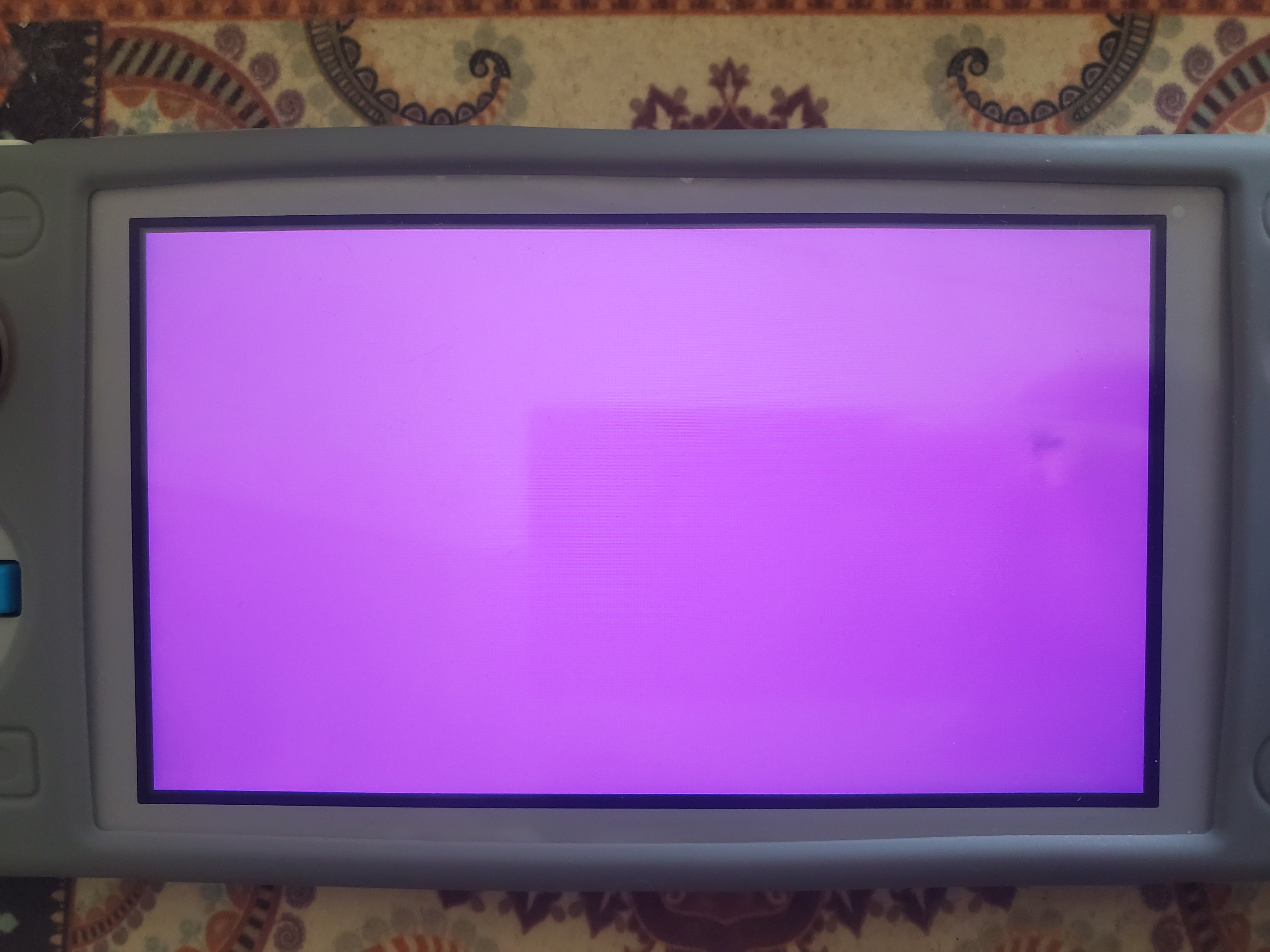

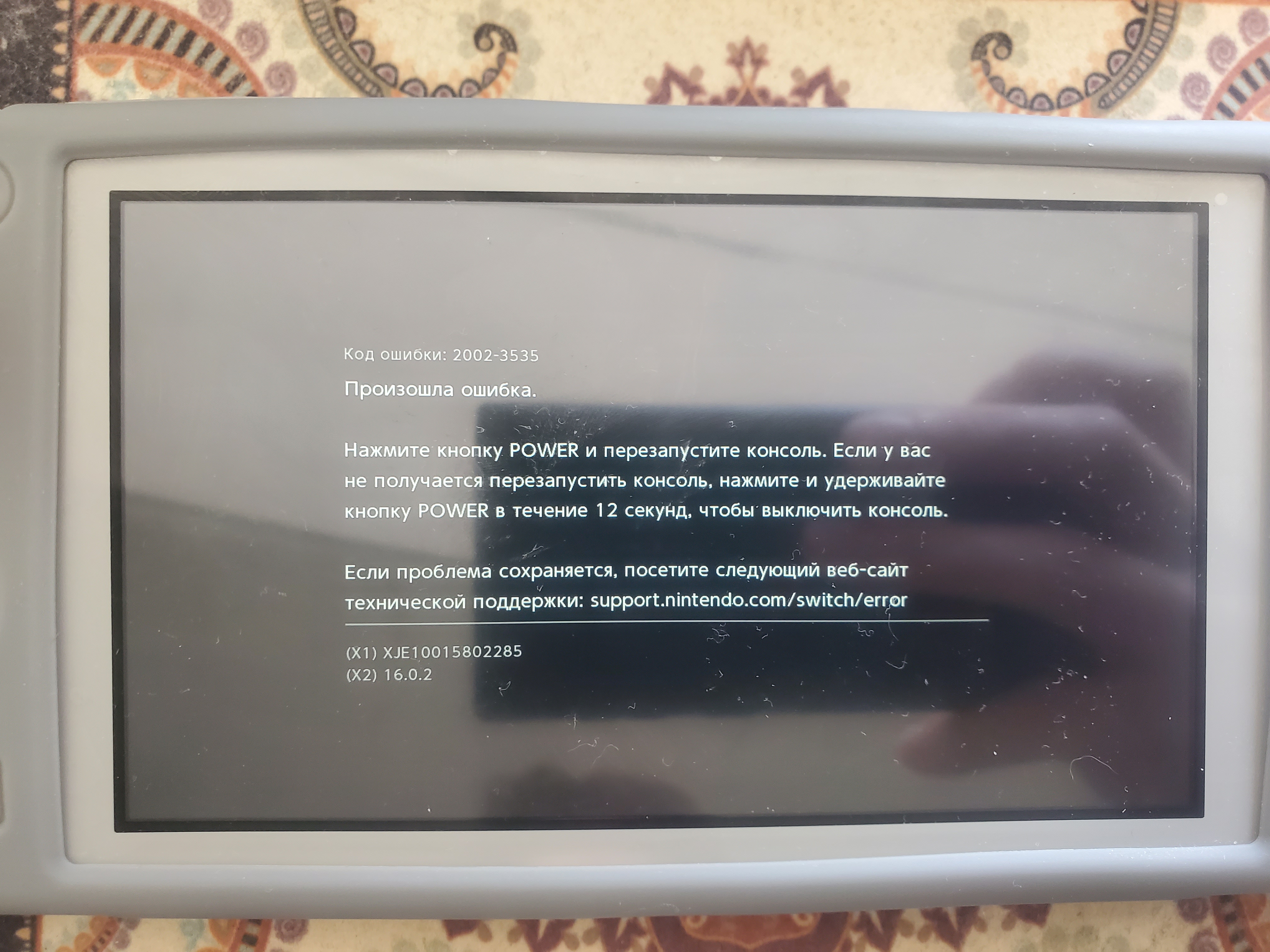

Greetings! Another problem. Yesterday my switch was working fine. Today I turn on - a purple screen. After the reboot, it was possible to start the drain, but after a couple of seconds an error occurred. Through time it is possible to get into the recovery menu, even did a reset to the factory settings. But still purple screen or error.
After another reboot i have this:
But then:
But then:
looks like wrong soldering job
