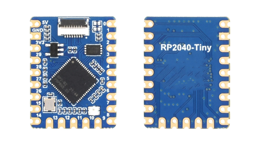

0201
Replace 470ohm with 47ohm, successful
I just want to make sure I'm understanding this correctly. You remove the 470ohm resistors from the board, bridge those 3 points with solder, and then add the 47ohm resistors to the solder joints like the regular 2040-zero chip? Are you using the 0805 size resistors?
Thanks so much for your help.
Thats what I would assume, you could also just replace them with 47ohm 0201, but they are annoyingly tiny

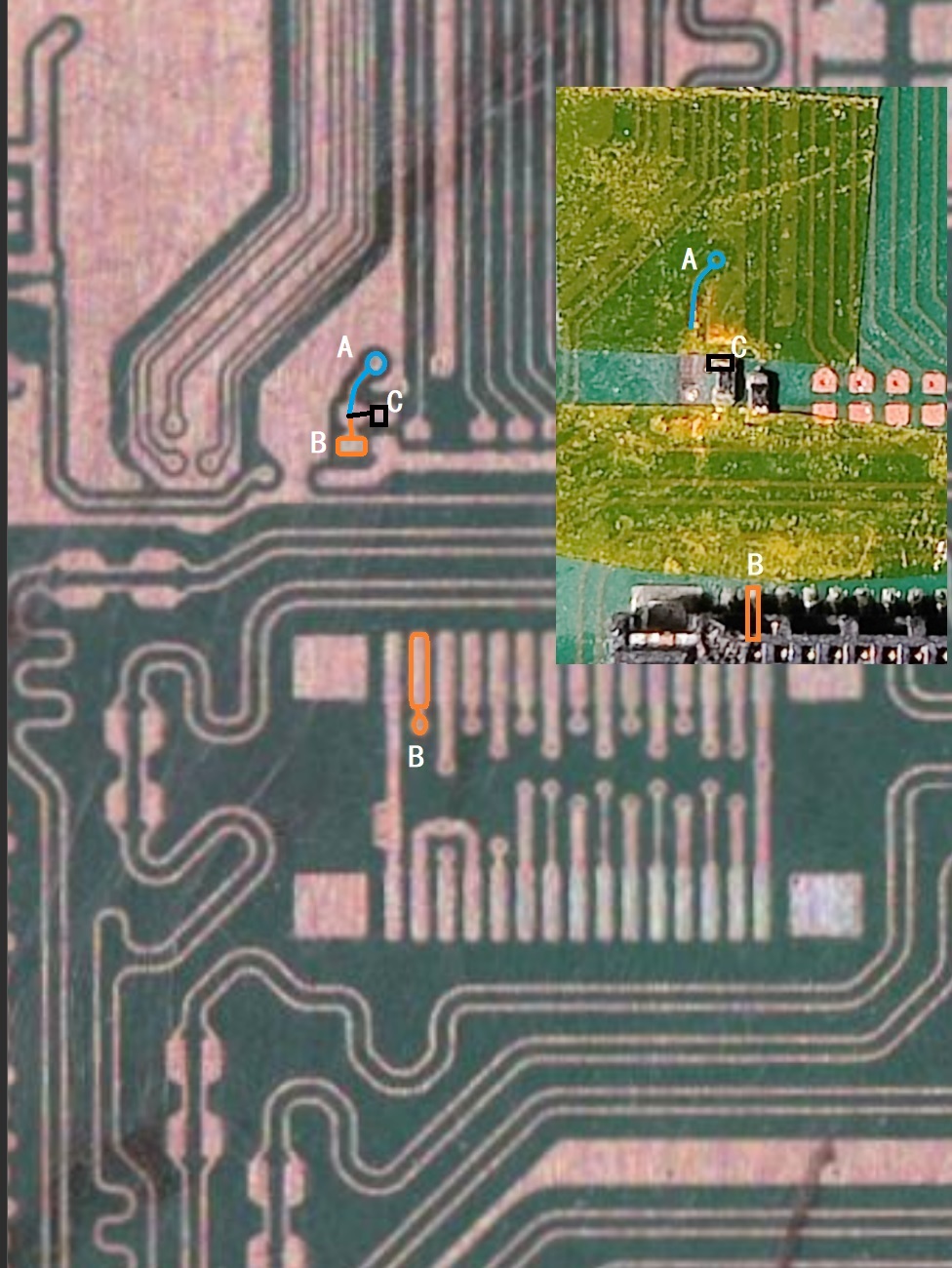

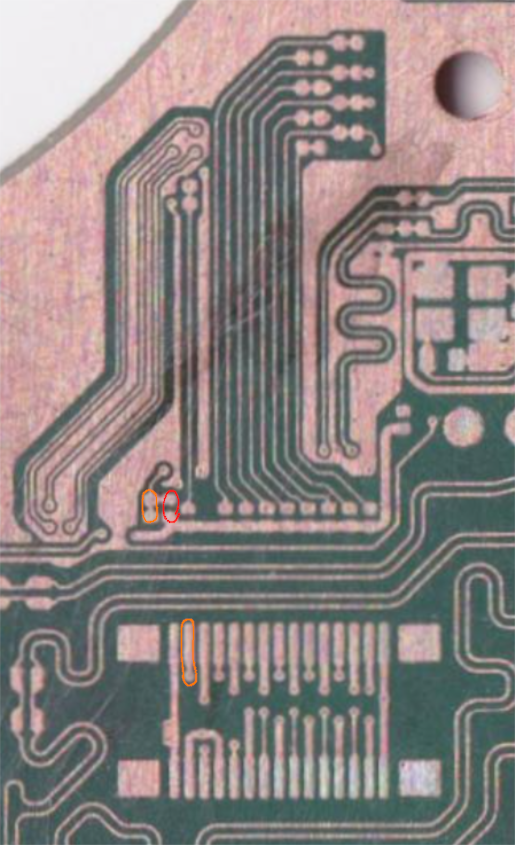

Hey, first time soldering here and I had a few questions;
I made an oopsie on the M92T36 chip and knocked off a few components and, while waiting for replacements, I decided to remove soldering points as my switch is completely dead (which I guess can also be related to 2 capacitors being knocked off around the M92T36).
But anyway, while checking for continuity, I have realized that the RST soldering point (marked in ORANGE) on a HAD-CPU-10 board is not bridging with the resistor right beside it (marked in RED) and then noticed that I accidentally scratched off the upper RST pad that bridges the two. However, while checking the lower RST pad and determining that it's still usable as a soldering point (by checking continuity between it and the second upper pin from the left of the connector), here comes my question:
Would it work to bridge the resistor and the lower RST pad with solder and am I safe from the scratched traces with just kapton tape?

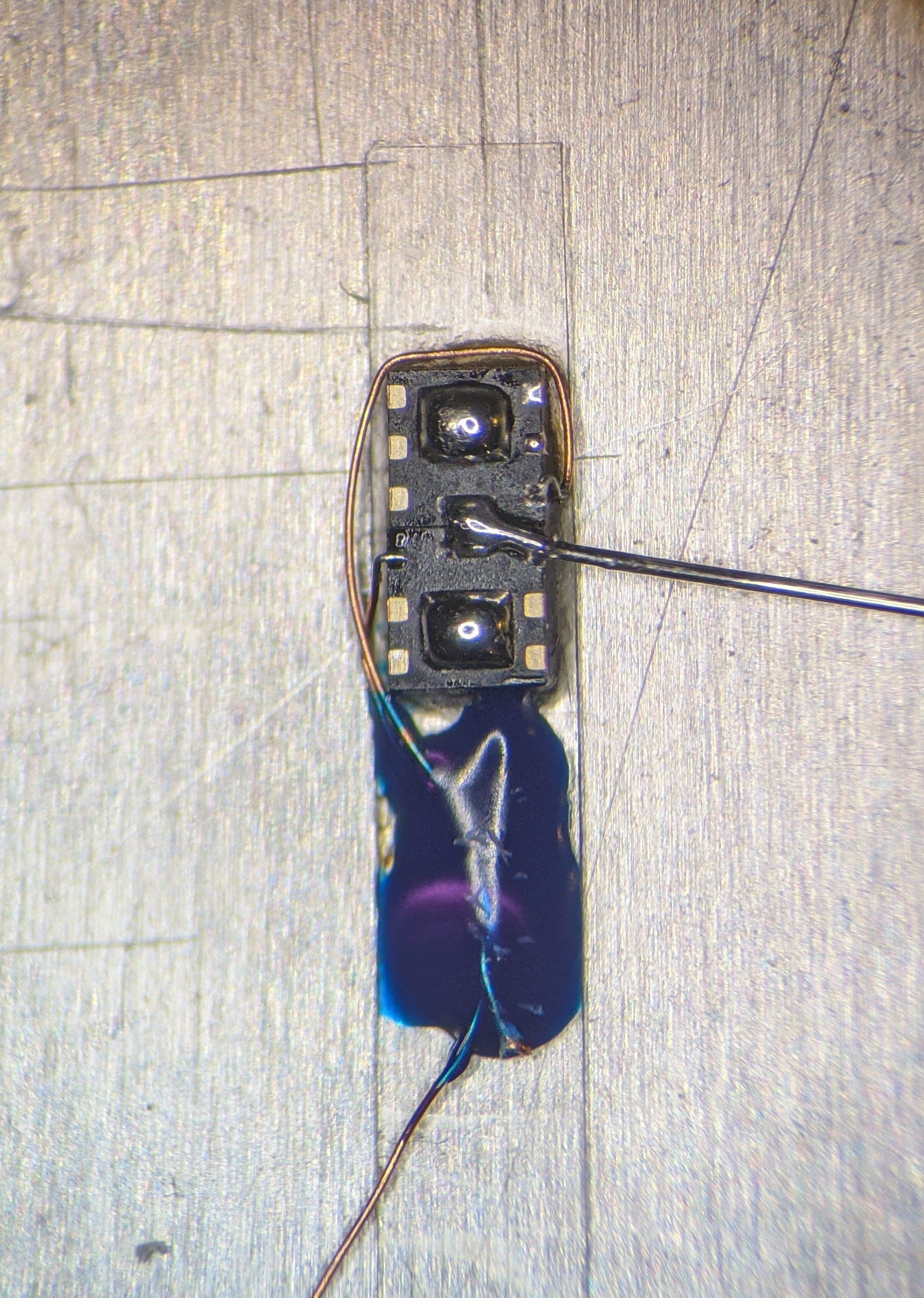

Had some time to play around with MOSFETs in order to find a way for a quicker soldering to the SoC.
  • basically, got a transparent plastic as a base on which I fixed the 2 MOSFETs with a tiny bit of superglue (from underneath). This way they won't move and make the soldering easier.
  • soldered the Source and 2 Gate wires. Afterwards bridged the 2 Gates, so there'll be only one wire that goes to the Pico and used some UV mask to isolate the soldering point.
  • now these "flying" MOSFETs can be taken by the plastic base and fixed easily nearby the SoC, and afterwards anchored well with Drain wires + more UV mask.
No science here, just a silly test that I wanted to share with you.
this looked neat, should try this next , less headache lol

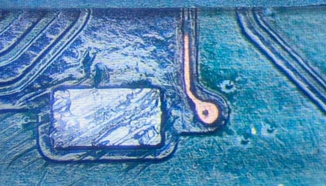

hey guys, to grind and reveal this part here on oled do we need to use mini grinder? or its possible scrape it just only using scalpel ?
You need to have A,B,C points join together no matter how.
Cant tell if you still have trace left on top of the pads where A and B used to bridge together, but I don't think any jumper would make more difficult.
good enough with just scalpel
I always use scalpel

hows RP2040 Tiny progress??
any one has attempt to success glitch ?
Yes. It seems some users are reporting you have to remove the 470ohm resistors on the board and replace them with the 47ohm. If this chip was made with the switch in mind then they accidentally used 470 instead of 47.
I'm waiting on mine so I can't confirm myself, but it seems to work with that little modification
470 means 47ohm/47R
https://kiloohm.info/smd3-resistor/470
If they use 470ohm/470R
Then the correct resistor smd should "4700"
https://kiloohm.info/smd4-resistor/4700#:~:text=Standard EIA Decade Values Table - decade 100 to 1000 Ω&text=The 4 digit SMD resistor,hundred and seventy Ohms resistance.
4700 stands for 470ohm
470 stands for 47ohm
Thank you for the answer, somehow point A totally escaped my mind of being any importance.
Would a small box cutter do to expose the trace?
