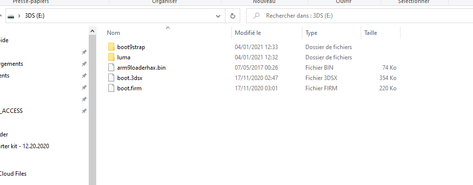

Can you post a picture of your SD card contents?

Here is the capture of my SD Card, it's basically the content described here https://3ds.hacks.guide/a9lh-to-b9s
If it's my SD Card reader that's dead, can a flashcard provide a way to recover my 3DS ?
The files look fine, make sure your 3ds is reading the SD card properly. Since it hasn't been used for a while, it may have collected dust in the SD reader and is not reading the SD card properly. Try cleaning the SD card contacts with isopropyl alcohol.

You tried with different SD cards, but have you tried with different microsd adapters? Also try using another tool to format the SD to FAT32. If the 3ds led fades in and immediately fades out, it means a9lh is properly installed but failing to read the arm9loaderhax.bin file in the SD.
(Keep in mind that a faulty microsd adapter may work fine on the pc, but not on the 3ds as it has worse IO.)

Thank you so much, it works, I jsut changed the microsd adapter ! I would never have thought of that since it was working fine on my computer ! I finaly have access to the recovery menu !
