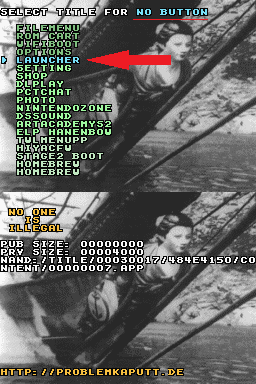

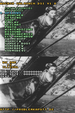

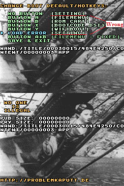

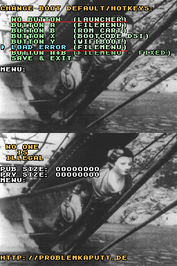

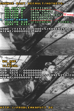

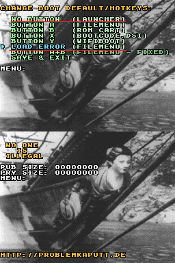

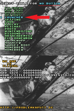

Hi guys, I messed up big time. I’ll just cut the story short and blame myself for being dumb. I no longer have the NAND back up and the memory card I used with the DSi. My DSi now defaults to the System Settings and I can’t get to the home menu even if I restart or format my DSi. I believe I used some program that makes my DSi look like the old operating system (original DS/DS Lite version) to access my games.
Is there a way to trace back my mess and fix it?
Edit: Yes I used Memory Pit
KleinesSinchen
GBAtemp's Backup Reminder + Fearless Testing Sina
GBAtemp Patron
Mar 28, 2018
4,443
14,901
Germany

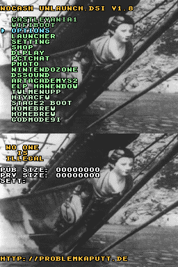

Hold (A)+(B) when turning on the DSi. Hopefully unlaunch Filemenu starts. Set a new default option for "No button" and "Load Error"
I will add some screenshots in a few minutes to this post. Done!

To get HiyaCFW and/or TWiLight Menu++ running again refer to https://dsi.cfw.guide/
View attachment 186581 View attachment 186582 View attachment 186583 View attachment 186584
Thank you so much! It worked, I almost lost hope and it's been like that for months! :)
Although now the music and sound on the home menu is gone, but games and apps, and setting have their sounds/music. It puzzles me what could have caused them to disappear
