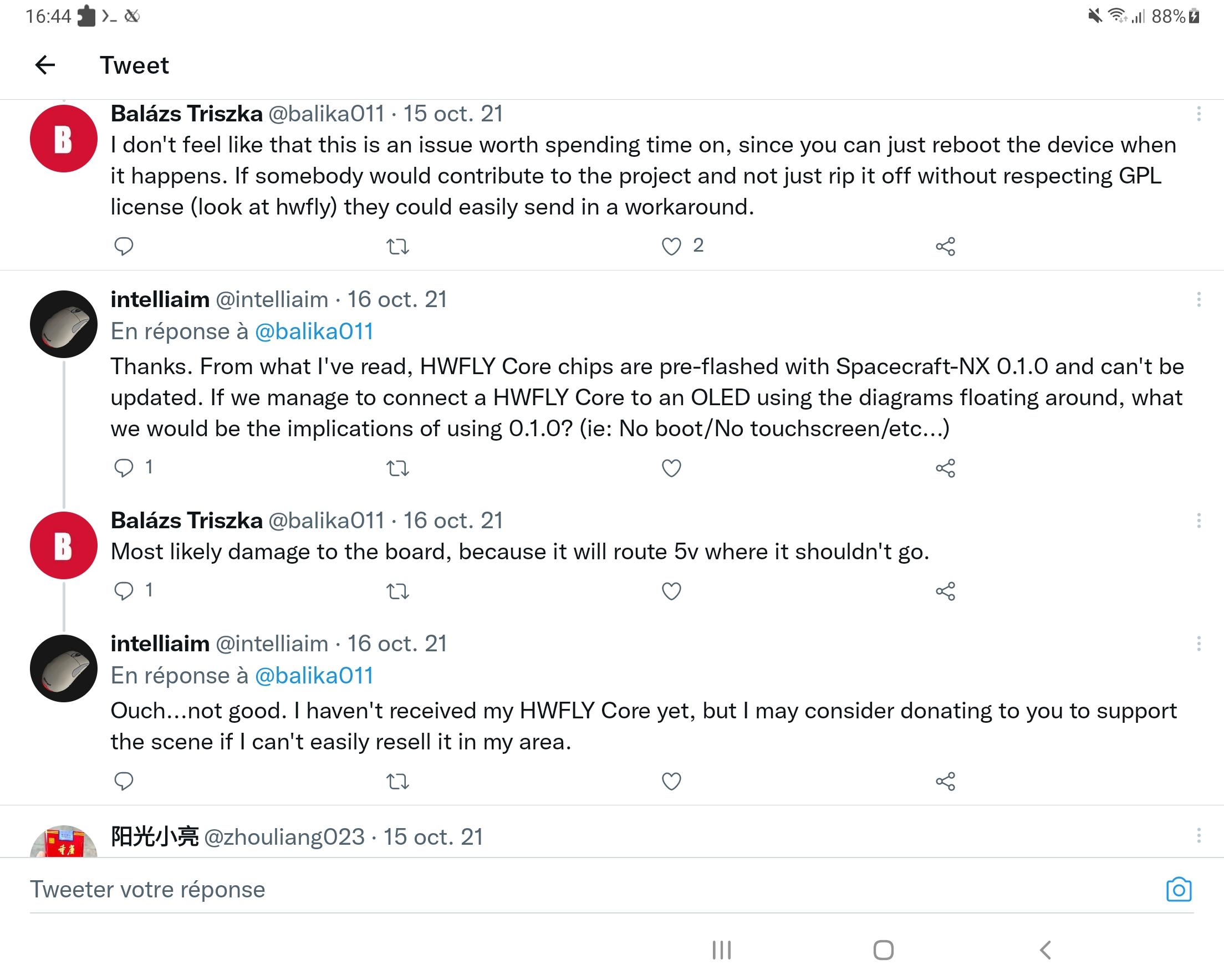

I should change my wording honestly, I can't say it *will* kill your oled but it most certainly can cause damage. Hell, even the creator of Spacecraft said this but it didn't really gain any traction. Now that people are actively doing this mod I've seen issues come up.View attachment 292755
I am honored to have my Twitter post quoted :) (that's me intelliaim)

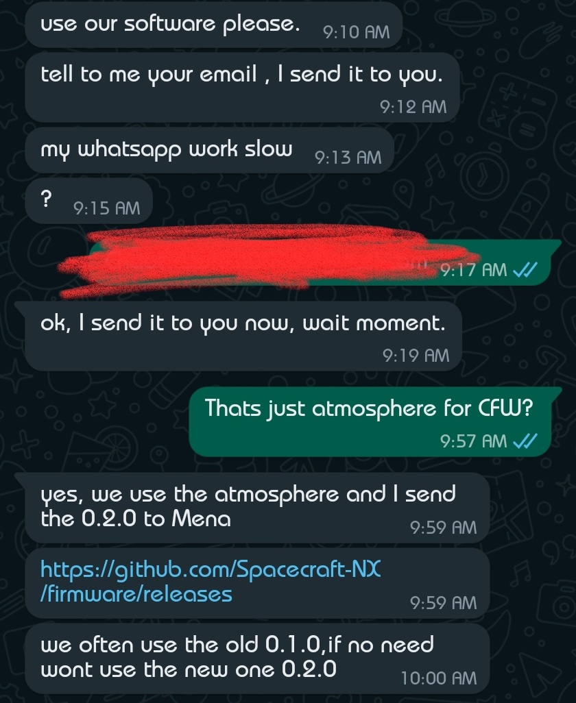

The spacecraft firmware comes with a factory encryption program, don't try to decipher it, it will cause problems with your console and chip.
We guarantee that all hwfly chips are compatible with the latest consoles and there are no issues.
The firmware release is also more than 2 months old and there is no evidence that it will break the console, this is a mature product.
Is this account even legit?
It's so sad you'll defend a batch of dangerous products just because you want to sell them.
Instead, accept the fact you need to allow flashing and start using the new version of spacecraft asap, or no one will be buying from you at all ever again.
