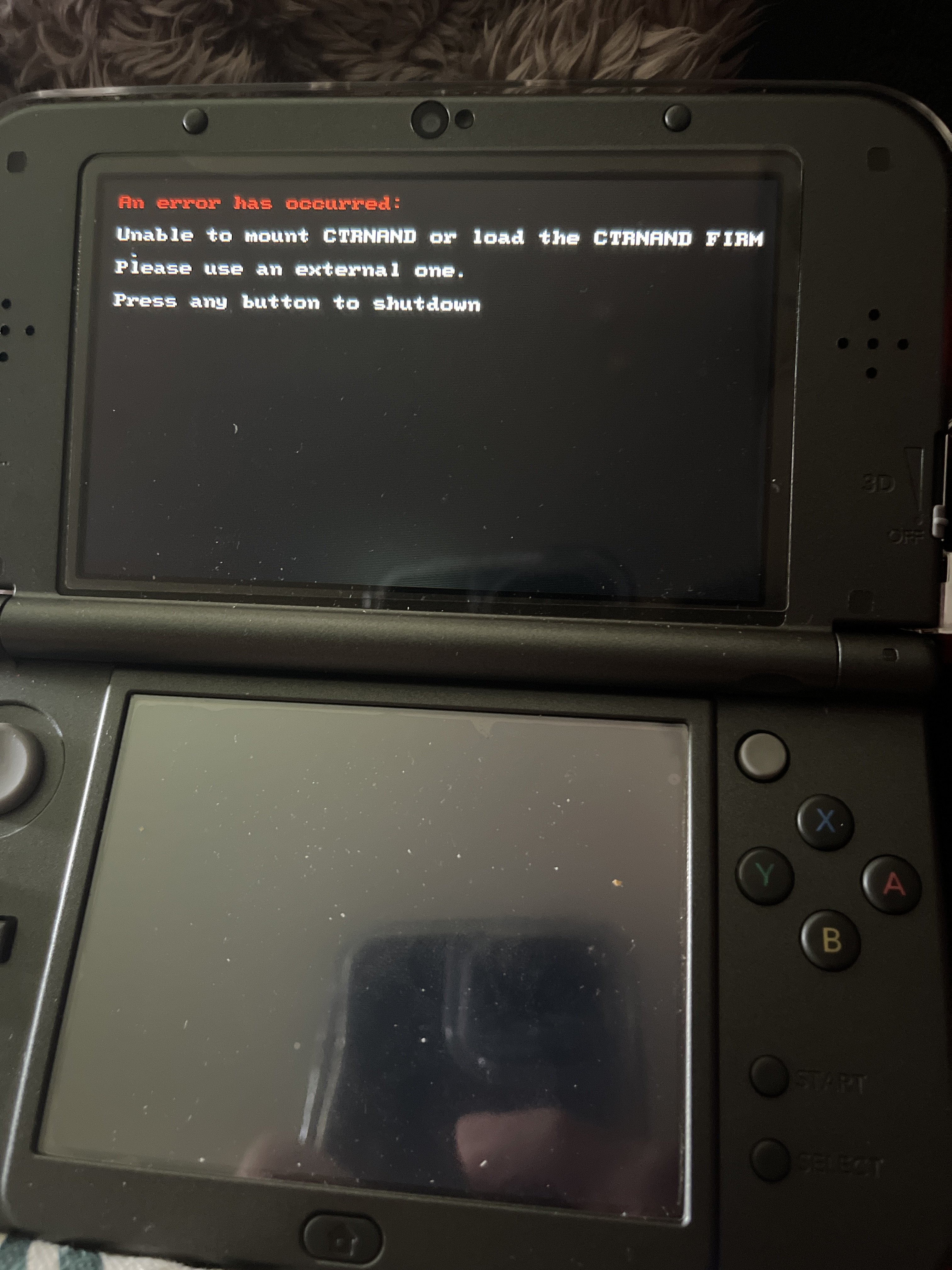

Hello I have a new 3ds xl that my brother tried to mod back in 2017 or 2018 anyways he didn’t do it correctly lost all forms of back up and now all it does is boot up and say “An error has occurred: Failed to mount CTRNAND press any button to shutdown”. This is old version of hourglass 9 it is v1.35 so any videos or posts aren’t really the same so they are difficult to follow. Does anyone know if it is possible to unbrick? I’ve attached pictures of what screens of what happens when I turn it on while pressing start and while pressing select. Any help would be very appreciated

This :> (step 24)"Update your device by going to System Settings, then “Other Settings”, then going all the way to the right and using “System Update”"
When you rebooted the system (step 23) the error showed up? You didn't go to the home menu at all, right?
Sorry, i meant holding "select". Post a pic here.

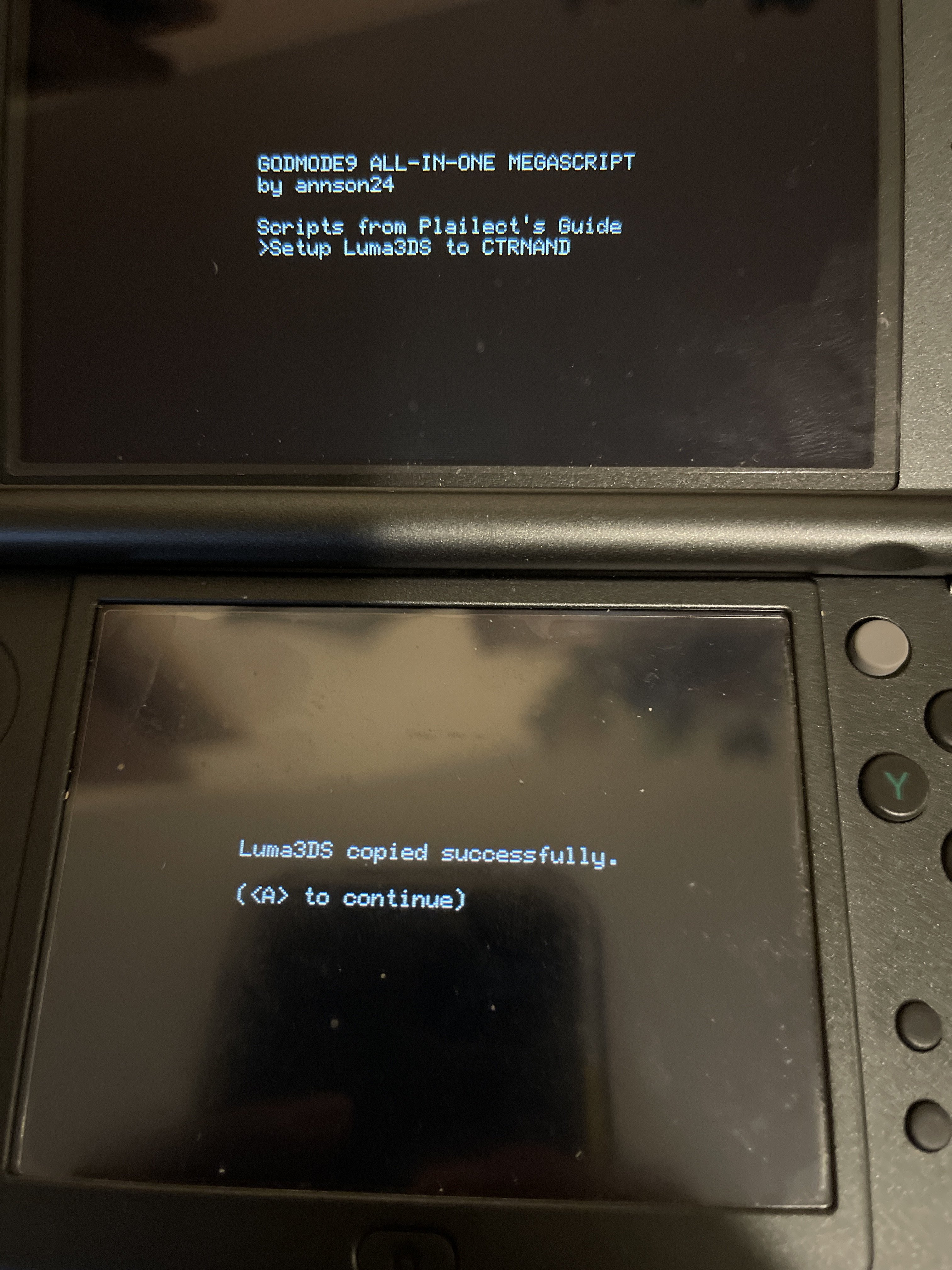

Also do the section vi "Luma3DS ctrnand" above.
Yes that is correct I did not get to home menu

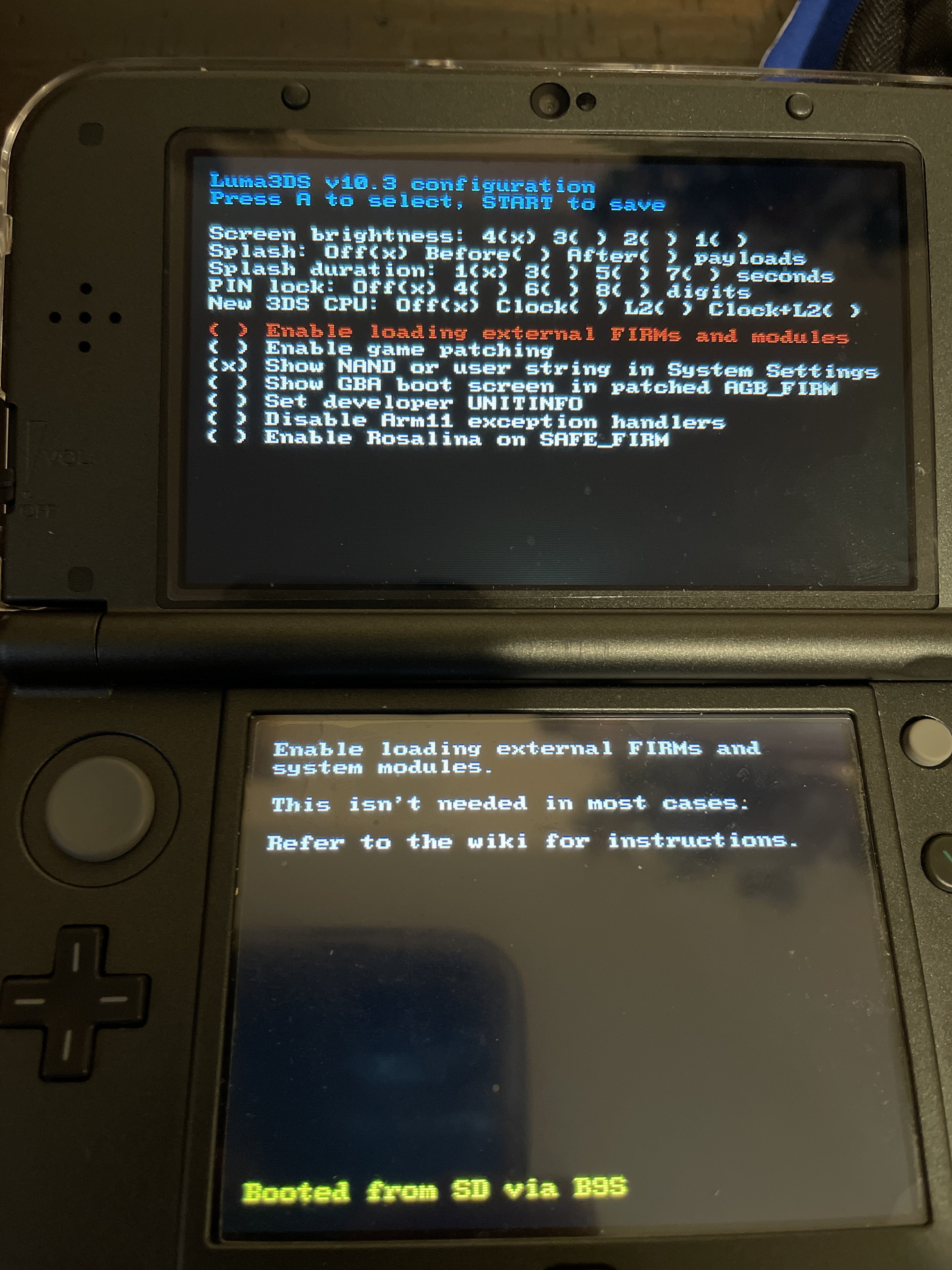

Yes I did not get to step 24 right after I pressed start to reboot on step 23 it displayed the error message. Also here is picture when I hold select and power on

What do you mean you can't boot? It gives the same error?
And what about that pic i told you to take of the Luma3DS menu, when booted without the sd card?
What do you mean by this ?
He's asking if you did set up Luma3DS ctrnand. The steps that i told you to take above..
