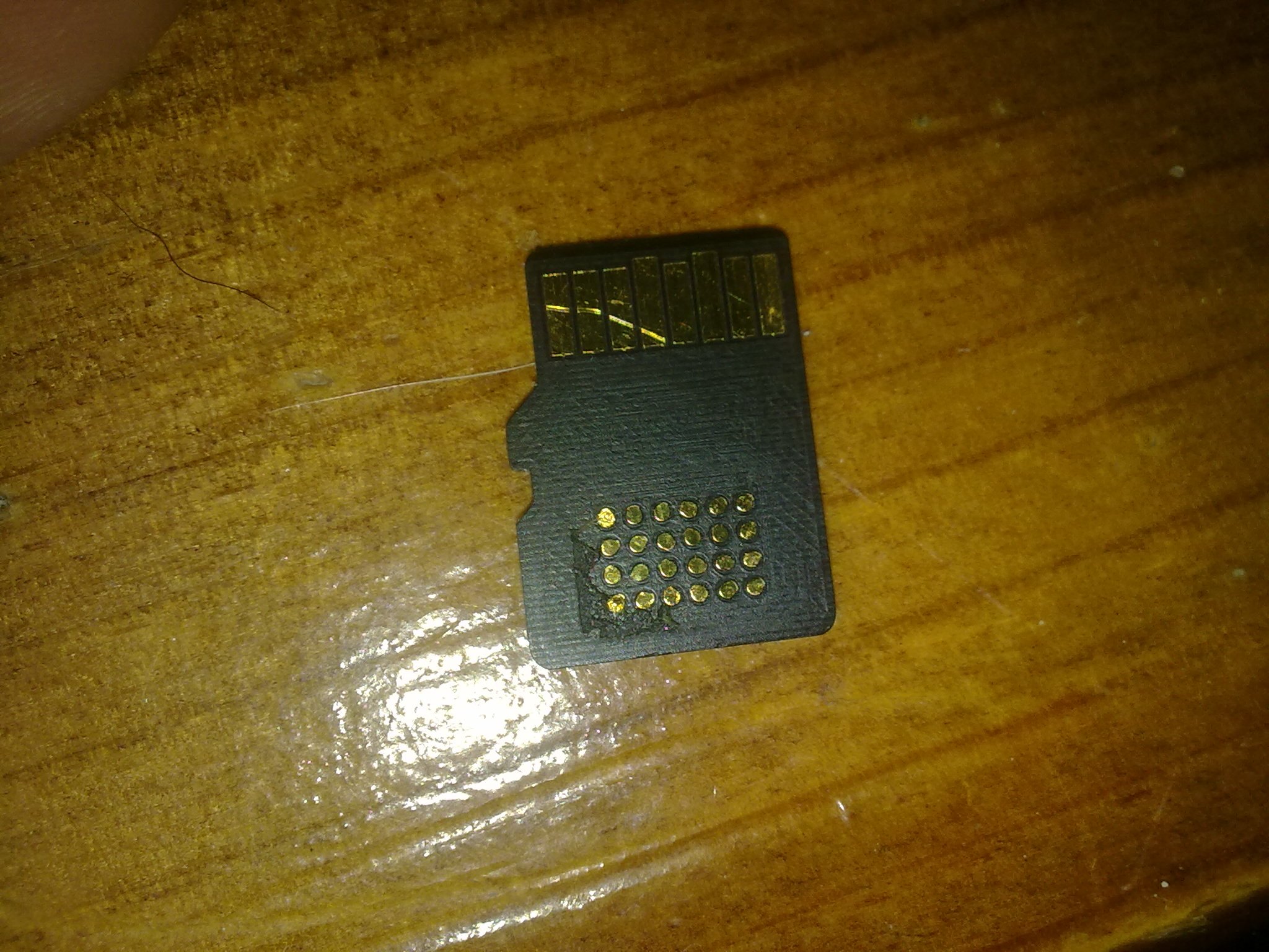

picture is anexed, i found this micro sd card had a sticker and i removed it, and underneat the sticker was this pins forming a square
it was used for testing, programming, wiping, assembly? i am curious about them...
i own another 2 micro sd cards and they don't have this sticker or pins, its just plain plastic, also this card is old and its deffective... can't format, every card reader i own is unable to read\write on it..

These are the points were they are manufactured with. Some more expensive cards shield these points under the case. Cheaper cards use a sticker. I have no clue if you can actually read or write trough these connections.
Does the card still show up?

I think their programmer points to program the microcontroller.
Seeing it's under a sticker, the card most likely got reprogrammed once by some shifty chinese reseller that upped the capacity to 16 GB from its original 2 GB.
Ofcouse the latter might not be true, so take it with a grain of salt.
Personally, I'd bin it.

hey dinoh! the card is a 2gb sd, it never worked fine, it was bought with a phone and the phone sometimes i could save stuff on it, other times it didn't, at the time we didn't cared about is warranty, then we forgot about this card and now its better to forget it, i was curious about the pins since no other micro sd card i have had theese...
i don't have a normal micro sd reader right now, but on most devices it shows up, but it makes the mobiles hang or freeze, in the weird reader i have on my computer (using a 3g pen as a reader) the windows explorer gets stuck on "loading" the my computer page...

Well it could be a legit card (reporting its true 2GB capacity) but you'll never know.
Since it never worked properly, I think that it's just a cheap card which had a lot of problems with its flash chip.
If you're worried about your other cards, run h2testw on it.
It'll fill your microSD with data and until it can't fill anymore (even beyond it's reported capacity)
It's a great tool to find out if your flashchip is in a good working order or if you got a genuine or fake card.

See "bed of nails tester"
Also see
Shorter version of the above (though if you aspire to one day call yourself a hacker I would suggest watching that video, twice)
SD cards contain onboard processors that are often actually full processors with real instruction sets (ARM stuff like mentioned in that video is what powers android, the GBA, the DS, the 3ds and various iDevices).They also contain controllers to help sort out dead sectors and a lot other other things that a SD card might need to sort out. As such initial programming and maybe post failure analysis is a nice thing to have.

FAST6191 I was aware about HDD had a firmware\system for sorting damaged sectors and remaping them, i read some stuff before which i learned that when you bought an old HDD you had a sticker with the dead sectors wich you had to manually input on the computer
i didn't know sd cards was pretty much the same, and i couldn't imagine having a chip on it besides the memory transistors, its so tiny...

My genuine 64GB SDXC Sandisk bought locally at a major retailer last week has such a sticker, as does my very old 1GB Kingston. My 4GB SDHC Sandisk has no such thing, though.
