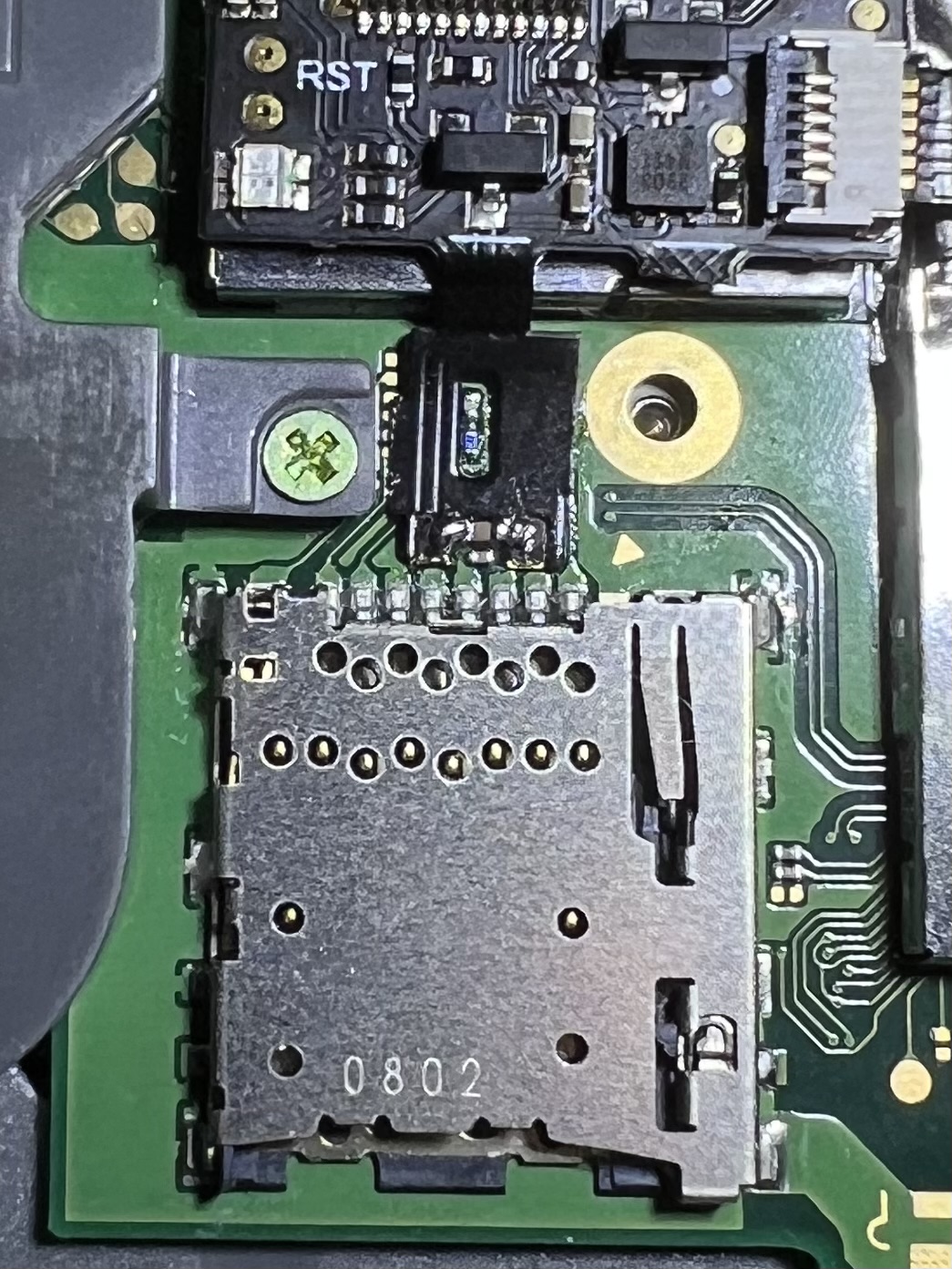

What is this blue smd? I am comparing diode values between another working board and I am not getting any value at this component. I am getting 0v instead of 0.57v.
Did you manage to solve the issue? I have the same problem and I‘m not sure if I should solder a new SD reader on the board or just buy a new board.
Btw, the blue component with the white dot (above the SD reader) is shorted for me as well.

I also checked another Switch Lite board for comparison and on there the blue component is also shorted. How do you measure to get .57v ?
I also check the connection of all the 8 pins from the SD slot and they seem to be perfectly working. My switch has some other type of the SD slot where the pins are accessible from outside, so I’m able to check them.
My guess is that the 9th connector, which is supposed to be grounded once the SD card is inserted somehow isn’t working as intended and/or that something inside my SD slot is messing with this pin. And since I can’t figure out anything else, I think I‘m going to replace the slot and hope for the best.
