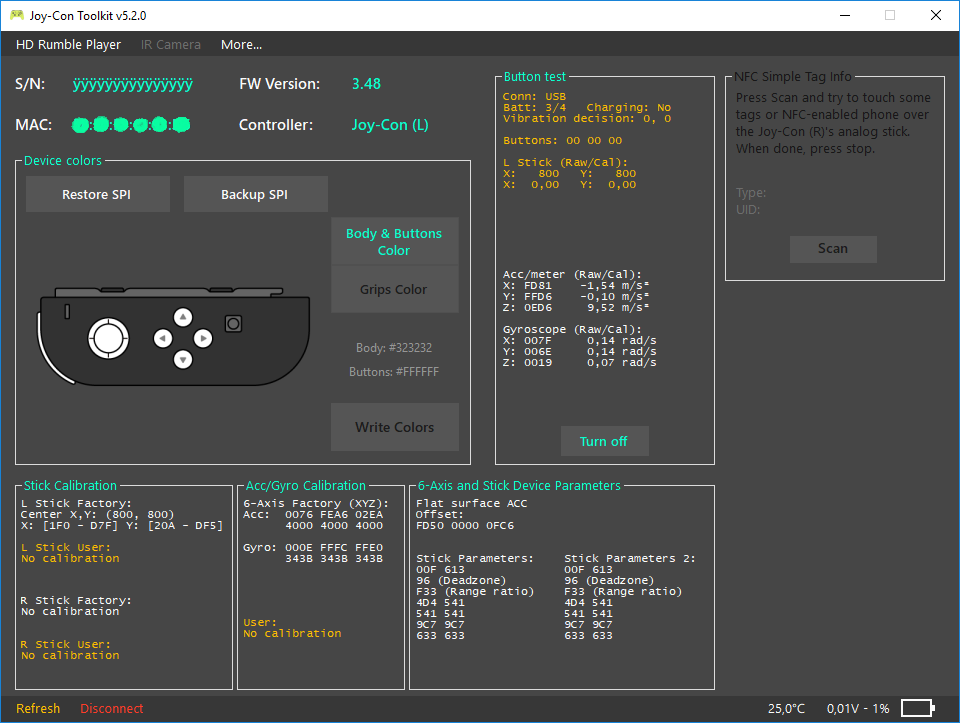

I bought one of the black V1.3 controllers to use with the PC. It's a pretty solid controller considering the price. However I have two issues remaining: First the y-axis of both analogue sticks is inverted and second the current battery level is unknown.
Both issues probably could be fixed with JoyCon Toolkit, changing the analogue calibration values and reading out the battery level. However the controller is not correctly recognized, see attachment.
Could anybody try and see what JoyCon Toolkit says for their controller? Does anybody know how to upgrade the firmware of these fake controllers?

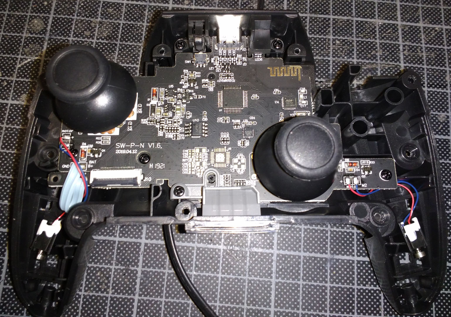

1.6 version here, I got problems with the analog sticks. They reach the limit in the calibration program on the Switch long before the sticks touch the plastic of the controller.
Anyone else got similar problems?
The Inverter a is is normal for the Pro controller on pc.
I only knew that the original controller has the problem to.
But the games change that when using with it.
IT can change in the steam controller settings for steam games.
The Tool kit? I think it doesnt work with the fake controller Because it has a other Firmware Then the original.

1.6 version here, I got problems with the analog sticks. They reach the limit in the calibration program on the Switch long before the sticks touch the plastic of the controller.View attachment 176060
If you are using it with a computer, the easiest fix is to use a middleware. I'm using XOutput to map the fake controller to a virtual XInput controller. This solves the y-axes inversion issue and drastically improves usability and compatibility.
If you are using the controller with a switch, you could try JoyCon Toolkit and change the axes calibration values. However apparently none of the fake controllers work with JoyCon Toolkit. I can't even store the SPI.
That's why I want to upgrade the fake controllers with its own firmware. In the manual it says "How to upgrade your switch controller? ... We will also provide upgrading programmes." So surely this software must exist.
Do all of your fake controllers report the same thing in JoyCon Toolkit? Also did you notice any difference between V1.3 and V1.8?
I would love to get my hands on the schematic of V1.3 to find out what the two unmounted ICs in the middle are supposed to be. Maybe we could easily upgrade the controller by soldering a NFC chip.

Ähm the problem with Inverter a is is only a PC problem that the legit has too.
On switch is All correct.
On steam games you can change it in the steam options.
On other games There are ways too.
Like i say it is a PC only problem.
Why should i Use joycon toolkit when the device works?

Well could anyone please check the analog range with the China controllers on their Switch please. Basically what I want to know is if your analog stick reaches the maximum in the calibration menu on the Switch before it physically reaches the plastic ring of the controller shell. And if yes by how much.
Because if that's normal for all China controller, fine. But if it's just my controller then I'm gonna try to return it.

Checked against two original controllers, even the nintendo ones have slight variants but the Chinese are in my case pretty close. I have one with slightly wider range than the original and 3 that seem about the same as Nintendo.
Your controller might be a bit faulty.
